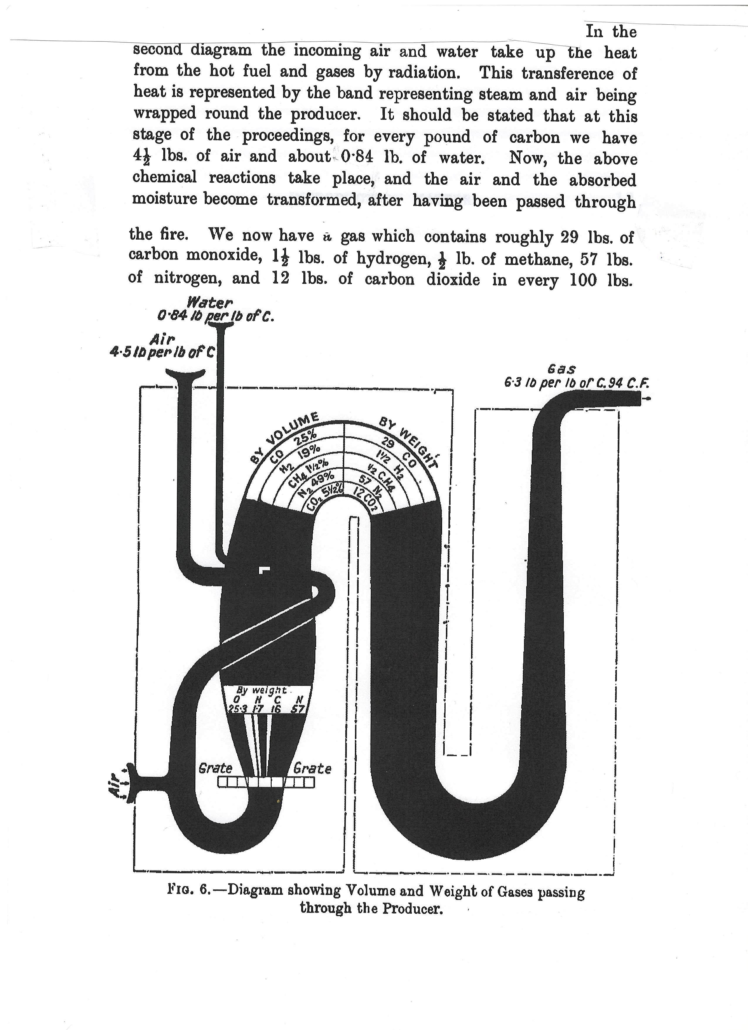

https://www.forgottenbooks.com/en/download/SuctionGasPlants
