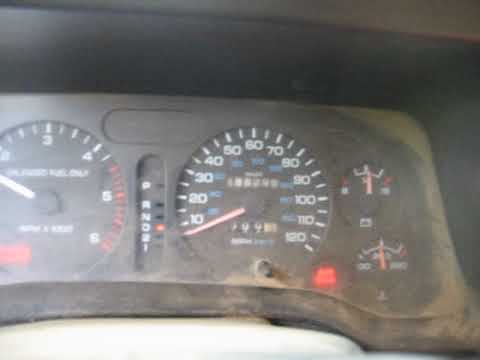

Did your speedometer quit working?
Hello Don.
The tachometer , odometer and the trip meter works OK but the speedometer went out about a year ago .
Better on the V-10 than the Dakota for speeding tickets!
