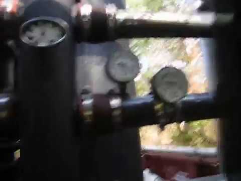

The gauge on the right ( drivers side ) is a 0-60 water inch, connected to the hay filter on the motor side of the hay .
The gauge in the center is a 0-30 that reads the vacuum at the cooling rails .
The gauge on the left is a BBQ thermometer .

I’m a little confused here. With your above statements in mind and watching the guages I notice a close to 2:1 ratio pressure drop across hay filter and rails. I never connected a guage to the motor side of the filter but always considered it almost zero restrictive. I find it hard to belive half the vacuum is lost there. Am I missing something?

The 2:1 ratio is beginning to show the hay filter should be changed or cleaned but with this 8L motor pulling the gasifier I think 1 1/2 : 1 ratio is about normal on this gasifier .
Keep in mind even with this high ratio I can easily over pull and over heat the gasifier .
Thank you a lot for the clarification.
Thanks Wayne.That about how my gauges read from building my gasifier from your book, HAVE WOOD WILL TRAVEL. NOW I will hook a vac gage between hay filter and the motor too tell when filter is pluging. I thought we were the only ones getting snow.thats about all the snow we have way up here in Michigan. I will trade your winter for are summers any day.
