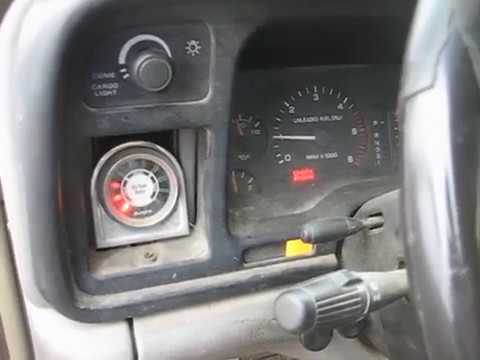

I like the sound of your v10 exoust, is that a muffler or heat exchanger turned in too the muffler, I have a turbo muffler sounds about that lould, and yes the grass and no snow is green,er side.And your v10 must be idleing about 500 RPM in the vidio on h,co gas.
Hello Kevin .
The ole truck does have a muffler but it also leaks some exhaust. I don’t want to fix it because I like to be able to hear the motor in a woodgas vehicle .
How low will it go ?
Good evening Wayne keith i been wondering how low your v10 would idle. My next vehicle will have a tack and port fuel injection, and hopefully will be able too clean burn out the intake with out pulling intake for cleaning. You poor folks been sure getting slushed with rain last season and this winter.Good thing you got wood powered vehicles too hit the AC or heater for the little cold season. Hopefully it will be a normal summer or a bit more sunny and reg rain timeing, lot of years up here in michigan seems the rain hits in the spring well but not much rain the rest of the growing season barely.
