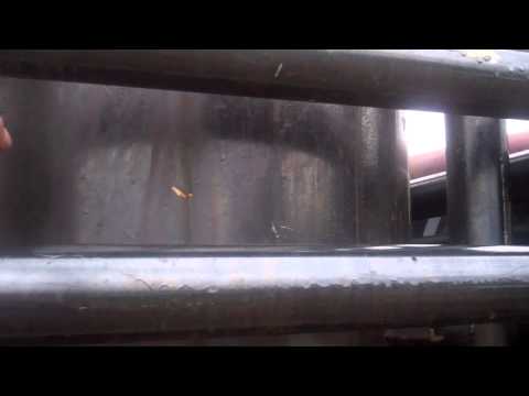

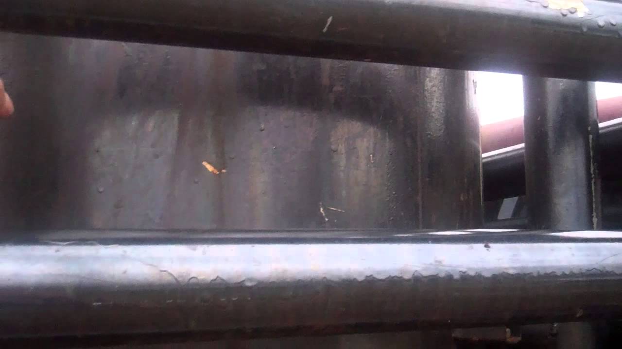

Turns out that on a seasoned Keith gasifier, the lower drum will stay at ambient temperature even after hours of driving. The lower housing was cool enough to hold your hand on indefinitely. We drove around for about 90 minutes, feeding cows and picking up Tally from school.

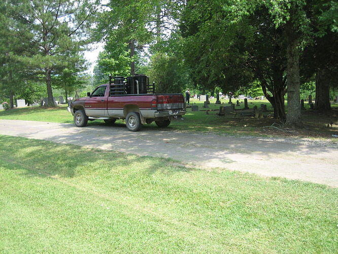

The family and I attended an event last night. We arrived burning wood and left burning wood but no one noticed.
V-10 parked in the background

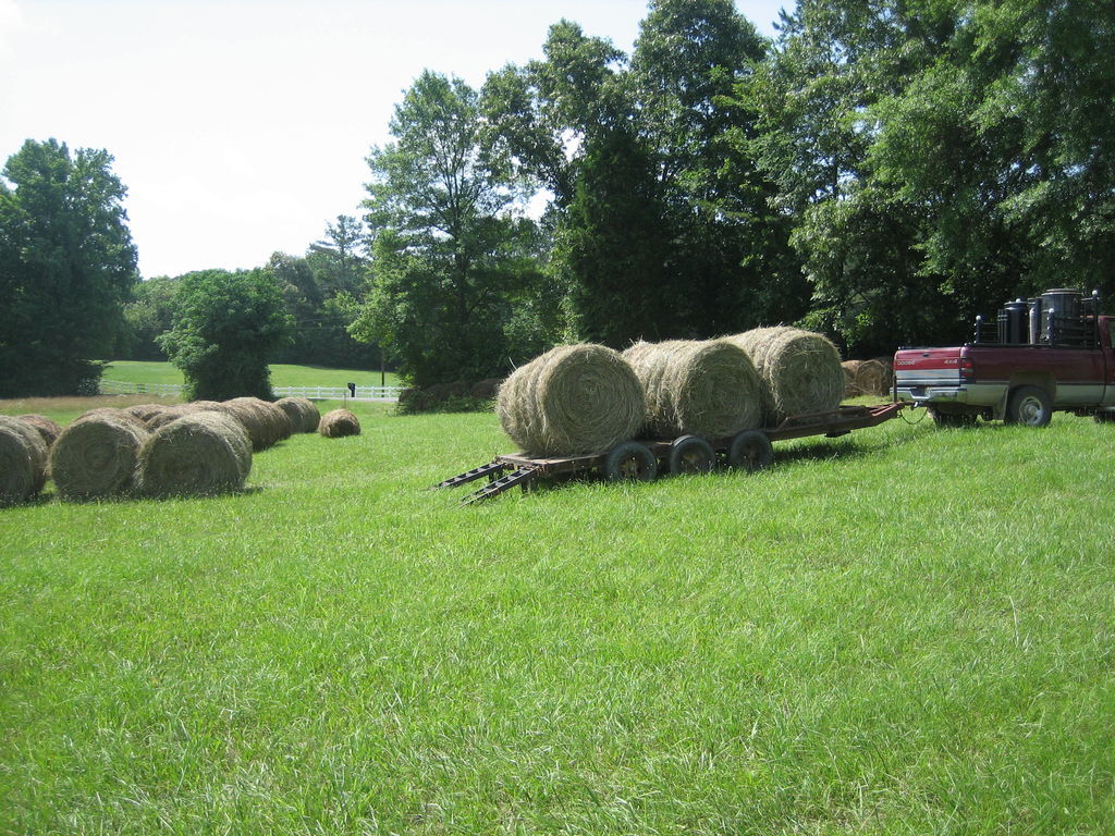

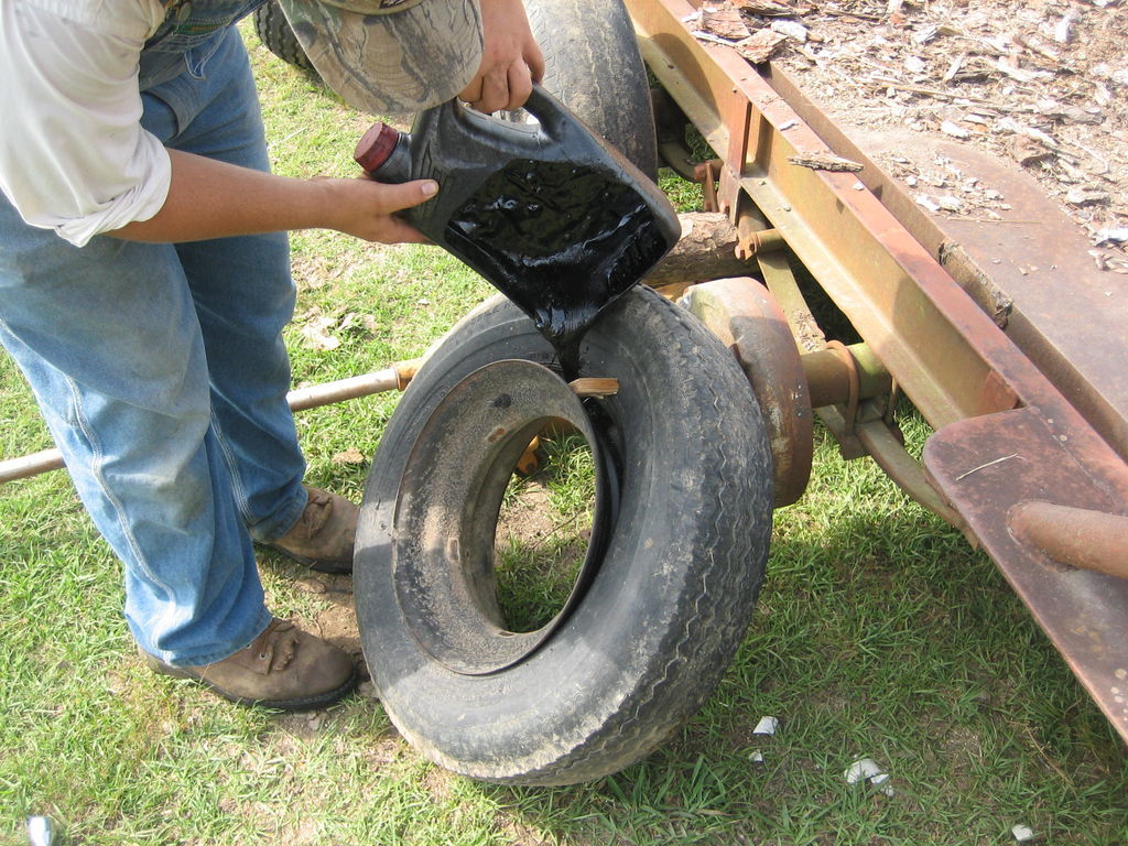

The son and I were cutting hay today. One picture below shows hauling equipment and the other picture shows putting a stop to leaking tires with the gasifier tar.
Watch those 14.5 mobile home rims. They come in two gages of steel. We were hauling heavy equipment on a trailer with the light gage and the rims would crack and leak; and then because we had multiple tires on the trailer, the tire got ruined by running flat. That is a good idea to use that gunk to seal the tire, but I’d hate to be the next guy to change the tire.

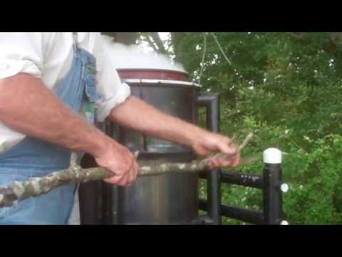

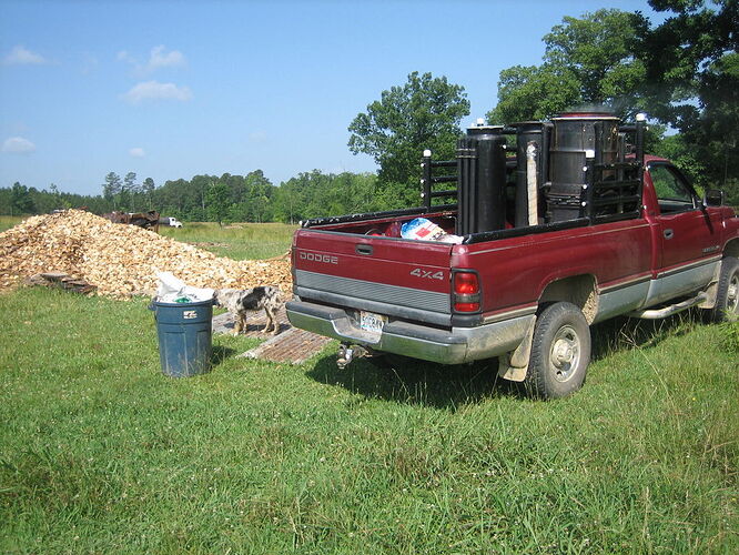

While out working it’s real nice to be able to pull under a shade tree and fuel up.
I guess this is short cutting the oil drilling, refining, transportation, storage etc.
No cash or credit card required

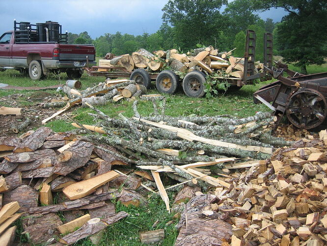

It has been a few days without rain so I was able to fuel the V-10 from the outside wood pile.
I pick my son up from football practice and on to the hay fields where we hauled a few loads of hay. Son drove the V-10 while I used the tractor. Not a drop of gasoline was used from the time I left the house until we shut down for dinner.
