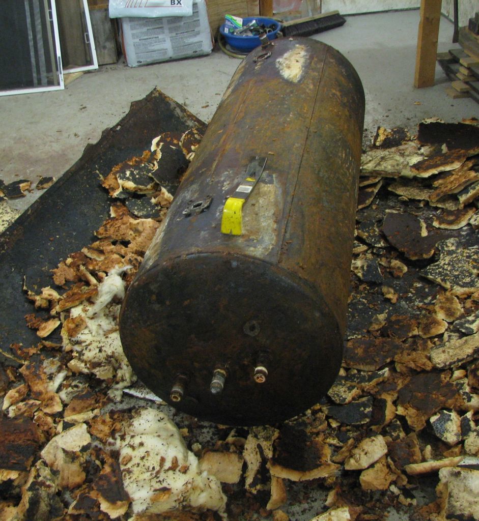

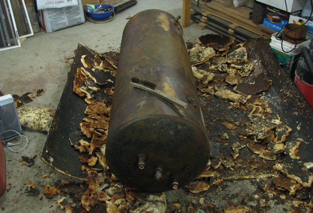

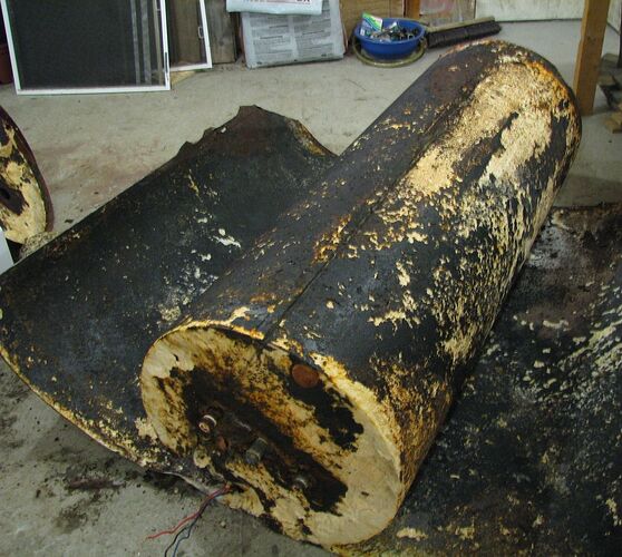

Hi Gary, Thought I’d chime in with my power by armstrong removal procedure. I started by cutting the shell open and laying it flat. The flat bar is a good removal tool. I wire brushed the fines off. It took about a half hour or so and was easy to pick up and pack into a large leaf bag.
