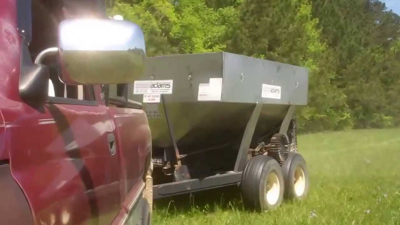

This is the truck I use for the farm. I use it just about every day.

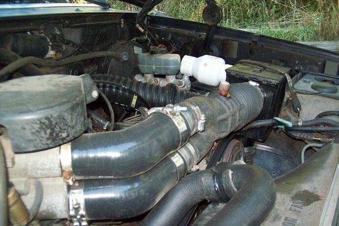

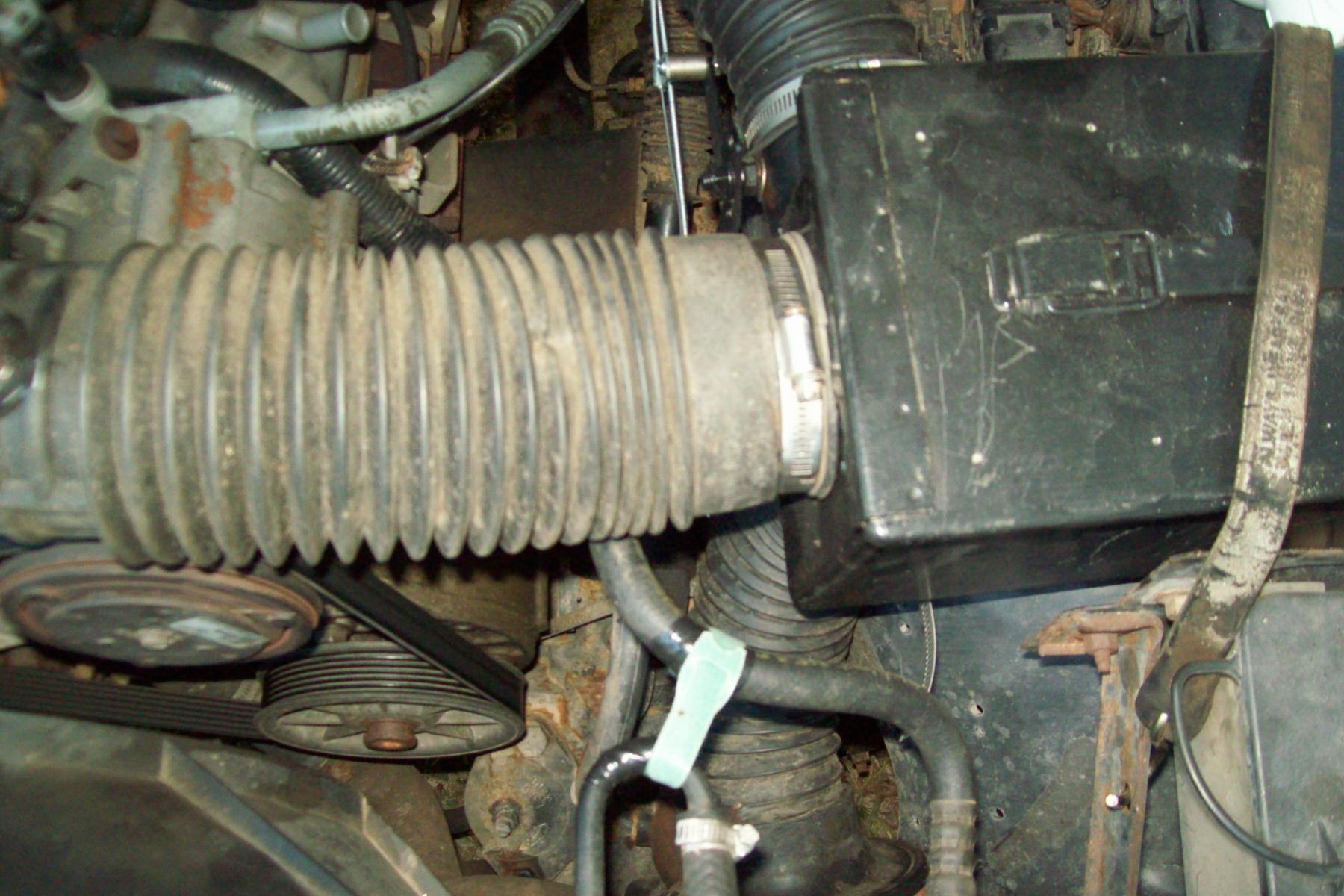

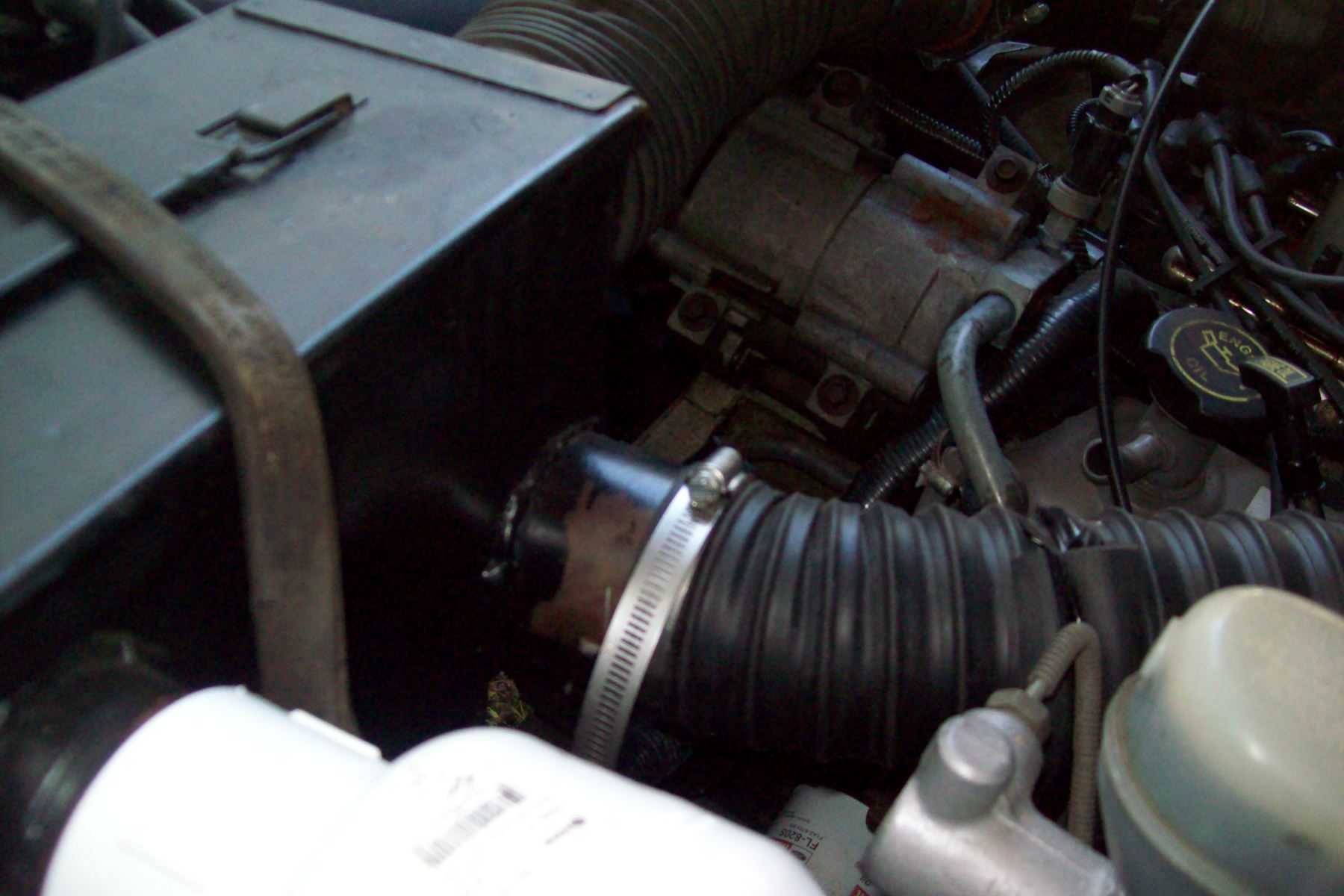

Do you have a setup on a Ford that you could put pictures of it?
This is my Ranger I drive now. I will try to find pictures of the 93 f-150 5.8 I did 5 or 6 years ago https://forum.driveonwood.com/t/wood-gas-a-98-ranger-questions/3334/83
