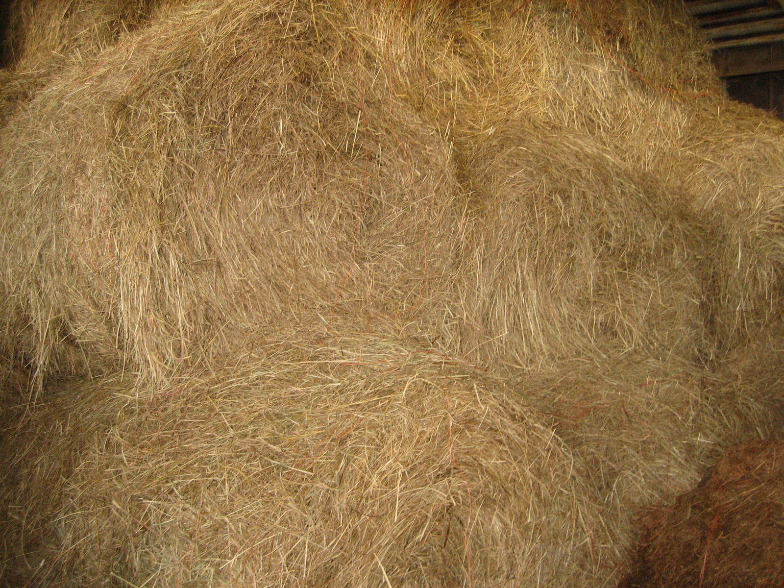

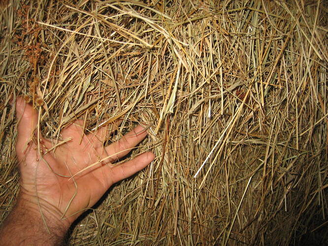

Ok good, My original question was two fold. For right now, what kind of hay or straw? Wayne has always said course stringy hay. Oddly enough the craigslist postings don’t offer course stringy hay. So I wondered What kind of straw or hay is course and stringy. Oat Straw or wheat straw or something else? What kind of hay is course and stringy, alfalfa, timothy, grass hay?

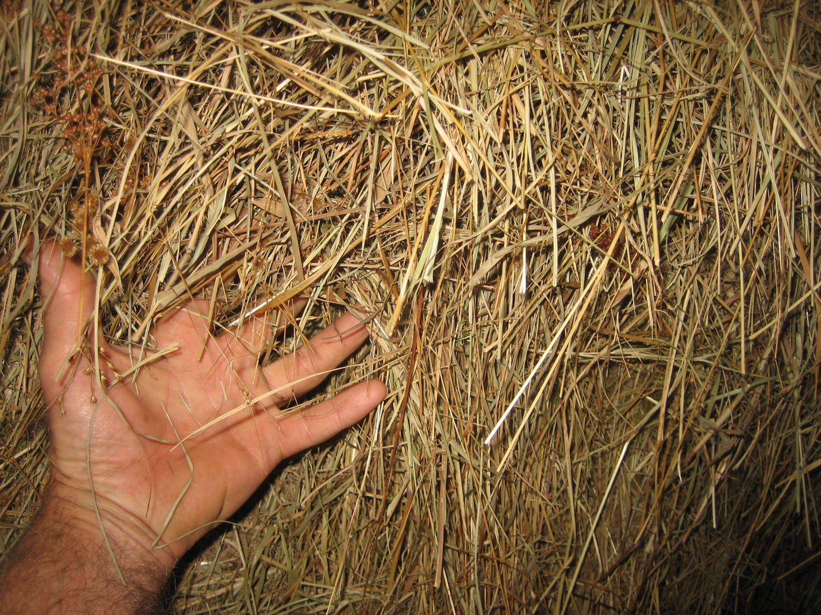

I think any type of straw would be OK . I would stay away from alfalfa and timothy because of price and also the alfalfa is kinda leafy. Just grass hay will do OK.

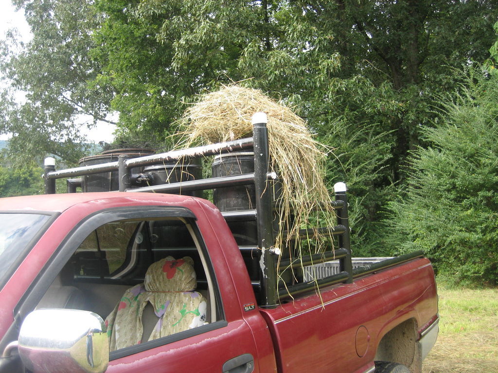

I have used very small wood blocks( 1/2 x 1/2 ) , wood savings and charcoal but the best I have found is hay. When the hay filter is changed I can leave it lay a few days to dry and burn it , put it in the garden for compost and biochar ( charcoal dust ) or if left in the open certain times of the year the cows will eat it.
It takes less than five ponds of hay for the filter . My 800 pound rolls of hay are worth about 40 bucks which makes the hay very economical for my use .

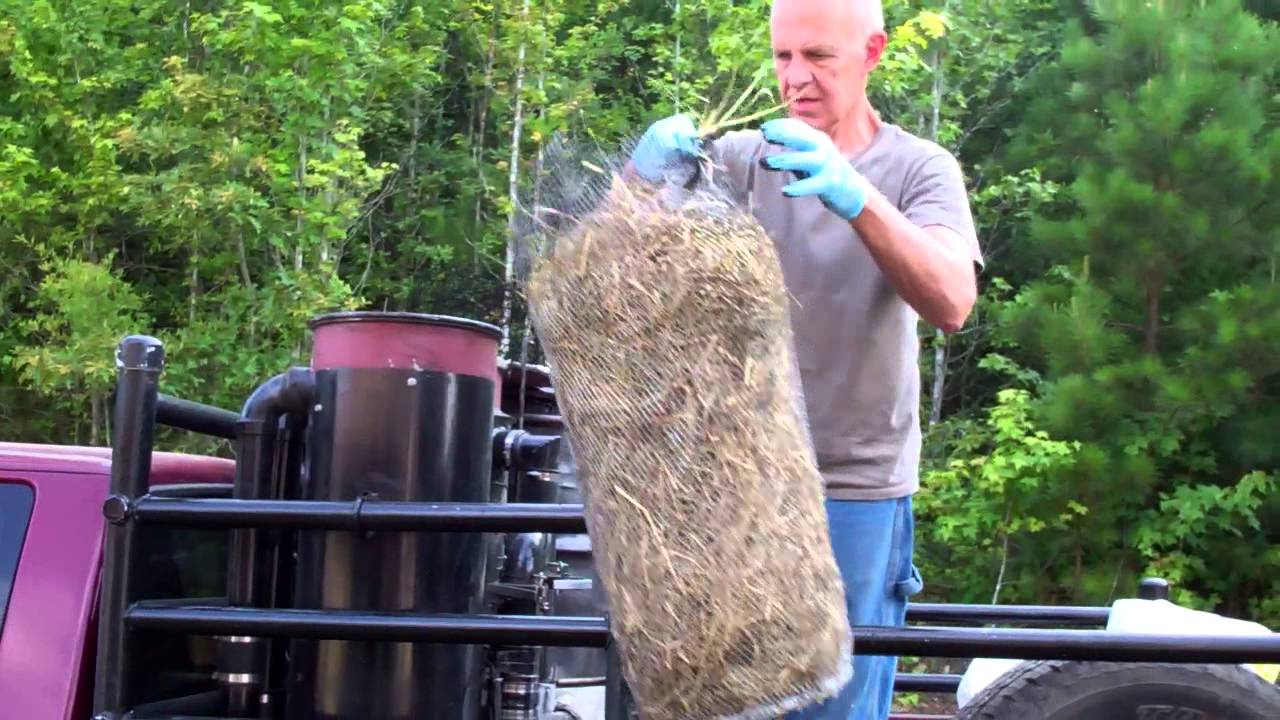

Another thing to consider is how easily the media can be changed, I think I have some videos somewhere I will try to pull up but in the meantime here is a video from one of my heros .
Filter media right out of the field .

Any further processing tricks for hay we should be aware of ? ( I just watched the video and really like you bag idea ).
Thats slick and fast.

Carl was the one to turn me on to the laundry bags. They work great.

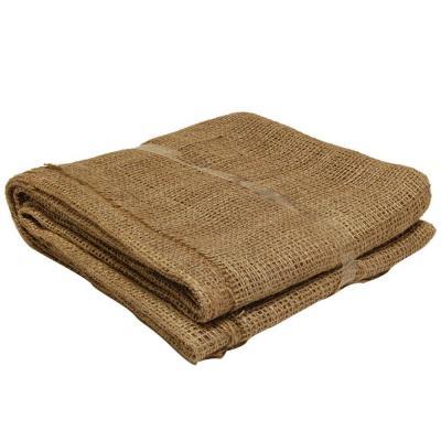

couldn’t get my hands on any hay or straw for a period of time so I ended up trying rolls of burlap used for wrapping shrubs in the fall to protect them from winter winds/cold.
I used 2, 3x25f rolls of burlap to fill the 45gallon barrel i use as a filter. seems to work quite good. I find it alot easier to change out than hay also I can ensure that the filter material is tight against the sides of the barrel. I tried the hay in the bag trick but had issues of the gas bypassing the main mass of the filter and flowing up around the edges where resistance was least.
this may be a good alternative for those city dwellers that don’t have access to agricultural goods or need some filter material in a pinch, you can get this stuff year round a home building centres.
Been using the same burlap for roughly a year now and holding up well. has just been turned black from the soot but no signs of degradation of the fabric and remains quite “free flowing” due to the large pores that are manufactured into the material. haven’t tried to wash it yet but black soot comes off when touching the burlap so assume that this is also a likely possibility as well.
Biggest downfall with this material is it freezes up in the winter, however hay and all other materials due this. The warm woodgas will heat things and melt the ice in the filter however this does take a bite to do and depends on the ambient temperature so I find that when we get into 0 Fahrenheit I run without any filter material except for some courser metal screens or there is too much restriction from the filter (due to ice bulidup) and I have idle problems.
