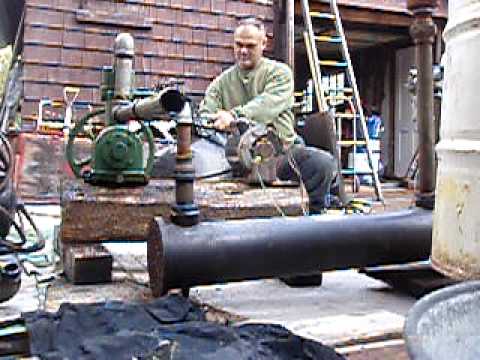

I went through this question a decade ago…laminar flame speed of hydrogen is 8 meters per second, while carbon monoxide is 1 meter per second. Laminar means if the gas and air mixture was in an one inch pipe 8 meters long, it would take 1 second for the flame front to travel the eight meters. This is completely opposite of what happens in an engine. Engines burn gas with turbulent flow, which is much much faster.
Here is an experiment I did some years ago with carbon monoxide and laminar flow.
