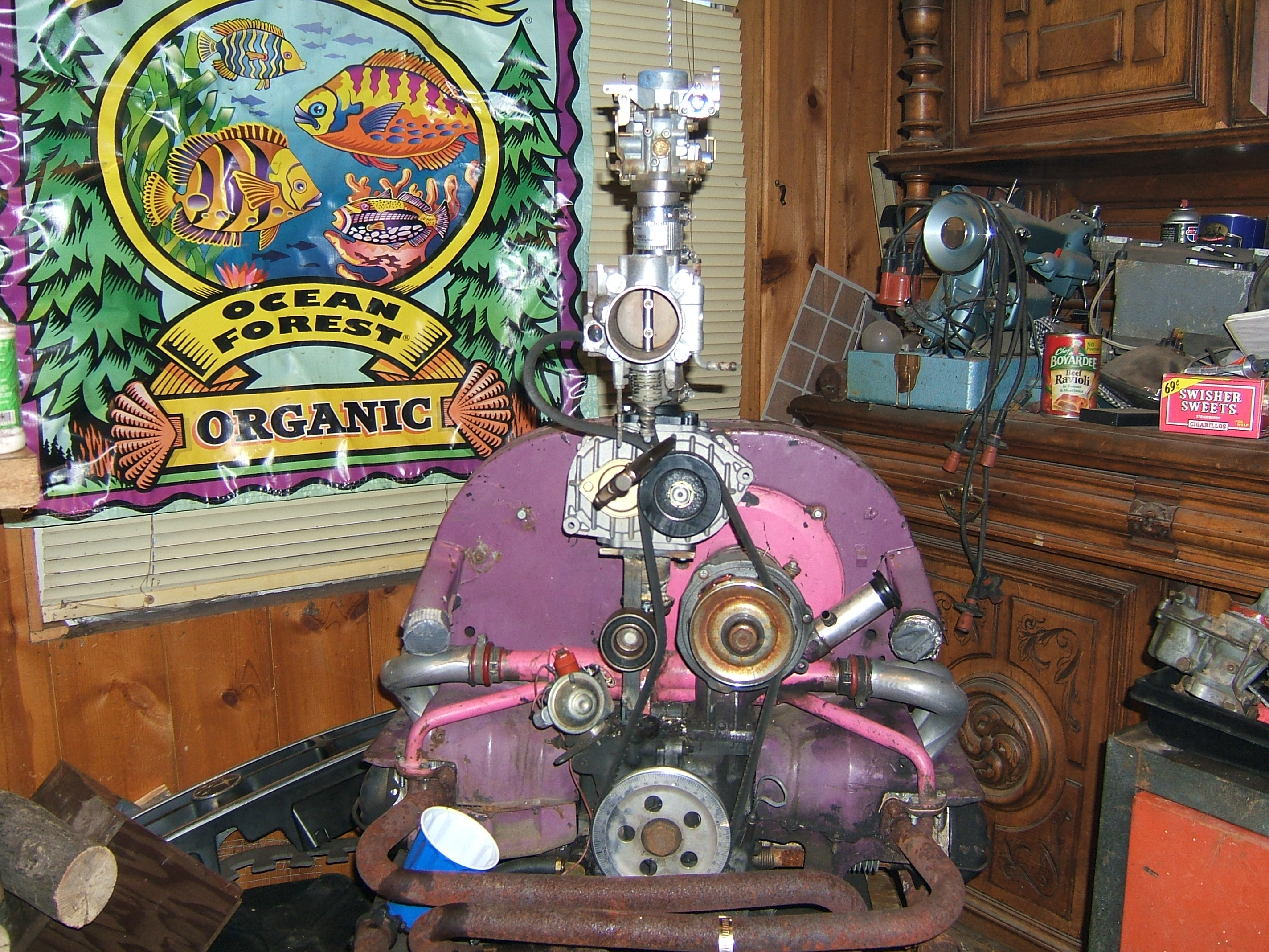

Xoie Ichigo’s now belt driven super charged will-be-again woodgasses engine for his car show vehicle.
Some here do pursue turbocharging and supercharging and precision machining works compression ratio improving for their woodgas systems.
Always the most expensive way to go with many, many downside consequences.
