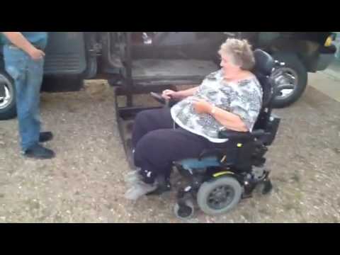

Wheel chair accessible Dodge Ram and camper.

Thanks for all the nice comments about my modified Dodge Ram wheel chair conversion.
And thanks for watching the video.
I did this modification 5 years ago. It’s a 2 wheel drive . I raised the cab & box up 4 inches & lowered the floor 4 inches.I had to also lower the doors & make a new rocker.i made 2 hinges for the back door so as to open them all the way.I made the electric over hydraulic lift & fasten it to the frame. Also a locking device to lock the power chair to the lift, like a fifth wheel lock on a semi.
Being I raised the cab up 4 inches I had to manufacture a new fan hub & raise the fan up as well.I shortened the back seat as well.
All the bushings in the lift linkage I made from melted aluminum Pistons .
This project took me about 5 months.
It works great.
I thank the Lord for the guidance…

Calvin, did you use a sand mold to cast that Molten aluminum or something else? Thanks, great work! HerbH

Hello Herb
I use 12 inch pieces of pipe various sizes & stand them up on a 1 inch thick piece of plate to absorb the heat & pour the aluminum into the pipe.
After it cools down I put it into a bucket of water.
When it cools right down the aluminum shrinks more then the pipe and comes out , providing the burrs inside of the pipe were ground out a bit.
I then chuck the aluminum pieces in the lathe & make bushings , pulleys or what ever.

Thanks Calvin, now I have to ask you how you melt pistons, forge, oven, torch???
Making your own aluminum parts is a step beyond fabrication, hope you don’t mind sharing!!!
20 years ago I had to buy a round 8X12in chunk of aluminum to machine upper and lower blower pullies for my A, I don’t remember what it cost I just remember it was a lot!!! Your saving lots of money pouring your own!!!
Thanks for the info, Herb
