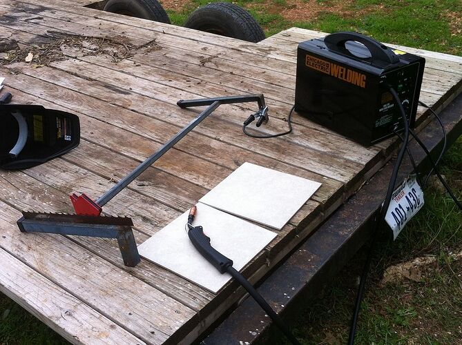

The first picture is of my “welding table” which consists of my redneck homemade flatbed trailer backed up to my service pole which is where the 240V plug is wired.

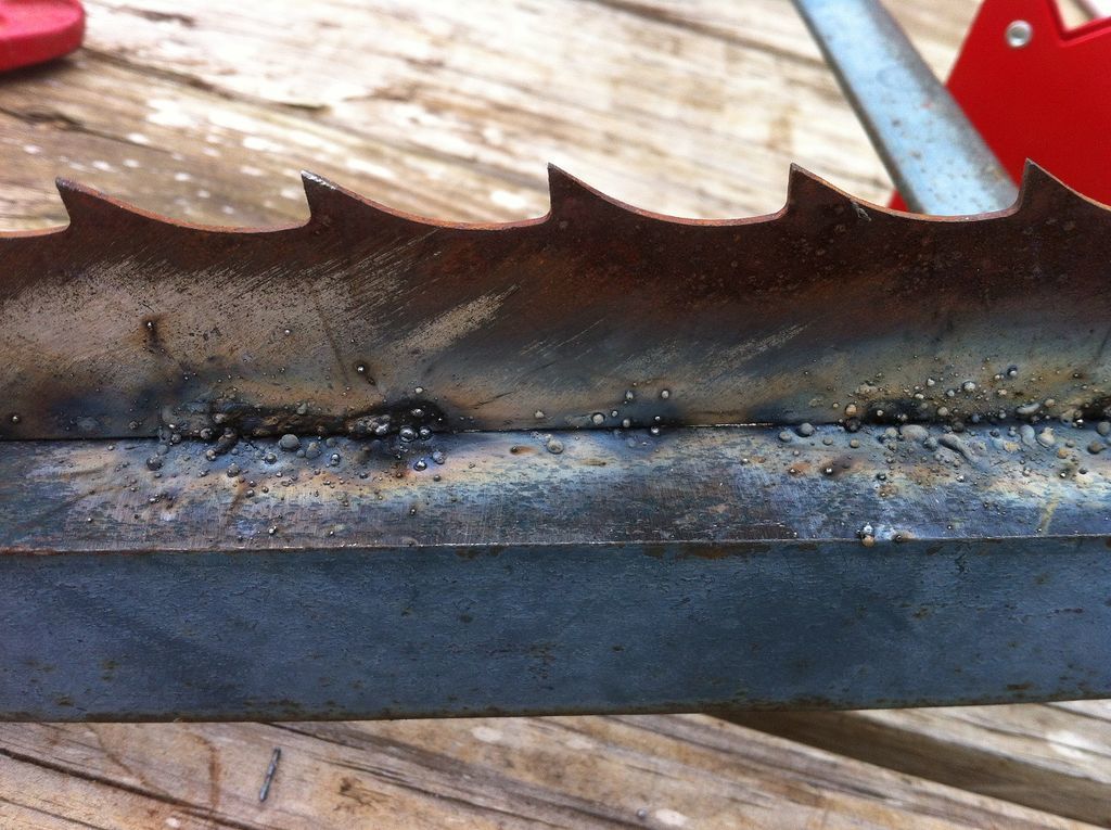

The second picture is my first attempt at flux core welding. I am trying to attach a saw blade to section of 3/16” angle iron. Every time I pull the trigger, all I get is one big “pop” then nothing. I pull back from the metal, then move in again, another “pop.” Repeat ad infinitum.
I have a gut feeling it has something to do with wire speed current setting. It’s got four discreet current settings, from 30A up to 170A, and an infinite adjustment on the wire speed. Thus far, all I’ve tried is flux core. Need to learn the mechanics before I plunge into buying gas cylinders.
Any opinions about what my initial settings should be as a starting point?
Alex, if your wire speed is too slow for your current setting, the pop you hear may be the welding wire striking the weld surface and then burning back so fast that the arc is not sustained. Do you have the polarity setting for flux wire on the + ground terminal? Clean ground connection to the work piece? Maybe Johnny C will chip in with advice as he built his whole system with an inexpensive flux core welder.
What settings did you use ? amps speed ?
I used flux core and a cheap welder to build my gasifier …The best advice I can give is make sure the area you are welding is clean ,this makes a huge difference ,and to get your wire speed right , just start welding on a piece and adjust the wire speed until the sound is like a sizzle kinda like bacon frying.
You will have to adjust the wire speed for what ever amp setting you are using .
Usually on my welder at 40 amps my wire speed is about 5 …
Another thing is to not get ahead of your weld puddle , just move at a steady rate …
And also with flux core , if you stop and it cools , that a wire brush and clean the slag off before y9ou start welding again …
Another thing that might help is to look up videos on YouTube on how to weld with flux core wire …
my understanding is you should be electrode - (negative) for flux core. make sure what you are welding is fairly clean… make sure you have a really good ground… and I do think you need to increase your wire speed… I’d also turn your heat up to it’s highest setting… you’ll know your wire feed it too fast when you feel it pushing your welding hand… lol… i’ve only had that happen once or twice.
move your ground closer if you are trying to weld it like you have it in the pic… ground clamp far away, welding on closer part… I can garantee you’re not getting a good ground that way.

Flux core is very similar to Stick welding… Looks like perhaps to little feed and the polarity is reversed or maybe non flux core wire?
Is the Welder set to 25% wire feed and 3/4 power?

Ok, five things to try:
  1. Move ground closer to work.
  2. Clean my material better.
  3. Check polarity (electrode negative is supposed to be the factory default).
  4. Increase my wire speed (I’ve been too timid and have erred on the slow side).
  5. Grit my teeth and don’t give up so easy!
I’ll let you know how it goes . . . .
Is it just going “POP” once but continues to feed wire slowly or is the wirefeed stopping with every “POP”? You also might need to hold your tip closer to your work material. On my little unit, I get the best welds with my tip about 1/4-3/8ths of an inch away. When I started welding, I would try too hard to see everything the puddle is doing and catch myself with the tip over an inch from the work piece. I’d just get “POP… POP… POP…” at about 1 second intervals.
What thickness wire are you using?
Is this welder capable of a MIG set up? If so throw that flux core as hard as you can through it and get shielding gas and new wire. I bet that welder will weld just fine after that.
If your liner has any flaw or resistance you will experience burn backs like this. My brand new Miller came straight out of the box like this and we delt with it for a year. I finally bit the bullet and got a new liner and it welds just as it is supposed too.
But yes first check your polarity and all the things mentioned above.If it still wont weld then I would suspect the liner.
If you are having liner issues, try THIS TRICK before getting a new liner. It worked well for me for about 2 months before I had to reapply.
Pull the trigger with the torch away from the job and watch the wire feed, it should be smooth and consistent. Any thing other than that and you will never get a good weld.
A flap type grinding disc is great for preparing the material, you will get much better welds with shiny metal to weld on. Another thing to try is set your job next to the welder and and turn the wire speed while attempting to weld with the other hand. This way you can adjust the speed until you get a nice bacon frying sound. Adjust your voltage to get good penetration but not so much it melts out the other side.
You need to change settings for different welds but once you get started you will soon get the hang of it and be able to pretty much guess the settings with minor adjustments to fine tune. Lots of videos on youtube that will help you.

All good comments and I would add one for safety. I noticed you are working/standing on a soil floor making you a good grounding source in one of those “how the blank did that happen” moments. Insure that your unit is plugged into a properly wired ground fault interrupter circuit. Be safe, you’ll only be unsafe once.
