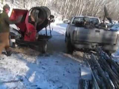

Many wood chippers that I have seen produce chips that are generally too small. I keep chips that fall through a 1/2" X 1" screen. I have friends who have wood chippers in the 8HP disc (3" max) range to a 25HP drum(6" max range). Even when chipping only branches over one inch in diameter, the bigger chipper only makes about 20% chips that I can use. The 8HP machine is worse.
Take a look at this Greg Manning video.
He has a pretty good process going and has been at it for many years.
I have been gathering commercially made wood chips; those produced by disc chippers that take whole trees. Even then, I absolutely have to dry and classify (sort) the chips before use. In my experience, drum chippers make smaller chips that do disc chippers.
I had thought that you could adjust the knives to produce any size chips you want, but the commercial guys don’t want to do that, and, it isn’t clear from the couple of manuals that I have seen that it’s a good thing to do anyway.
