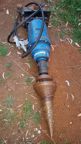

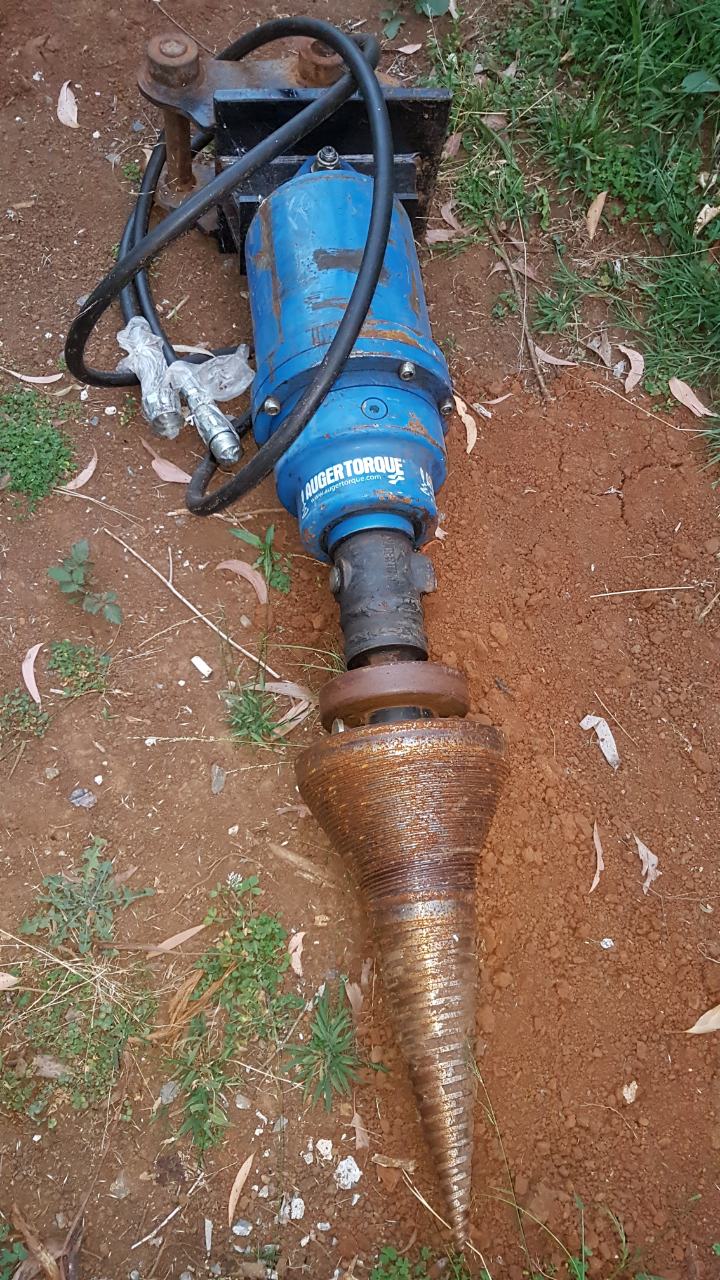

This one Brian bought from the states its called a Atom splitter driven via hydraulics from the excavator, revs are approx 180 per min slow but a lot of low down torque and will split 4 ft dia rounds no problem at all
Dave, those are fantastic!
