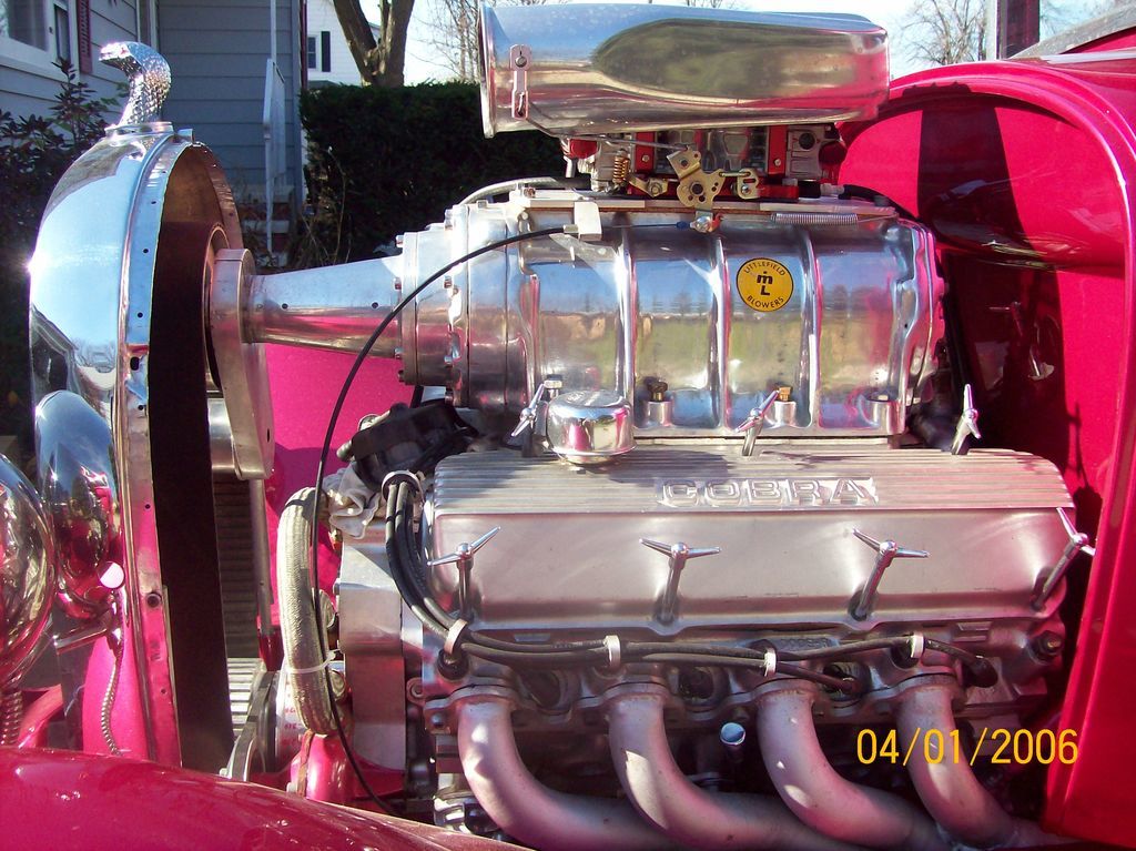

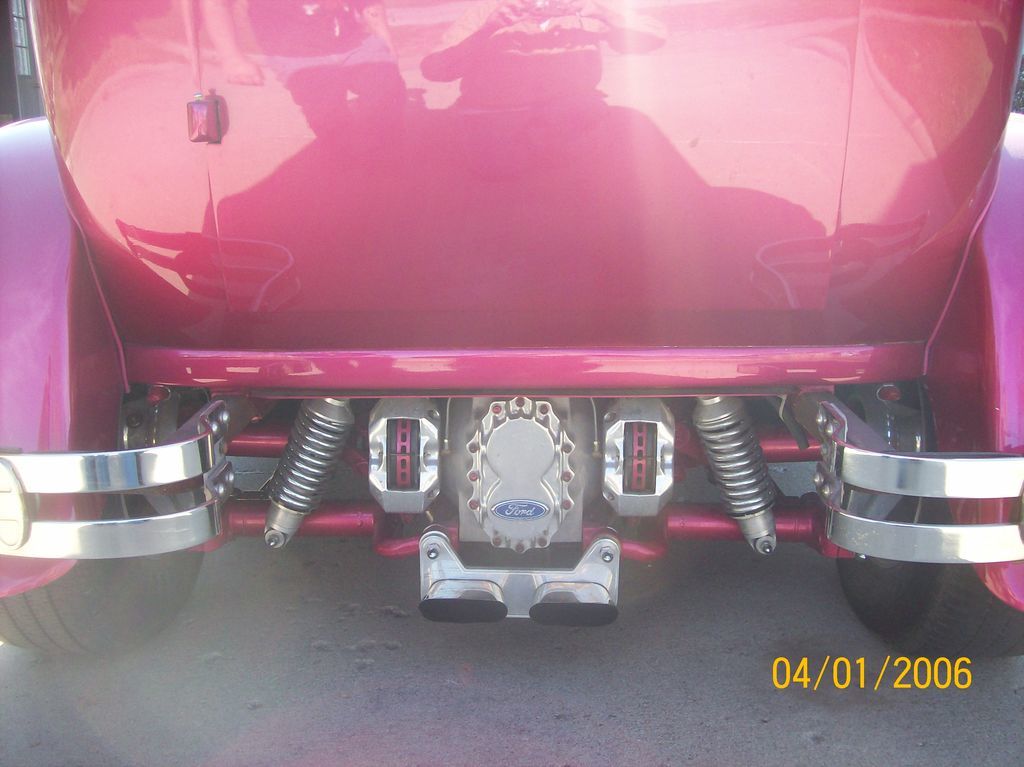

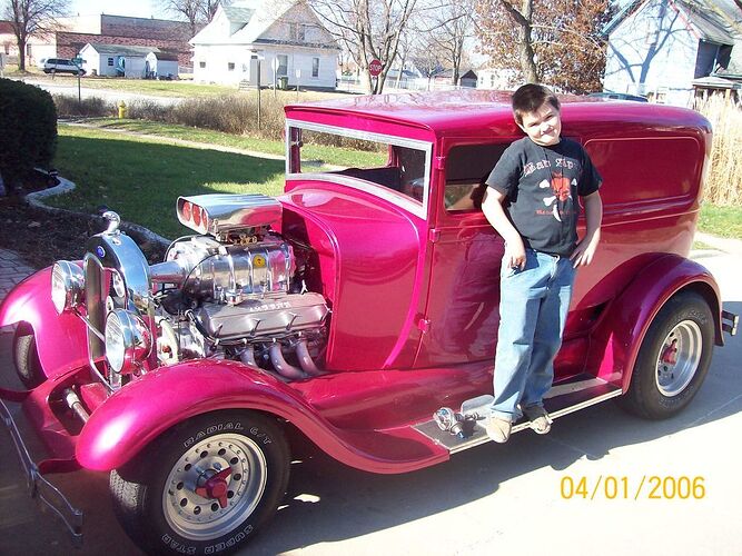

Thanks Mike, I have you in my phone now. A couple of guys have asked about the car I have in my picture. It’s a 1929 Model ‘A’ Ford Sedan Delivery. I built the frame 35 years ago out of 2x4 tubing, gave $50 for the junk old body back in the 70’s, I have a Blown (671) 429 Super Cobra Jet Ford in it for power. Top chopped 4 and 1/2 ins. Independent suspension all the way around, Big Ford 9 in. quick change rear end. Right or wrong I did it all. I don’t drive it to much any more due to outrageous gas prices, it doesn’t do that great on gas! I do get it out if a bad chevy comes to town. I tell the Chevy guys “Chevys are hard to beat but it SURE IS FUN!” It’s just a joke, please don’t be offended. Latter, Herb PS That’s not me standing on the running board, I’m much better looking. ha Another PS I beat the Cancer thing! Thank God
Thanks for the pictures Herb. I don’t believe I have ever seen a sedan delivery before with the hinged opening door in the back.

Yeah Don the old body I started with was just a 2 Dr Sedan with rear side windows, it was in such bad shape I ended up getting a Sedan Delivery kit from Gibbons fiberglass, you get the rear door with those hinges and the upper rear side panels which take the place of the old rear side windows making it a Sedan Delivery instead of 2 Dr Sedan, sure saves on body work. Thanks Carl, what a nice compliment, I appreciate that, you are very kind. Mike I’m looking forward to meeting up with you too, will be fun. I’m in Woodward Ia, about 40 miles NW of DesMoines I can’t wait to see another woodgas machine. Richard, that’s a good one, I laughed about your comment for a while and Wayne thanks for the compliment, I don’t know if I deserve that, but I’ll take it, thanks. Herb

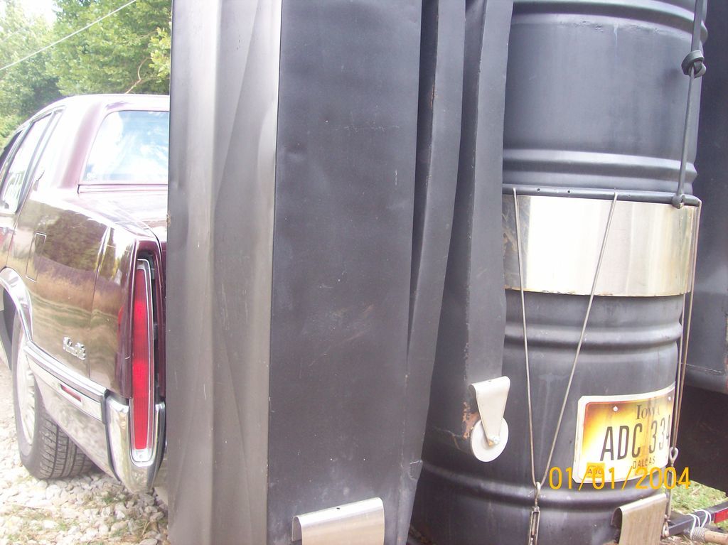

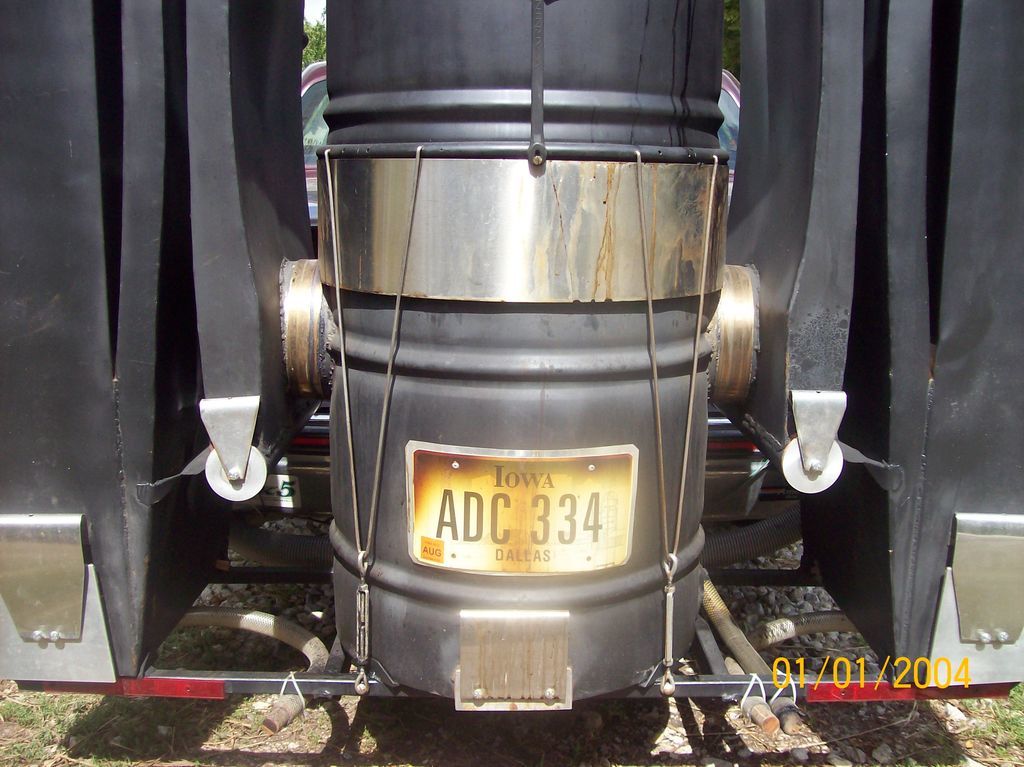

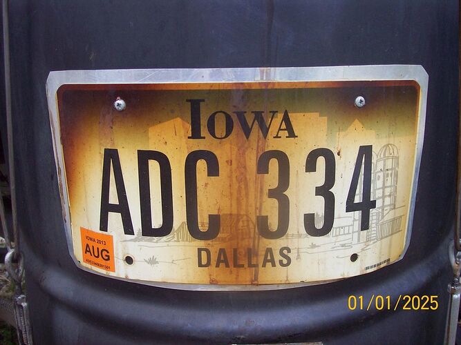

The Wood Powered Caddy has about 1400 miles on it now, I thought some of you would get a kick out of my license plate, they just don’t make things like they used to, ha! I put that piece of aluminum behind plate after it got scorched, I don’t think it’s become any worse since. It runs good, I think it is running a little better as it gets more miles on it. It’s got some tar dribbles on it from one of the hold downs breaking and it is sucked in from vacuum where ever it can, I have it braced from the inside so it can’t go in any more, I hope. later, Herb
Herb, Where is your license plate light ??? I used a side lamp for a trailer for the one on my 91 olds but I mounted the plate on the rear tailgate off to the side and attached the light to the gasifier mount. I’ll assume (ass out of u and me) that your brake lights are out beyond the unit … Cute bumpers … Mike L
Ha! Your scorched license plate puts a new spin on “Burn Baby Burn!”
License plate light? What do you need that for? Just kidding. The tail and brake lights are out past the unit a full light, had a friend follow me at night and he said it was lite up pretty good back there, I don’t know if the police would agree with that.
Yeah Billy, I probably drove it harder that day then I ever had, it’s really just the plastic coat they put on those cheap tags now. When I first saw it I thought I needed to replace it but I kind of like it now. Your right, nothing says BBB like that plate.

Hi Denny, It’s all WK accept the first part of preheat, coolers, hay filters and that it is a complete dual system. As far as weight I think about 450 lbs. It weighed 380 lbs when I came back from sandblaster without a small amount of SS and aluminum. As far as mounting I used 1x2x11ga. tube 5 ft. long and bolted it to the rear of the Caddy frame on both sides just like a trailer hitch would be. I put air bags in the coil springs to carry the weight, so far so good. It has factory air shocks w/compressor but they slow leak so I don’t use them. latter, Herb
