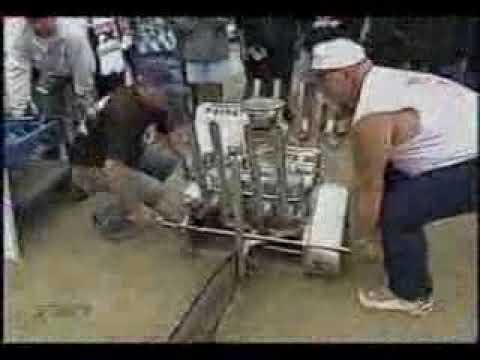

if that can give you ideas, i find this great system for making wood for gasifier.
