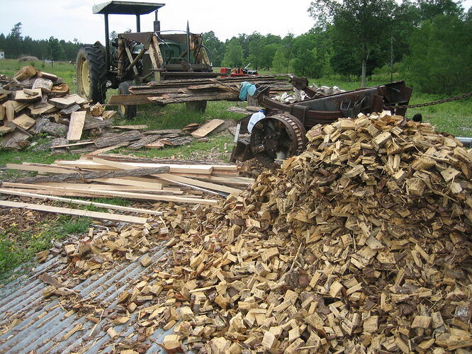

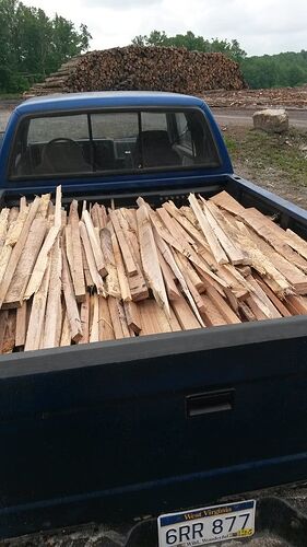

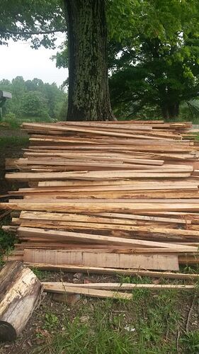

Talked to my local mill mangers and asked them about some edging strips for linear processing of chunks instead of using the blocking. Much simpler chunking. Hauled 3 loads yesterday. Just had the “bored” chipper operator pull the strips. With that edger we filled the dakota in 20 minutes.
Real good catch there Ian !!
Looks like it is already sized well for your size gasifier.
If it can be chunked while still green or wet it will be very easy. If the strips are dry a saw works best ( I have used a table saw )

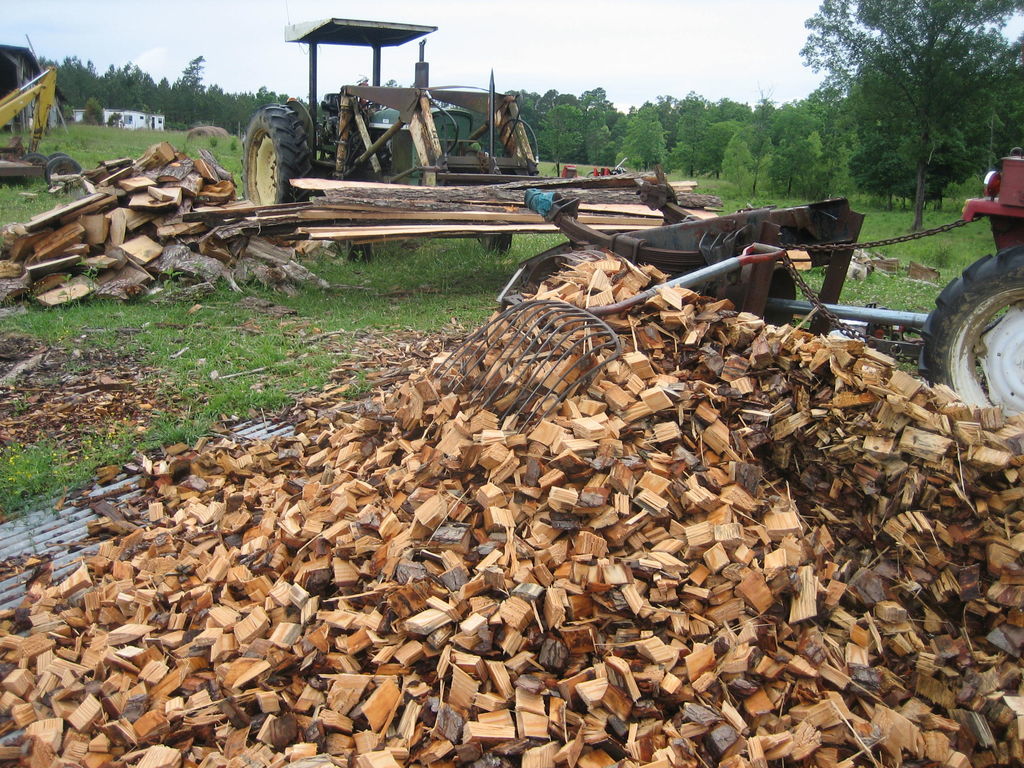

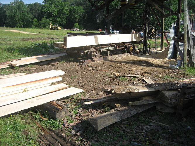

Yesterday the rain ran me out of the hay fields and too wet to do barn repairs so I saw milled. The slabs and edging went right on the tractor forks from the logs and on to the chunker .
We chunked a couple of lifts that should total near 3,000 pounds . After drying should weigh about half that.
HWWT
