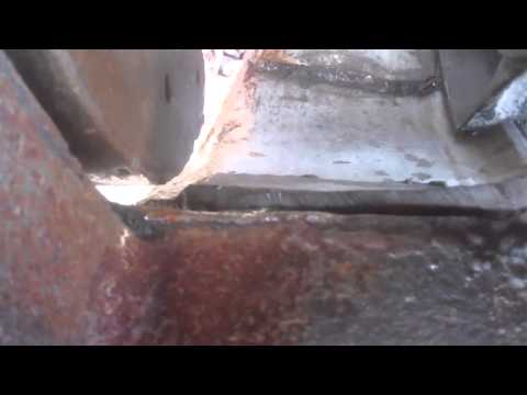

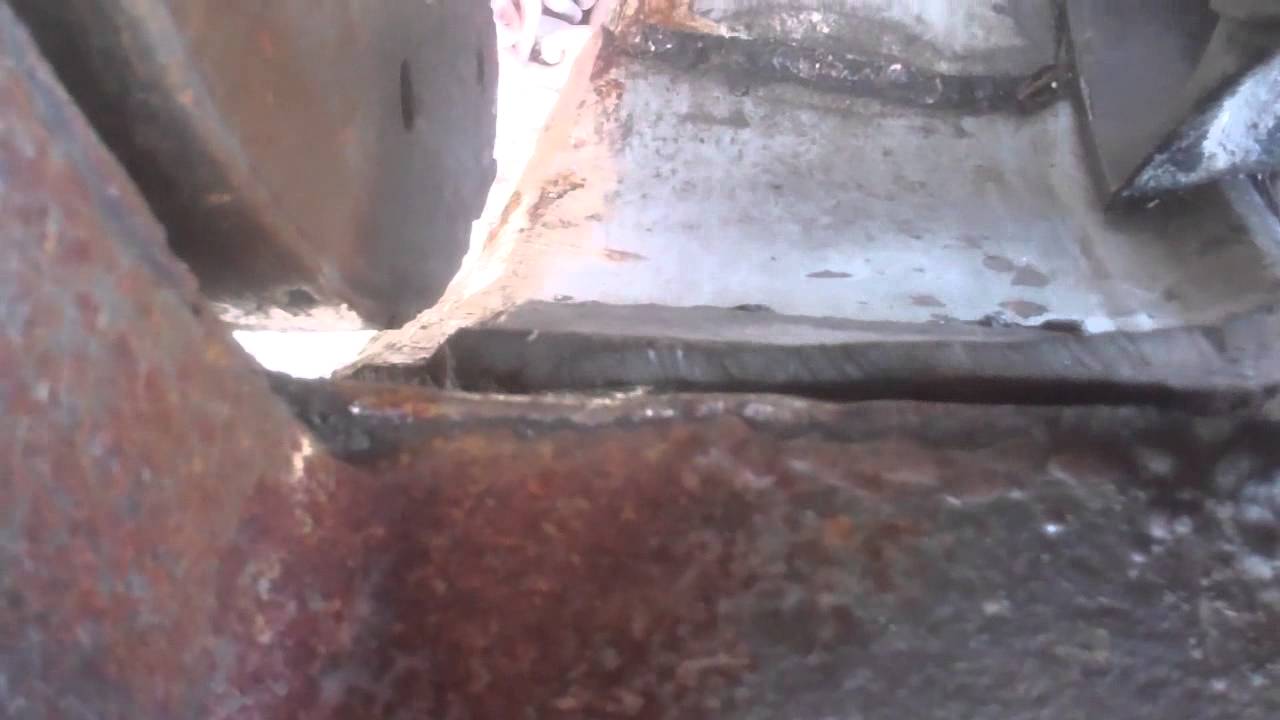

I while ago i promised i’d upload some videos showing some of the stuff i work on, on a daily basis. Here is our Hemco edger. Missed a sequencing input flag but running pretty well. Rapid Fire edging strips! should feed all our trucks in a days work :slight_smile:

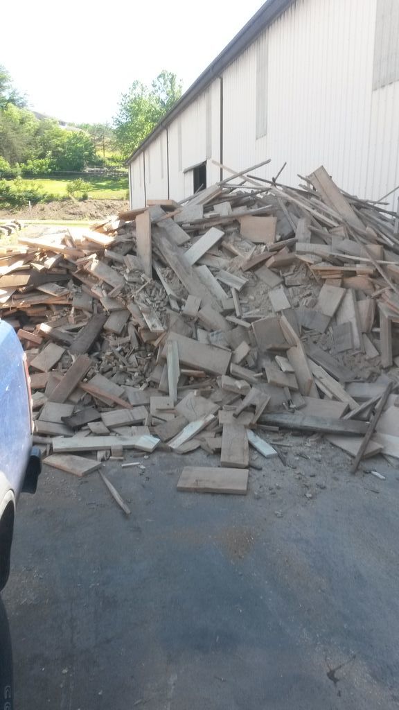

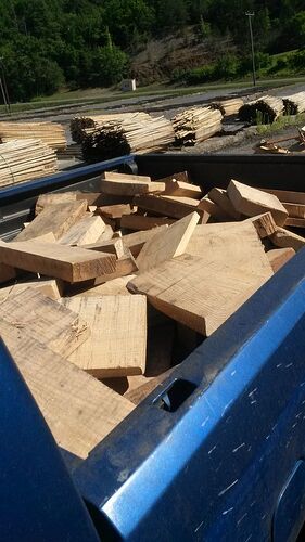

Visited one of our KD sites for some work and as usual asked the mill manager if they had any unprocessed I could grab and low and behold the chipper was down and will be down for 5 weeks. They are in red oak and white oak for the duration and he begged me to take as much as I can. I gladly abliged. Full load of 8/4 red/white oak :smiley: getting another load Monday.
Good thinking Ian! Get the wood BEFORE it’s chipped and shredded into unusable tiny pieces. Usually their feedstocks look wonderful to a woodgasser.

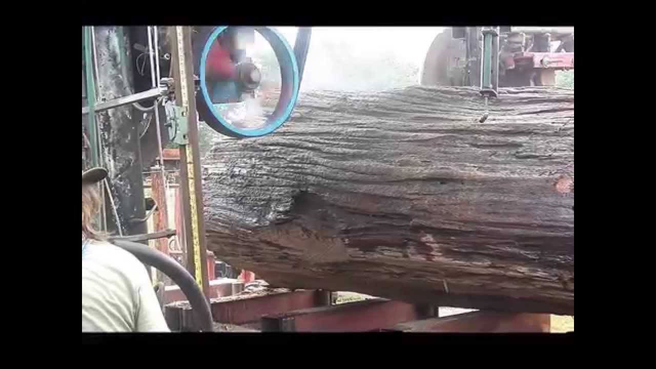

My buddy Steve Cross from South west Georgia sent me this video . After viewing my videos of riding the dakota around on the trailer pulled by the tractor also the wood powered wood chunker .
I ran back through my ancestry to see if I had any Cross blood . Could find any but if Steve went through his he might come up with some Keith.
Steve wants to come by and take a look at my gasifiers and build one . Is there anyone that doubts he has the means and ability to build , operate and fuel a wood burner ?.

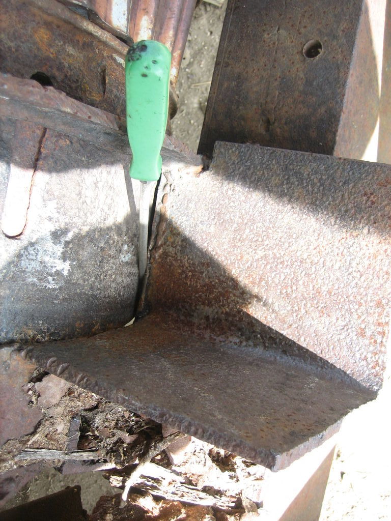

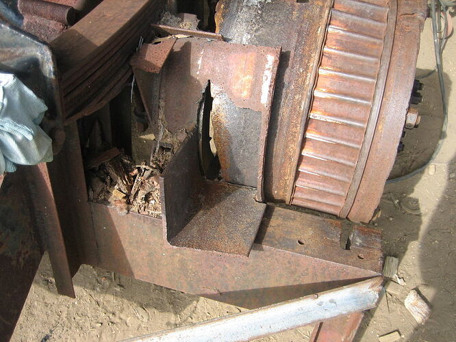

Hello all,

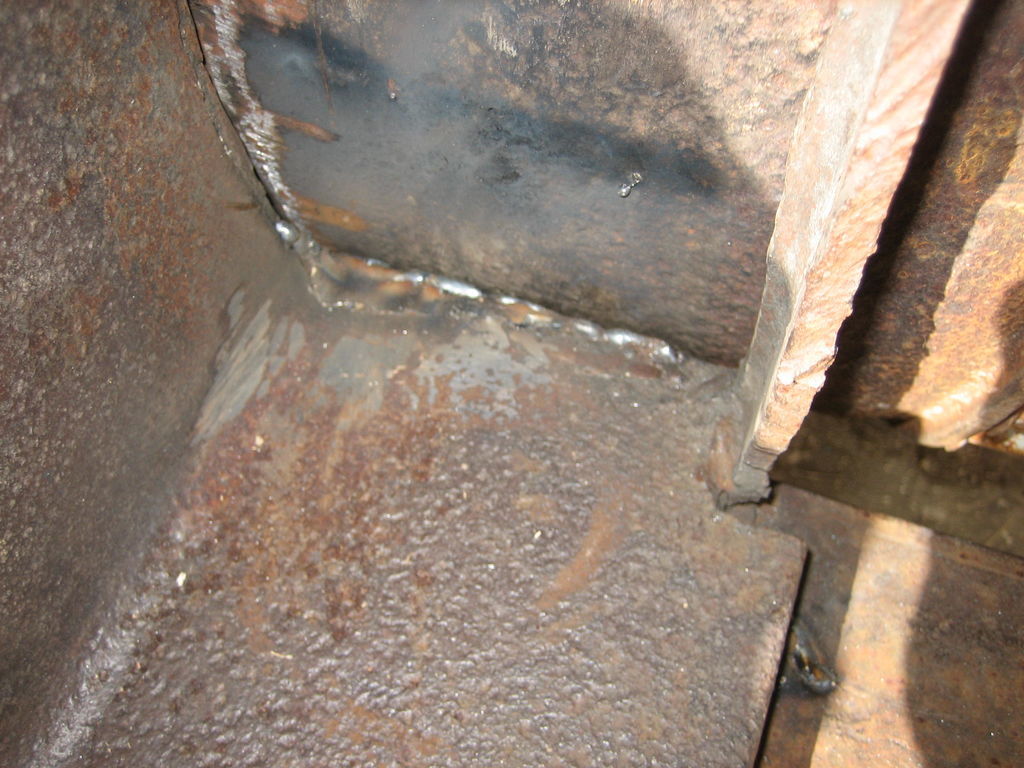

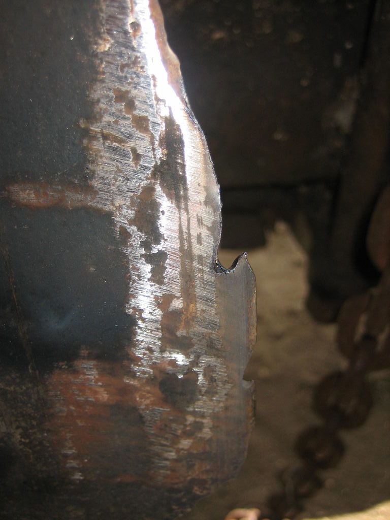

I was setting my chunker in a new location and while I had it lifted I set it near the welder and resurfaced some wear areas between the wheel rim and the anvil.
With Mike LaRosa coming by this weekend I need to have all in order so I can put him to work :slight_smile:

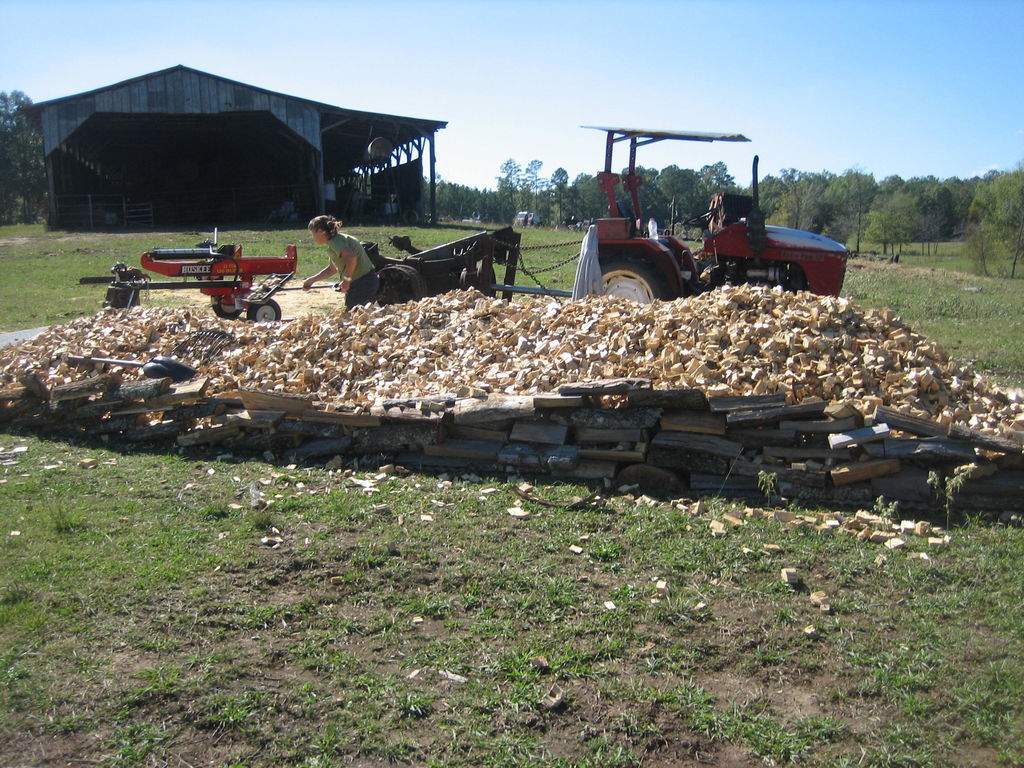

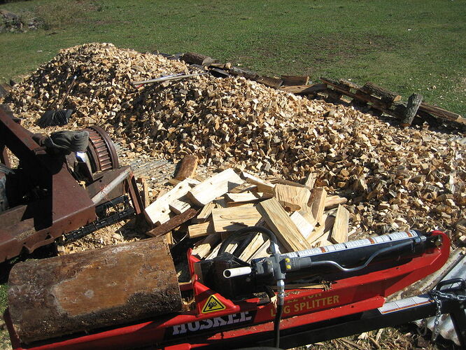

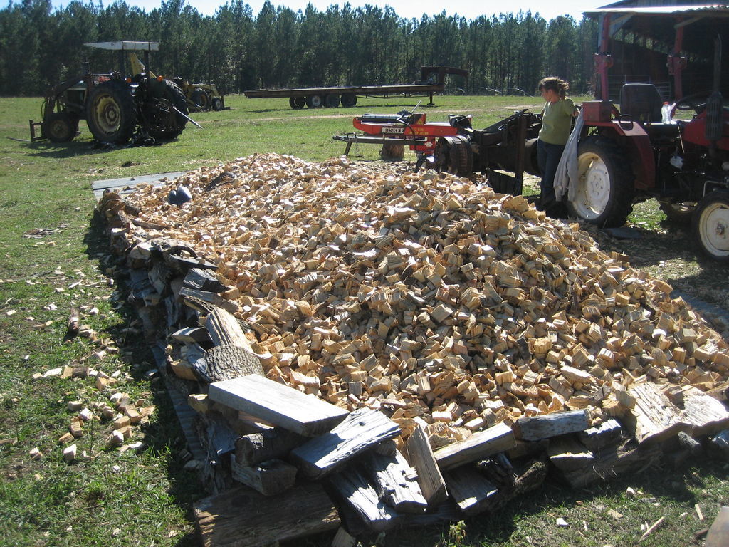

Been busy the last couple of days !!
Lot of smiles and miles in these piles .
Once the wife dries , bags and stacks in the barn it will be like having money in the bank !! :slight_smile:
BBB
how much"work" do you think you can get out of that pile?
that makes me druel
