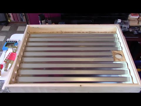

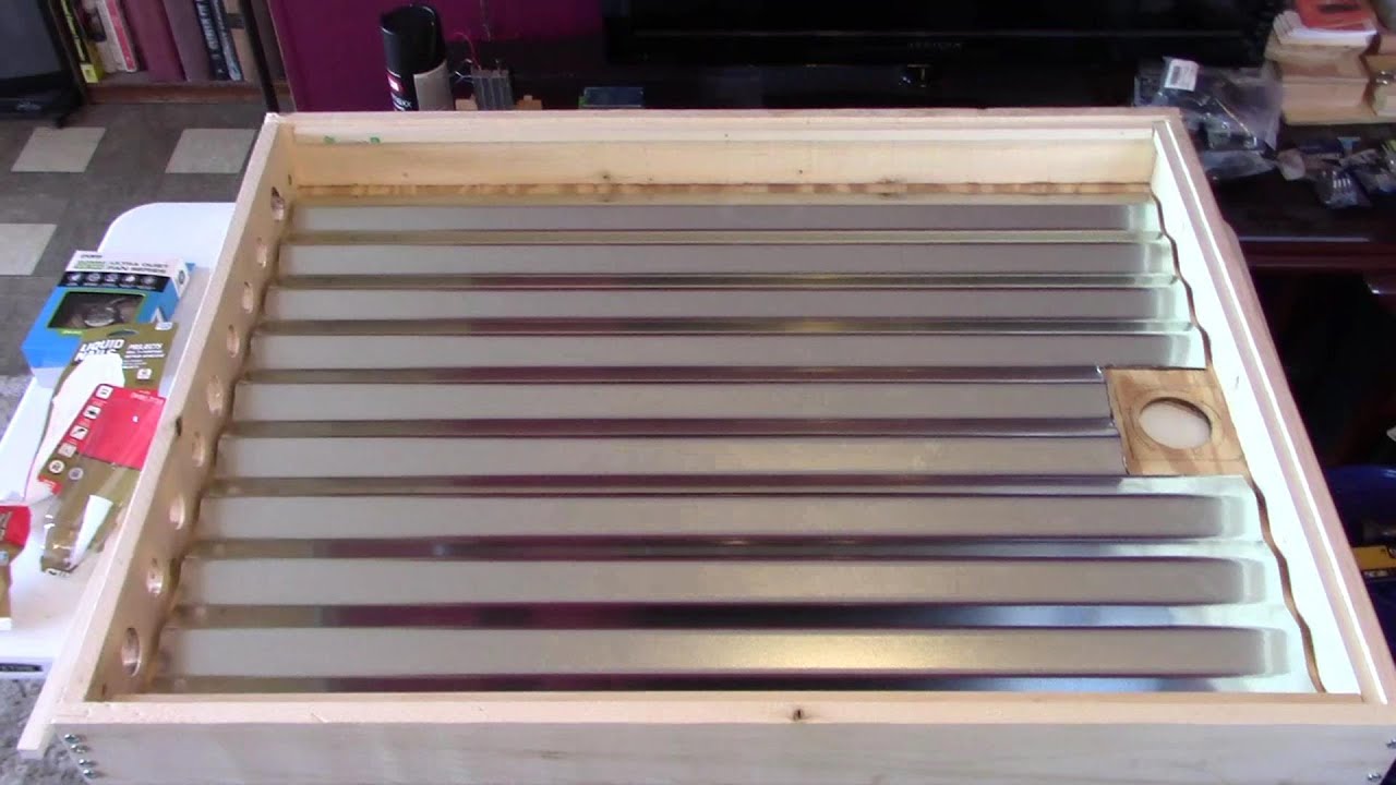

I got a second oil tank. Another 250 gallon cylindrical one.
I am thinking about making a wood drying kiln out of it for chunks, and using one or two of these to bring in a flow of hot air.
Perfect? I doubt it. Passive? Bingo.
I built a couple of these many years ago from Mother Earth News plans. Worked good but didn’t have the fan. That would have been a real plus. You are going to need a bigger fan on the other end to pull out the moisture.
