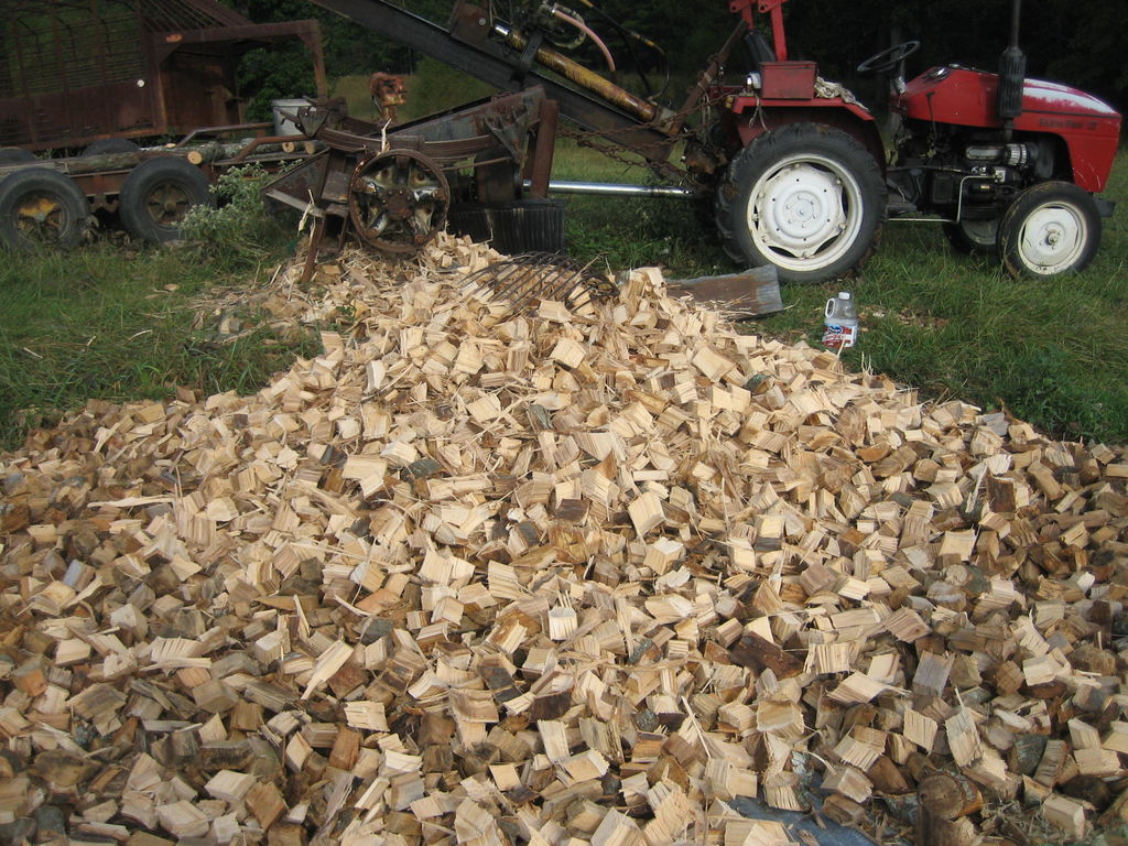

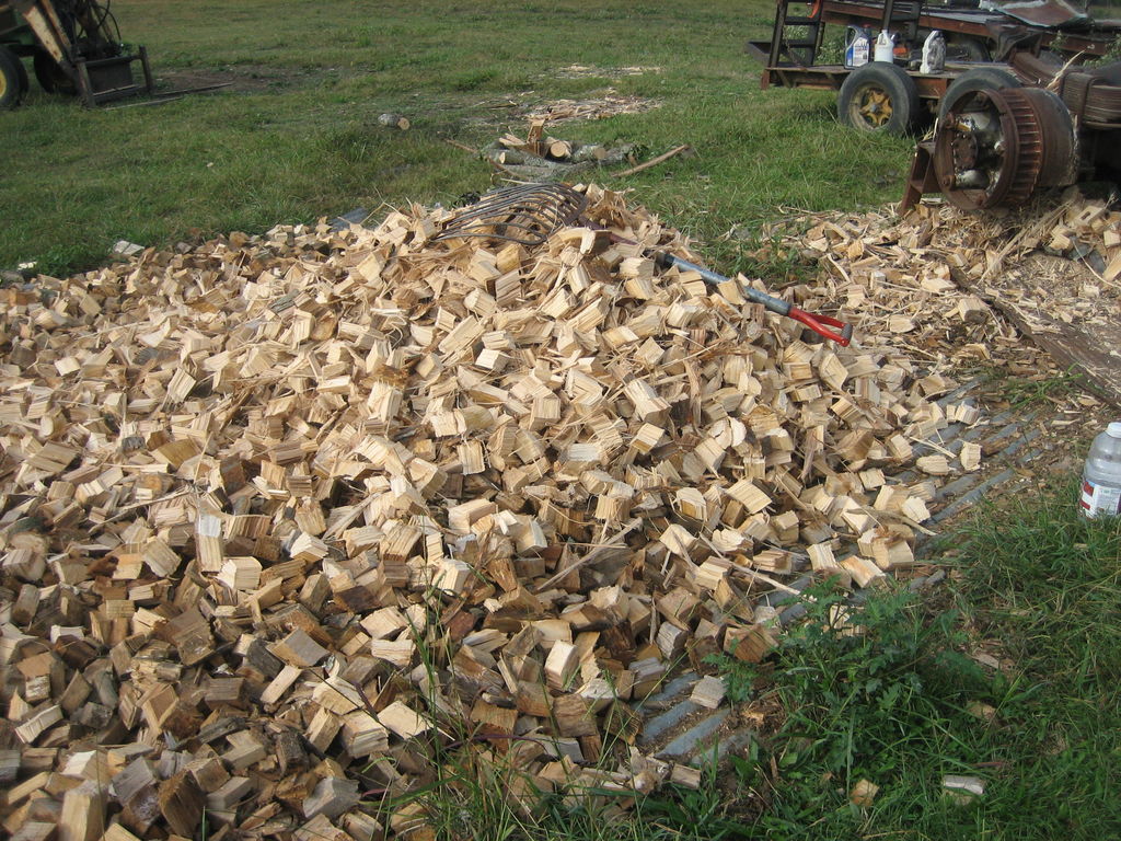

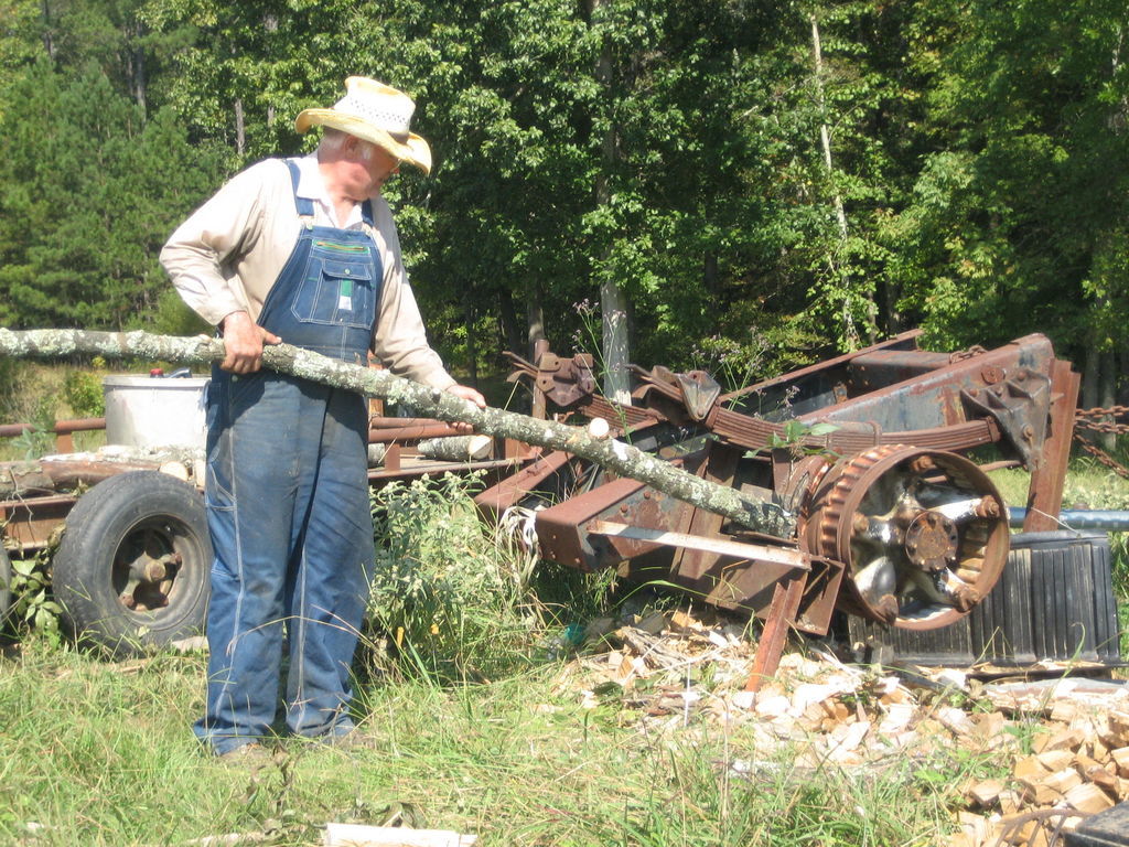

I try to chunk the wood while it is still green . If it has time to dry out it is twice as hard on the chunker.
If it is cured I will wait until a rain and chunk while it’s wet.

Very clever design Wayne.

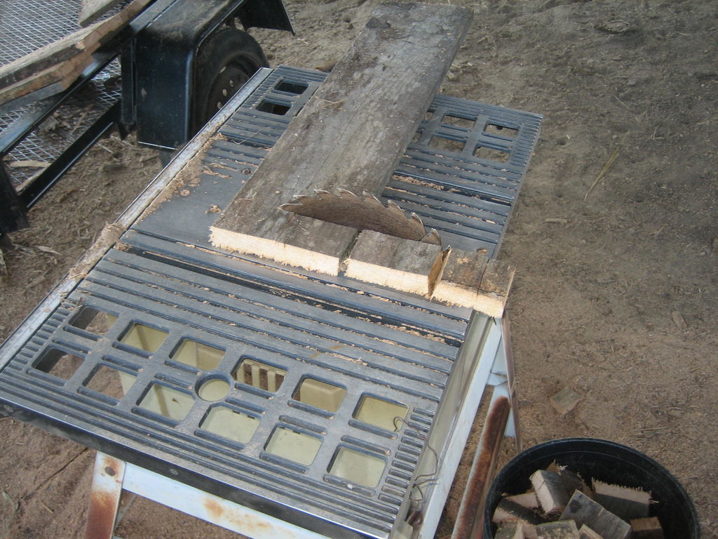

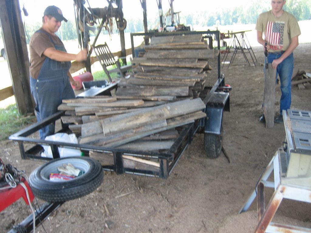

It has been stacked out for about 4 years and is dry and hard. The wood chunker splinters it up to much so I am using a table saw to cut it up.
I sawed it in 2-3 foot pieces and then hit it with a hatchet.

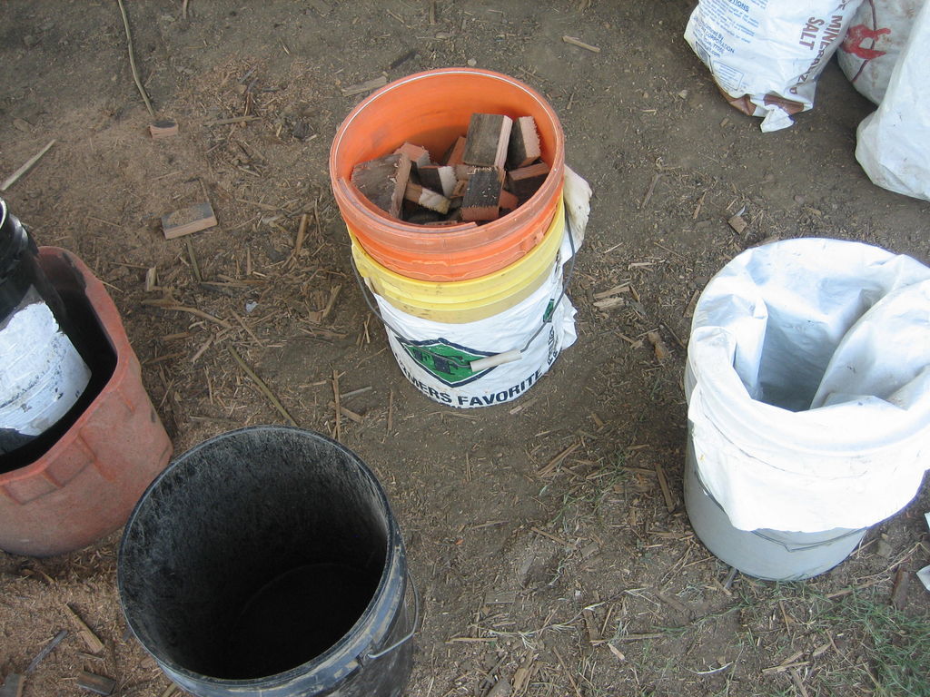

Hey Mike LaRosa, You wanted some weights on wood. A five gallon bucket of the chucked pine weighs 11 pounds. A bucket of the sawed oak weighs 22 pounds.

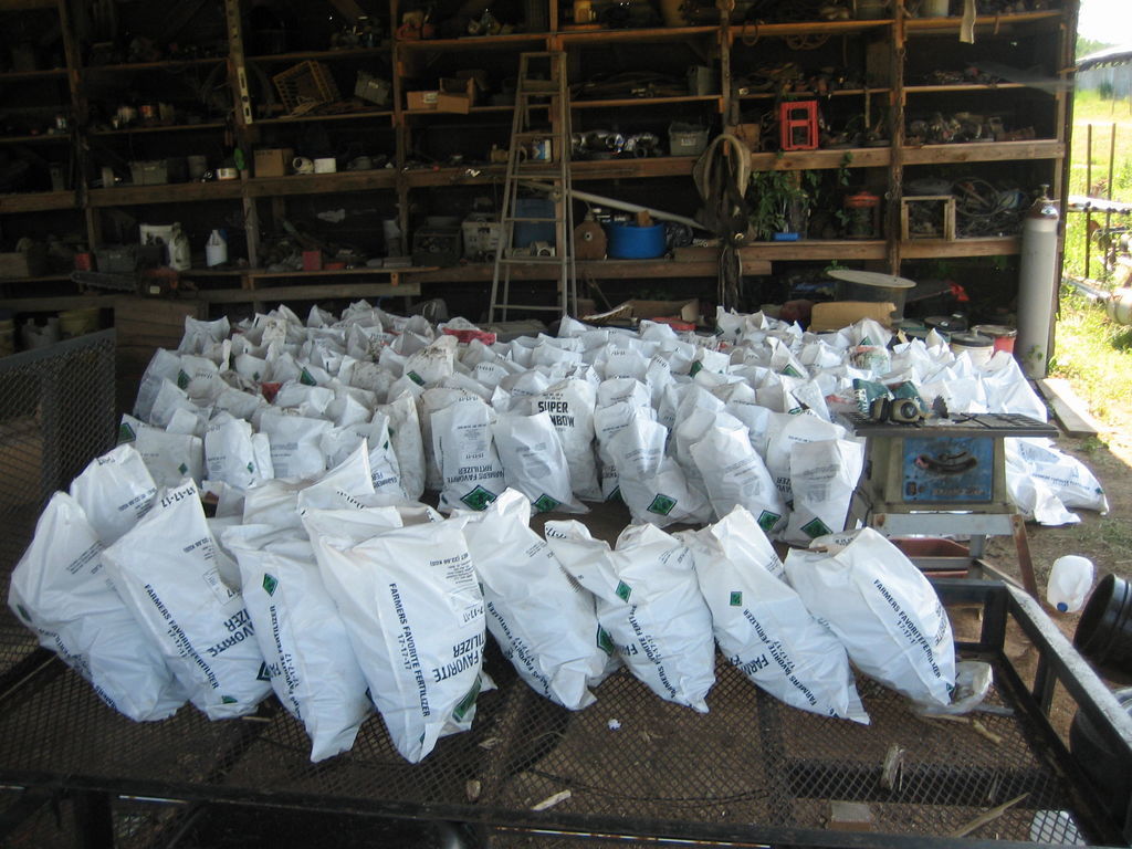

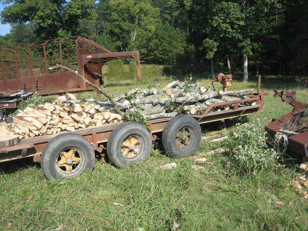

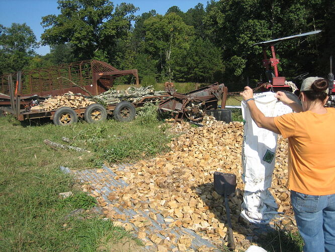

I had already hauled 20-30 bags to the barn before the picture was taken.
Each bag should get the Dakotas about 25 miles , the V-10 about half that.
I think I have over a hundred sacks of the sawed oak.
Hi Wayne and Mike; I finally got around to weighing my chunks a level bucket is about 17lbs mostly mixed hardwoods, this includes the weight of the bucket.

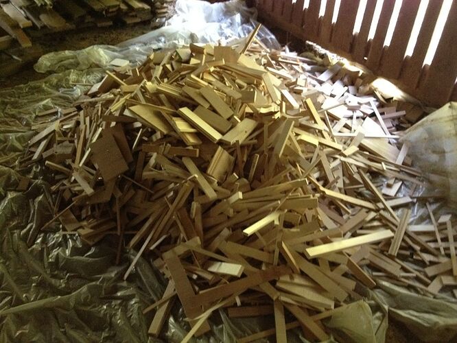

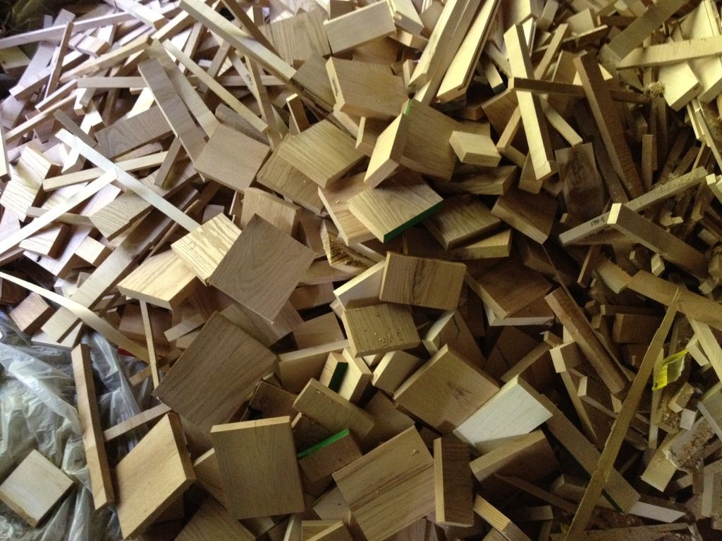

I stopped at a cabinet shop on the way home tonight and found a source for kiln dried hardwood cut-offs. I brought home 7 barrels full, and there’s about 20 more! They are only 3/4 in. thick and some are a little long, but I can re-cut them, and sort out the little pieces when I bag them. I think I can now provide wood for anyone, (call first) who wants to visit SW Arkansas.
I will help you BBB.

Hi Carl, your saw makes pretty quick work of cutting wood chunks. What kind of wood are you cutting in the video?
Hi Ron, hope you’re not burning (the countryside) like we are here. That was some old dry mixed h/w pallet boards. I’ve been looking for some cull stringers at the mill, but they resaw & trim most to make deck boards. Truth is I don’t have any think wood on hand. I did locate a small one-man mill that will save me edger strips/slabs when he restarts this fall (cool weather) In the mean time I’m collecting piles of 3/4 h/w and pine.

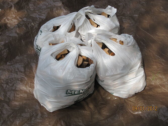

I had to look a while to find this thread about making wood for our machines but I wanted to post a possible idea for storing and bagging wood for our trips. The other day I had a hard time pushing a storage cabinet door shut against too many plastic storage bags like groceries come in - and the thought came to me - why not use these for bagging wood for our trucks. I had a mixture of apple wood and pine wood chunks that I double bagged up and weighed and these 4 bagfuls totaled 42 lbs or about 13 lbs. a bag. These are smaller sized bags than what many use but I am thinking they will fit through most hopper lids intact, and then also get recycled into a little gas in the reactor. I like it that these bags have flat bottoms and stand up by themselves and have handles to pick up and carry 2 at a time with one hand. I can envision a small homemade elevator belt above a round fixture that the bags hang on and also keep the mouth of the bags open for easy filling and a series of spaced uprights against the garage wall with hook ears to hang these bagfuls 2 deep and 6 high for nice dry storage and ready to go. What do you think?

Hey Don,
I’m right with ya. I like the small plastic bags than you can carry four at a time. Easy to dump in the hopper and if they are not filled full the top can be folded in and keep rain out.
If I am using pine wood I put 10-12 pounds per bag.
I have a lot of big bags but hardly ever use them.

Don,
Keep those bags out of the sun. I had feedsacks full of wood stored in a greenhouse for a few months, and when I went to pick them up they disintegrated in my hands. The UV light attacks the plastic. Long as they’re in a dark place you’ll be fine.
