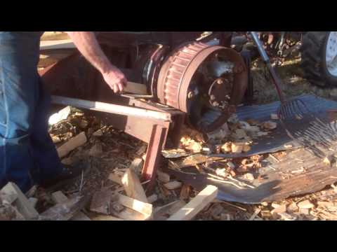

Once you split the wood as you mentioned you did above, how do you then chunk the portion that is to be used for the gasifier? I was under the impression that your wood chunker was good for use with long dimensional lumber only…not shorter split wood. Am I mistaken? I’ve been splitting wood as long as my splitter will take (around 24" or so) and then cutting those long split pieces with my chainsaw into chunks. It is time consuming but actually faster than chunking them with either my radial arm saw or miter saw. I do not have a chunker like you do because I don’t have access to dimensional lumber. If you can chunk these split pieces with it then maybe I will need to build one. Every time I see a picture of your piles of wood chunks I get jealous!
Hello John,
The wood that I put through the wood chunker comes from the saw mill and is a waste product. It is not dimensional wood but I will cut it down so it will fit in the chunker if needed.
If I have plenty of sawmill waste I will not cut any down or dead timber unless it is in my way. If I can’t get a few good boards out of the log it may not justify sawing on the mill. In this case I can chain saw the logs into fire wood lengths, spit and then chunk.
Some of the pics below show a hickory that was down and in my way.
HWWT

Load of scrap cut offs from a Amish run saw mill, 98 percent oak. I will be sizing and storing until I get my gassifier going again.
http://jamclasses.drbanjo.com/static/dimages/wood.JPG
Split wood ready to chunk.
Wayne,
How long would you say those splits are…about 2’? Any videos exist of you chunking these split pieces? Thank you.
Hello John,
Sorry but I will have to catch a video on the next batch. I chunked every piece of the spilt wood that I had. After it is split I try to chunk it pretty quick before it starts to dry.
Yes the splits are about two foot long.
Picture below.
The split pile is gone and the chuck pile is bigger.
HWWT
Good to know you can chunk pieces that short. I assume the longer the pieces the easier. I need to build a chunker…bad! Thanks for sharing.
Hello John,
I promised to make you a video the next opportunity of short wood chunking.
I can make a lot more speed with the long wood but sometime I need to chunk the short.
Working with the short wood make sure you are sober.
