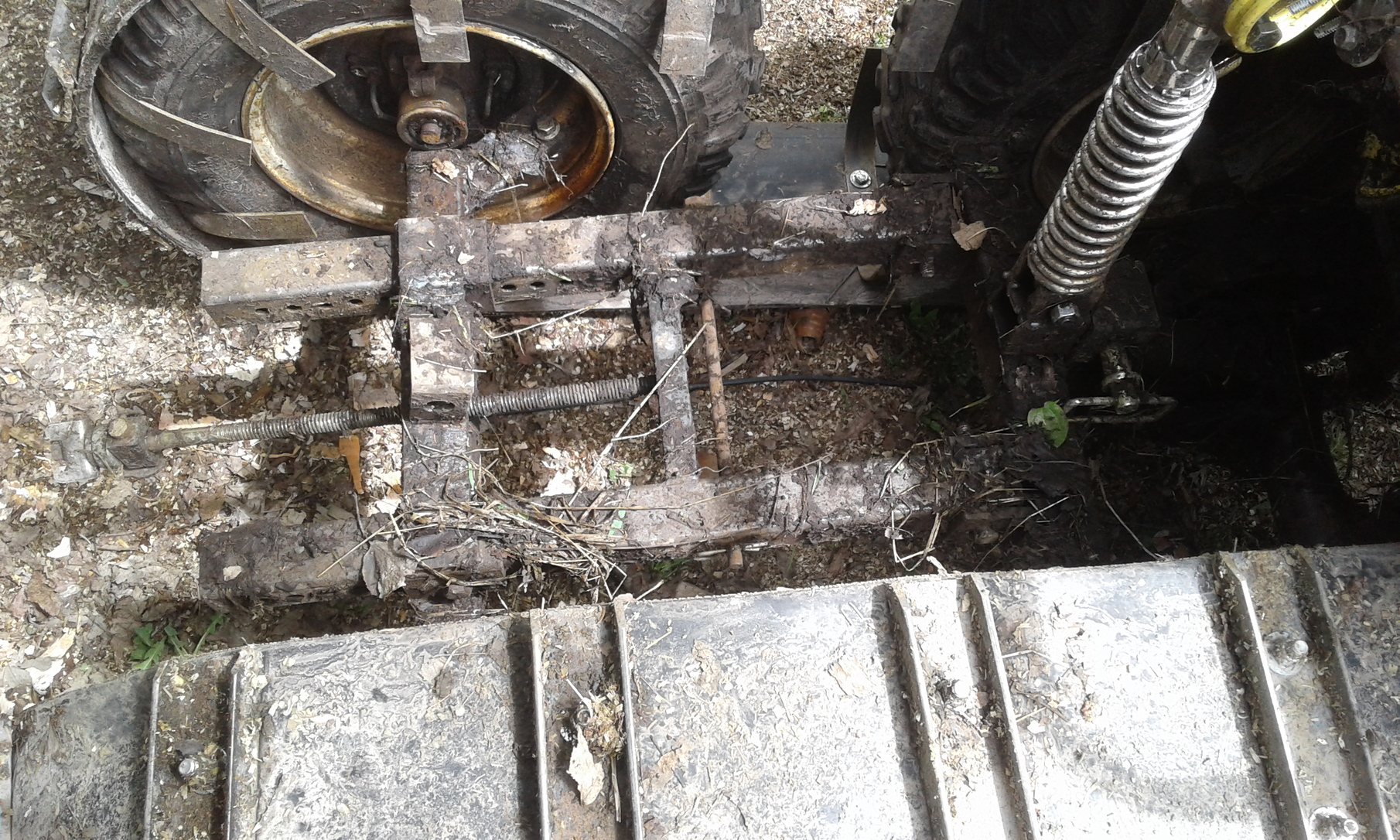

hauling wood last winter out of the forest when it was wet or snow/icy wasn’t working that well as I’d bog down or just plan spin out even with chains on all four tires on the quad. So I decided that I needed a set of tracks for the atv… but they wanted about 4x what the quad is worth! so in usual woodgasser fashion I made a set. I’m going to see how this works and maybe add the same idea of track to wrap the front tires as well.
Poor people have poor ways
Great idea Justin. You are smart and handy with all things. I want to see a video.:grinning:
That is an impressive build
Nice job Dustin hope that works out for ya.

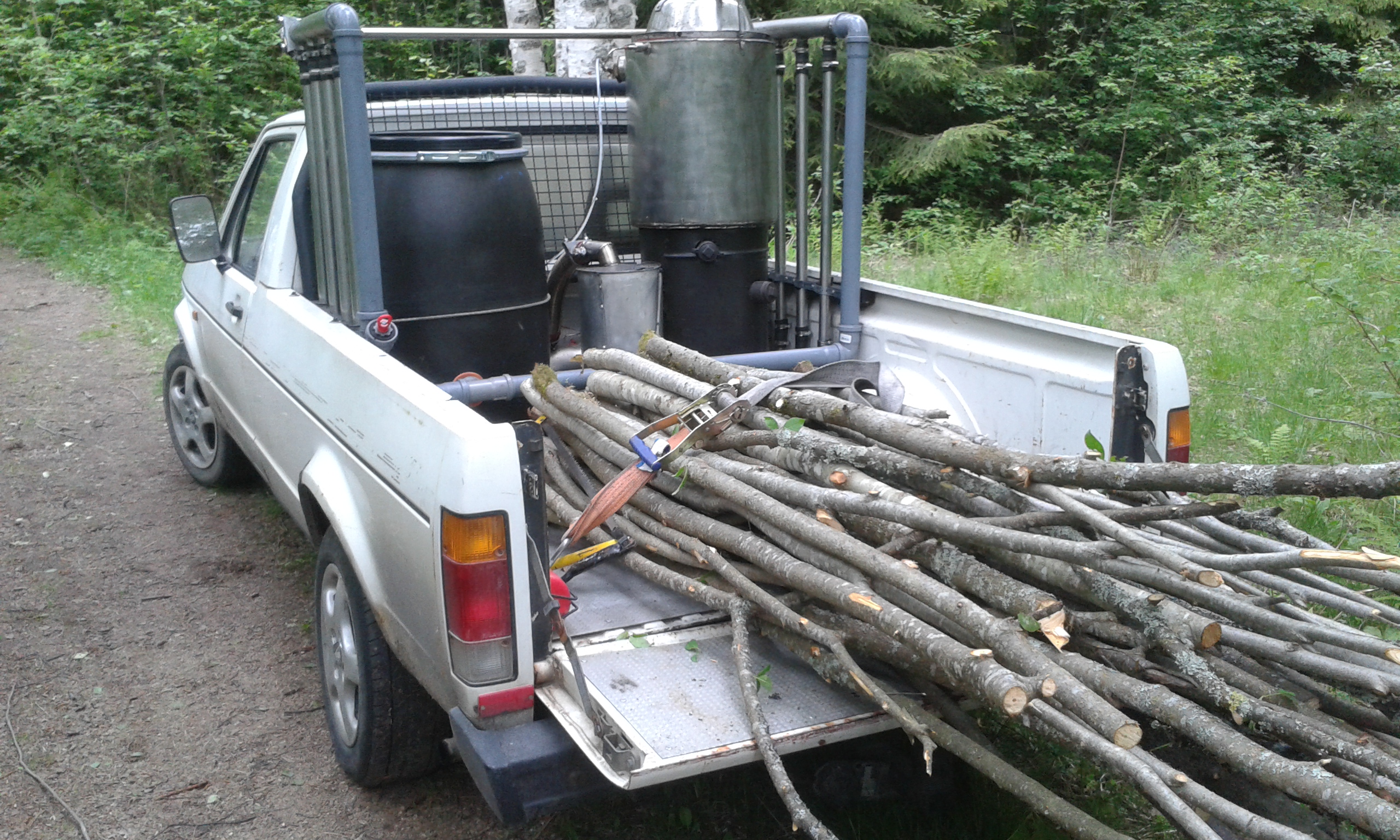

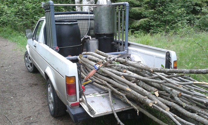

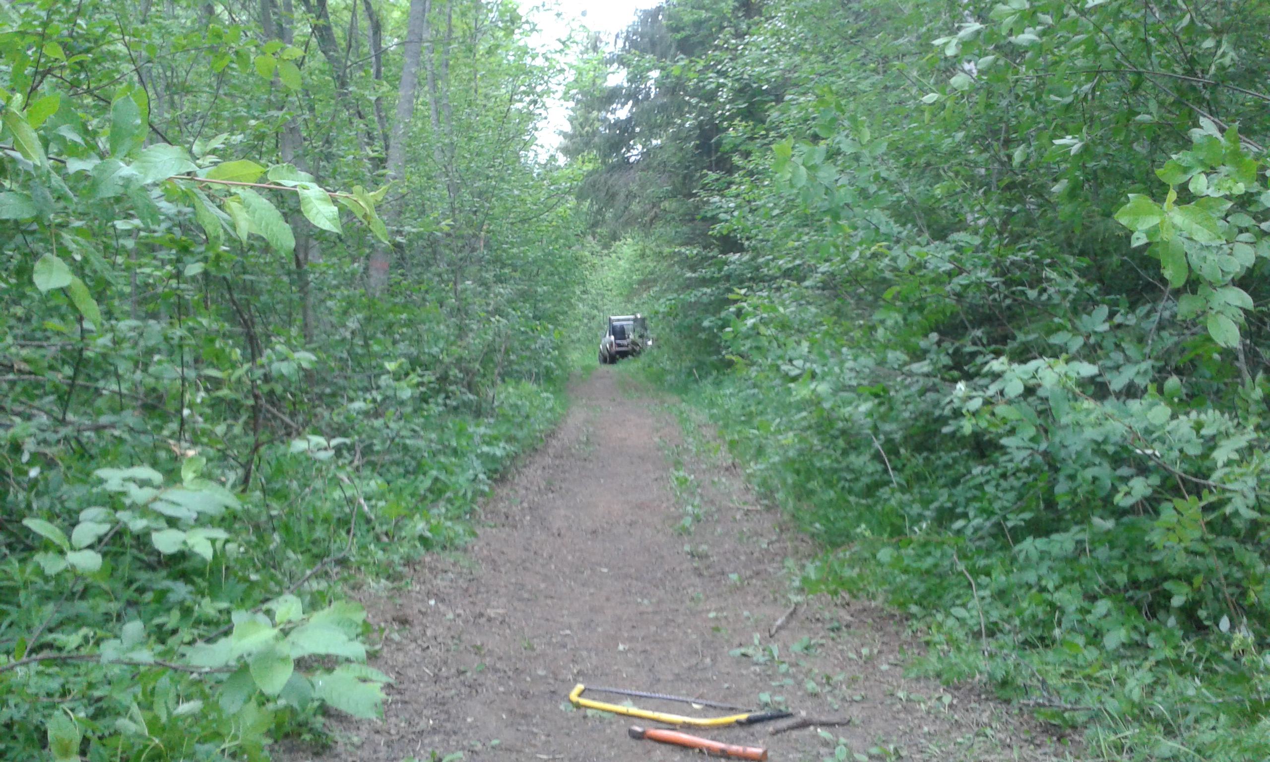

I’m not mot much of a church man, but I got as close to him as I can get by spending some time jn the woods. Brought bowsaw and hatchet and went clearing roads. By-product: Another 200 miles of motor fuel :grin:

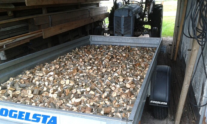

(I Don’t Need It but Wood Is Accumulating) :grin:
You just gotta love it…true happiness is a trailer full of chunked Rabbit food. Feeding the Rabbit, …even better!!
Looks like over 1000 miles in the trailer drying though size is hard too measure though the camera’s, your making me look late for dry wood. Finally warming up anyway. KEEP the Faith.
Same here dustin, hope it works with limited mods or tweeks, looks pretty good as is.

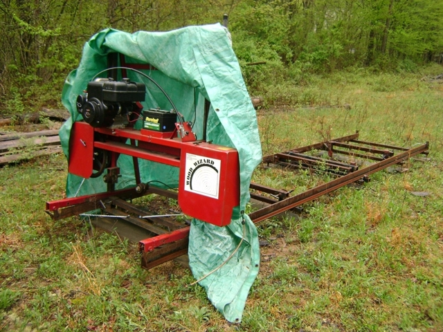

A gentleman nearby is giving me a good deal on this. Some cash and needs some dirt work done. It has 20’ rails with a small 10 hp Tecumseh electric start engine.
Another friend of mine here used to have a Hudson and wants to help me set this up.
I should include, this is the only picture I could find of what I bought. This is not the actual unit but is identical except mine has longer rails. I will post a picture when it’s set up.
BILL that Looks like a compack design, pretty good size mill , maybe we will get some detail design pics when time permits and you get it ironed out. hopefully. I like it freedom making lumber in Gods country.
Way to go Bill, You will enjoy making your own lumber. I just added 4’ of track to mine.

You lucky guy Bill. That looks just like the HB that a friend brought over and we cut up some 2x2’s from dead oak trees to chunk up for my truck. I looked them up and think they sell for about $3000 new. It did a great job He had added a water drip on the blade and learned how to sharpen the blades with a 4 inch angle grinder. He also cut a hole in the end of one of the guards, because certain woods threw off stringers that packed in the guard. You are going to collect so many toys that you won’t know what you want to play with each day TomC
Thanks all for sharing my excitement. Although this machine looks like work for many, it spells increased freedom for me. It will be added experience I can add to my life.
Yes Wayne, there won’t be any waste from the wood I cut. I can even use the saw dust for the chickens and compost.
Thanks Tom for the tip on using a 4" grinder. I like having toys that allow me to be productive and make my job easier. I seen a video of someone that had a hole cut in the guard to discharge the sawdust away from the carriage. Looks like a great idea.
