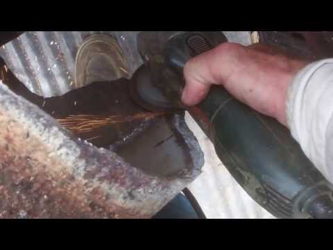

I hadn’t realized it but the chunker was pretty dull. After just a quick lick with the grinder it works like a hot knife through butter.

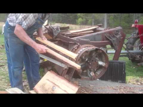

The son and I chunked wood yesterday afternoon and this morning. I think we added about a ton or more to the pile. (Green weight)
Chucker doing good!

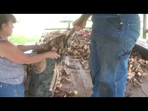

This video shows this afternoon bagging chunks that have been spread thin and in the dry for a few days.
