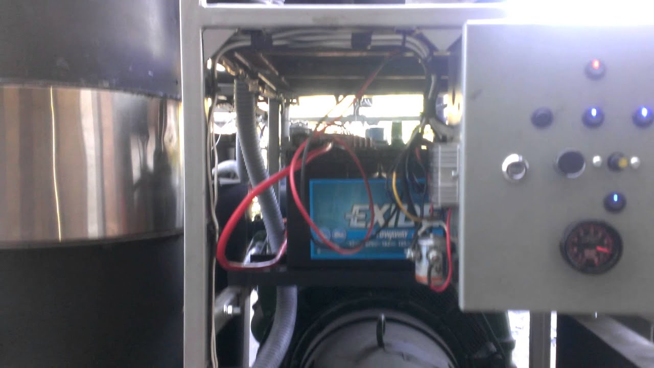

I dont know about the smaller Lister engines but the big ones are terribly inefficient. This machine in the video consumed this full hopper in just over an hour verses the V8 versions at the same output could go 4 hours on the same amount of fuel. A heavy rotating mass will aid with loading but that mass still takes energy to keep going. The cost to ship that thing was ridiculousness as well. It weighed twice what the V-8 machines. Big engines are not the way to with stationary systems. Much better to build teams with smaller engines that more easily to maintain and rebuild. Rebuilding a small engine is really not that big of a deal. Much better option than some heavy duty beast that will consume more fuel. That adds up in the end is by far less economical than refreshing a little Honda engine once a year. If you break the Lister or any large engine your going to be down for a long time and its going to cost you. Very complex and wood gas could care less how heavy duty an engine is, no engine is bullet proof here they all break. A small engine it breaks oh well, did you get your moneys worth? Most likely yes, just go get a new one.

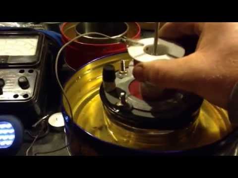

The stirling engine below runs on a single candle to make a little power. I’m in the middle of making a larger version of this for more power:

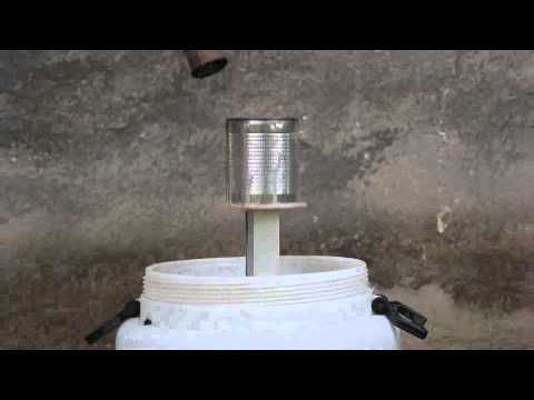

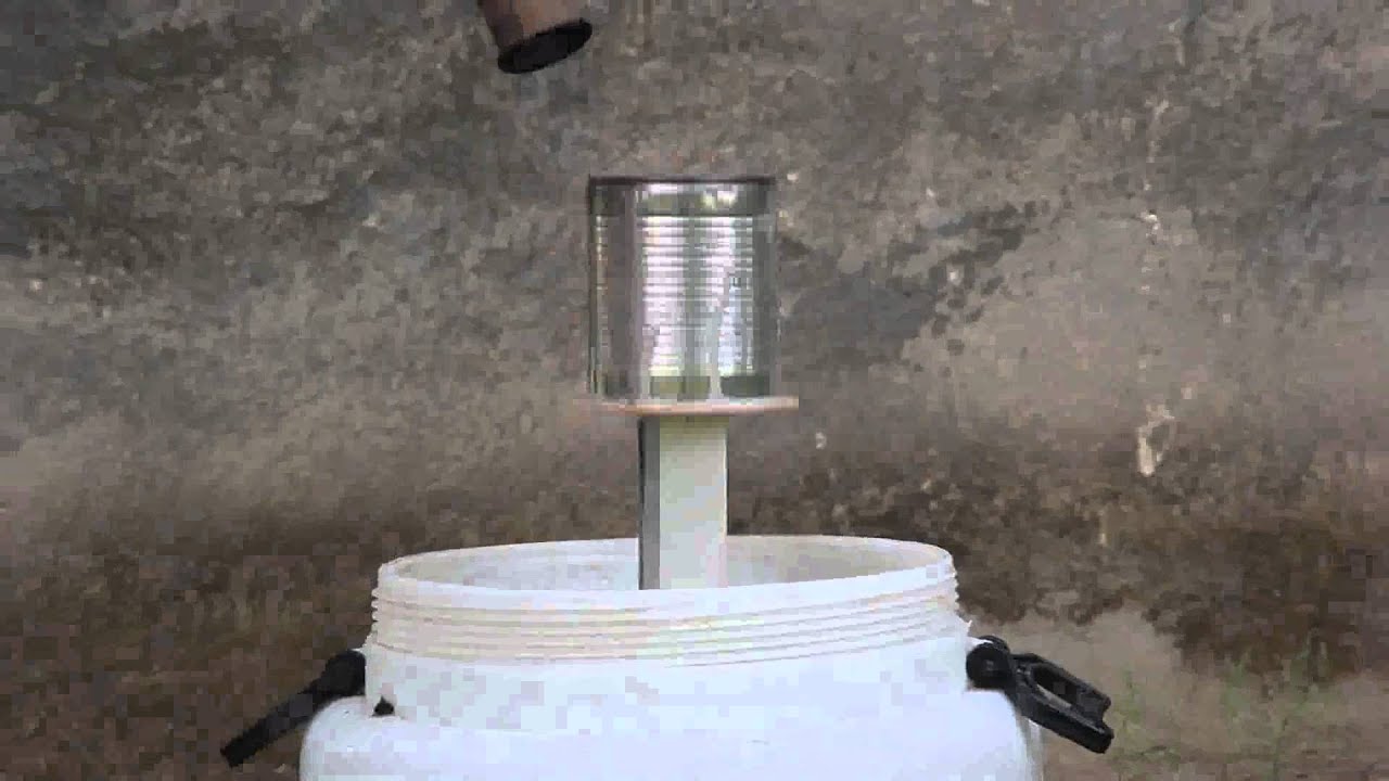

Also check out this simplest possible stirling engine that has NO moving parts other than the main power shaft:
And is explained at this link:
http://dedisoft.yolasite.com/water-piston-stirling-engines.php
Such simple engines are relatively easy to scale up since they have so few moving parts. You are right in that there is a gap between stirling engines having milliwatts of power and a few rare ones outputting 20 kilowatts, with nothing in the middle range which most people would want. If the one I’m tinkering with works well enough to produce 100 watts or more, I’d consider making them for a profit. I believe that lotsa survival types would be interested.

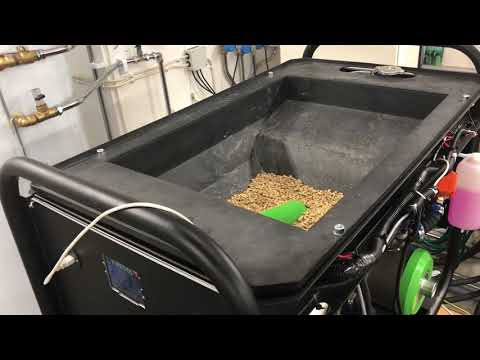

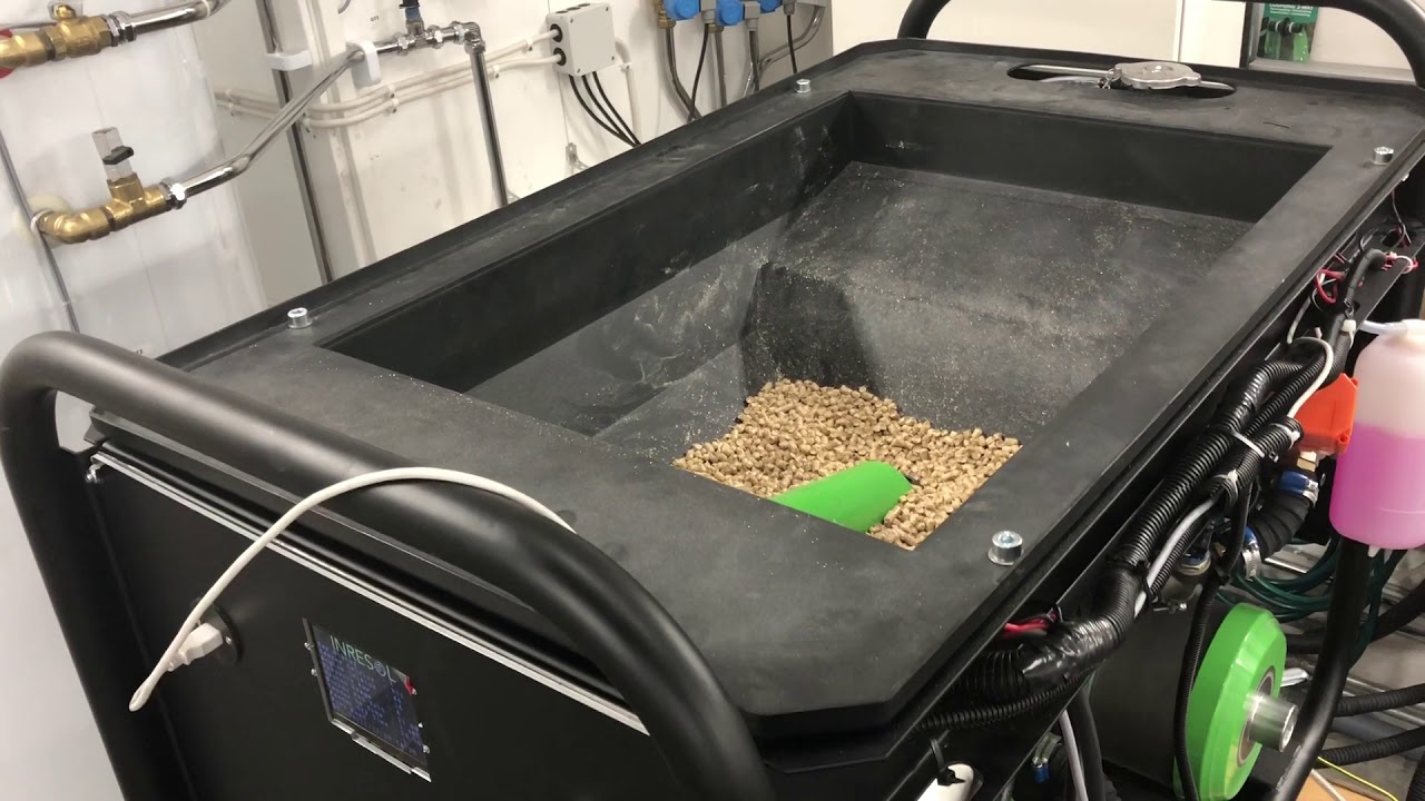

I found this interesting design based on a LTD stirling, but amped way up…

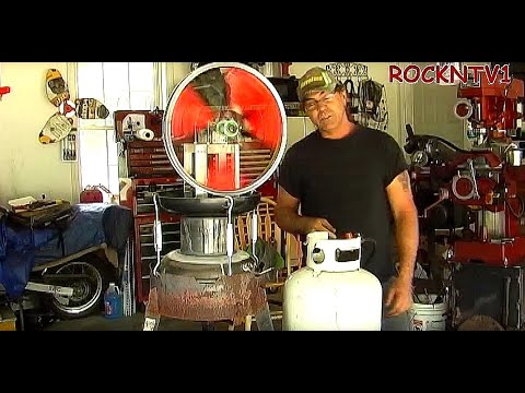

And this one I’ve been looking for more info for years. Seems to be a German design, they have / had a commercial model, the sunwell.
The top one looks more practical. The LTD (low temperature) models will never have practical efficiency due to Carnot’s law. The metronome stirlings have no piston rings, yet accomplish the same function using a rubber diaphram with a very high cycle rate. They also can tolerate high temps and use regenerators which improve their efficiencies.

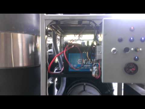

I had to dig into my email archives to find this; but these guys were very close to commercialization. I think this was a 5 kW machine.
There is a company in Michigan I believe that builds at this level as well. But they are more crude looking devices with a crazy price tag, sort of like my machines. :slight_smile:
