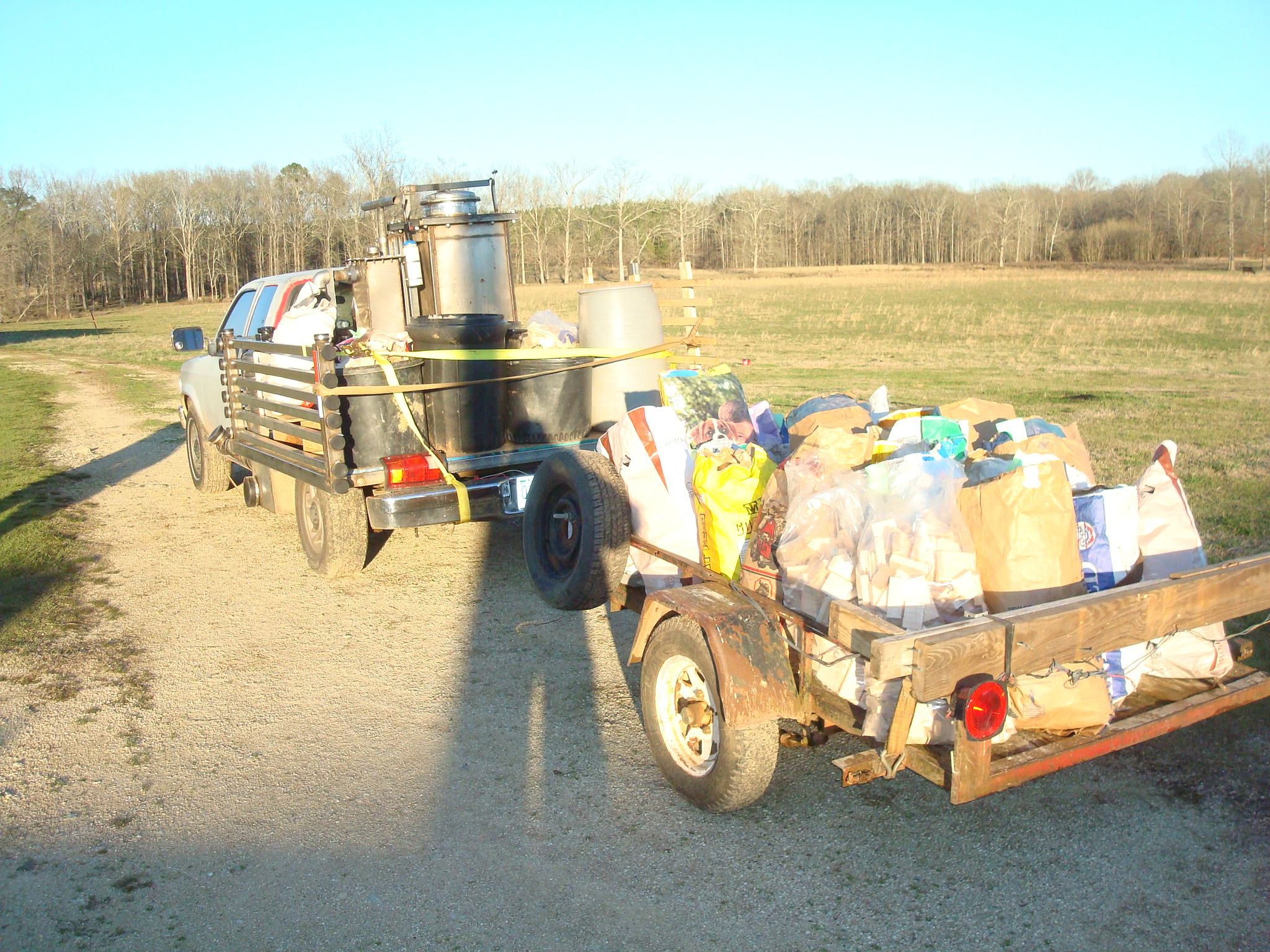

Nice looking Flat bed, i was thinking of building a flat bed for my old chevy around a wood chunk ? chip processor. Kevin michigan man.
Good evening wayne is this jakobs dakota.? photo is blurred a bit on my end.
Yes Kevin .
The above flat bed dakota and trailer is Jakobs.
Thanks for reply, WAYNE thats a nice looking dakota flat bed fuel processor.
Wayne,got any idea about how far that much wood will take him?
Hello Glenn.
I think I should let Jakob answer that question on his truck and wood.
I know on my dakotas I usually plan on 1 1/4 mile per pound of wood if driving normal road speeds .
With hauling that 1,600 lbs of wood I have been getting 1.3 pound per mile empty if I don’t push it to hard I get almost a pound per mile. Empty I run 65 - 70 mph 1600 lbs loaded I run 45 - 65 mph. I am hoping to get about 1200 miles out of that amount of wood.
