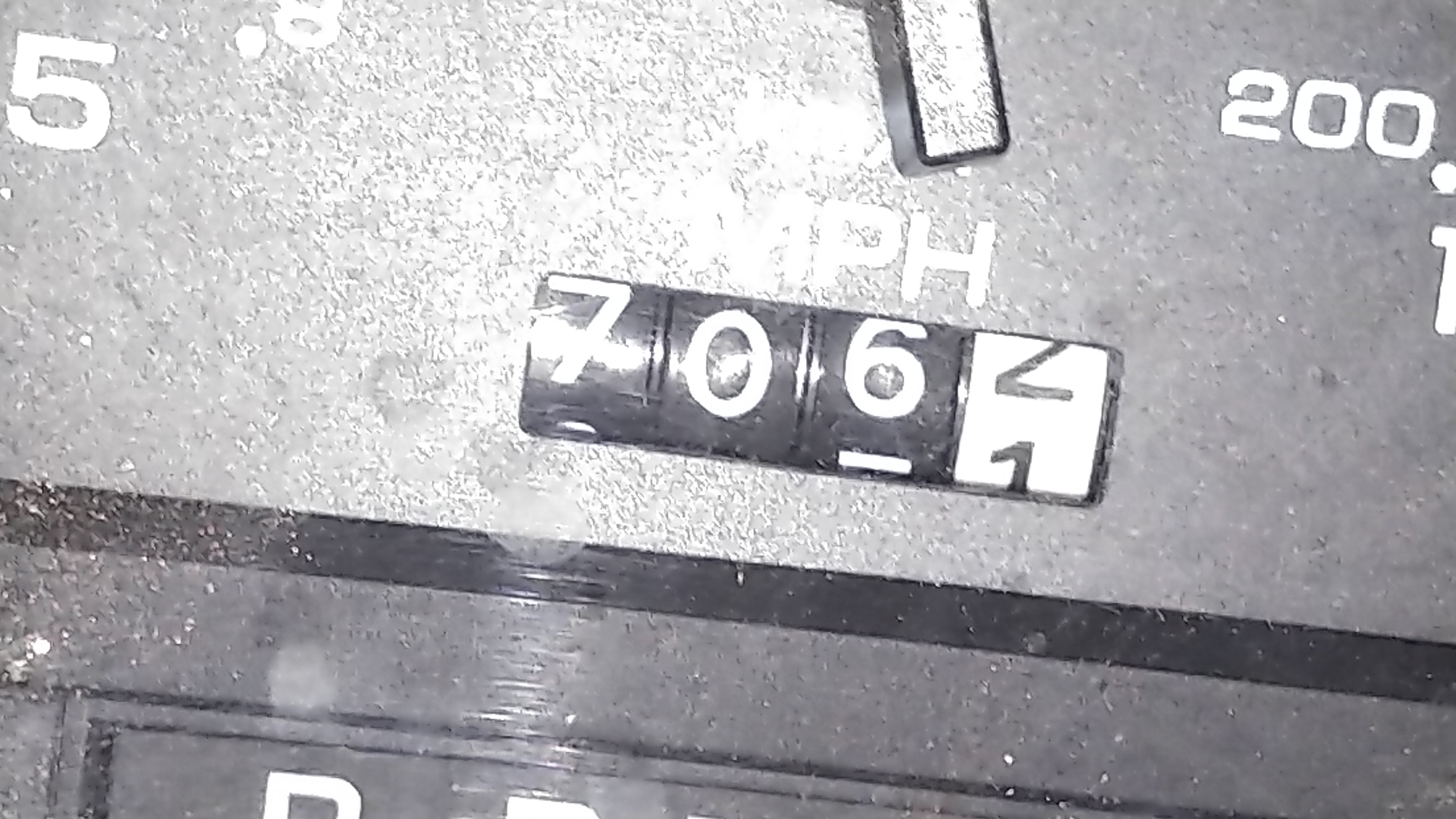

Looks like it will end up just under 900 miles. We won’t know final wood numbers until after sleep. But the initial numbers we had I think worked out to 1.17 pounds per mile. The entire trip is going to end up being 24 hours 20 minutes. From home to the Atlantic ocean at Atlantic Beach east of Jacksonville Florida to the gulf of Mexico West and South of Perry Florida, then to the gulf at the top of appillachicola Bay at St Marks Florida to Dothan Alabama through Auburn/Opelika Alabama and back home. Lots of fun, but time to sleep. 16 more miles
We made it home. Turns out it was 901.4 miles. 24 hrs & 24 minutes
