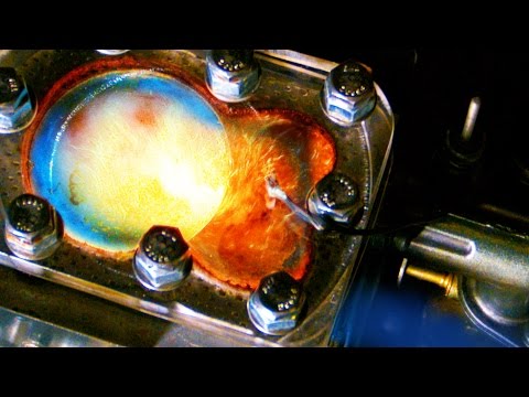

Clear view see-in cylinder video by a Chris N on youtube.
Search for his channel on youtube for this short video.
Second video Must have been a video about a Lada.
One of you guys needs to make a see through head like that and run WG. I’d like to see Methanol and then Methanol with WG.
No TomH, no Lada’s or any other weird obscere like an early 60’s Renault Dalphine.
Chris N’s video came up on a running see thru videos youtube search.
It is a single cylinder, overhead valves head thru-studs clamped down over his clear view cylinder onto some kind of crankcase lower end.
It shows on gasoline how far down the pressurizing/heat-making visible flame front travels down the cylinder, piston pushing.

The engine with plexy glass head is running very rich.
Have a look here, I can not tell you what the mixture ratio is but I can tell you its right.
it does turn a little orange when the throttle closes and the high vac draws in extra fuel.
Its very hard to compare one kind of fuel to another unless you are going to actually tune it.
You guys should watch Ebay for a Gunson colourtune.
Its fun to play with but its not meant for an engine thats running under load
Just for quick tinker as you see here ( and even this is pushing the heat tolerance of the tool)
True he is running gasoline rich, alright Wallace. You can even see the some the liquid gasoline? oil? splashing.
I think this is intentional on his part to keep the heats low for the longest filmable time on his plastic cylinder.
Yes very true on the Colortune tool. I found it only useful for unloaded idle mix adjusting. Found it actually useful for cylinders balance comparing due to intake distribution problems. Or single cylinder poor combusting due valves leakage, coolant into that cylinder; or even an oil pumping cylinder. Grrr. Single cylinder getting oil drowned from an old hardened SOHC valve seal getting jammed cracked from cam-in wedging out top of bucket the older style of adjusting shims.
Yeah. Loaded mix adjusting you use spark plug coloring, heat gauges watching. Your ears. And you can even educate your nose.
