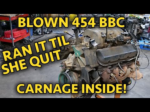

Here is a new teardown video that makes an argument FOR bigger is better when woodgasing. A fully modernized Chevrolet/GMC 454 cid 7.4L big block all cast iron V-8.
By the last years used in 96-99 in heavy pickups, trucks, Suburban’s and commercial step-vans these are still available. And even though not as Big, Big as the 8.0L Dodge V-10’s; well Chevy 1st, last, and always fans, you have an excellent option. NOBODY’s built up small block will touch this for grunt pulling power. And in my not-so-humble opinion for a pulling power engine you will never make the earlier carbureted version match the factory fully converted to SEFI. Never; ever.
Look at the flow of those cast iron factory exhausts.
Look at that intake and in-heads flow porting.
I only ever had to do ignition tune ups on these. Not bad with the spark plugs above the exhaust manifolds. Look Ma. Even highly abused, this 454 had no LS/LT-like; and Ford V-10 heat cycled broken exhaust manifold bolts.
I did have to do a couple of upper intake removals and gasket change outs for vacuum leaks. Never a problem with lower intake to heads. Or blown head gaskets.
These later model flat cap GM ignition systems in both the big blocks and small block have 40-60K miles failure rates on the cap to ignition coil wire. Have a spare! These later model GM ignition systems WILL NOT fire-dry, fuel wetted spark plugs. The wet shorted individual plugs are PCM sensed and ignition to these cylinders is shut down by the PCM. Have to pullout the spark plugs and super dry, or replace the spark plugs, just because the coil wire insulation broke down. Prevalent problem out here in the wet, wet, road spray.
Enjoy

I’ve seen a few blown engines. Bent rods, holes in the tops of pistons. Cranks gouged from bearing failure, but I cannot imagine what went on for one cylinder to explode. This certainly wasn’t a driving down the road at 2500 RPM issue. And that intake system. Did they design that for the space shuttle? Happy to be a automotive troglodyte.
