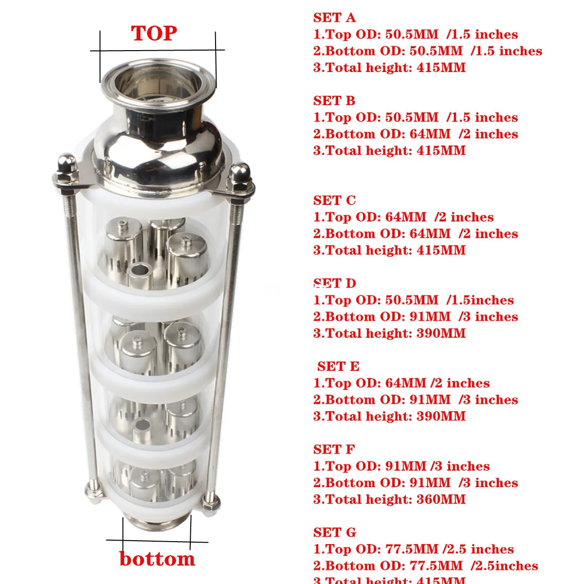

So it’s a pot still. The copper tubing is a condenser or worm. The thumper keg, or barrel is attached at the end of the worm to separate the water from the alcohol (ethanol). This is how straight run stills are plumbed to make them behave like distillation columns.
You know you can buy bubble cap distillation columns on AliExpress? I laughed so had when I saw that.
US $138.00 | copper bubble Distillation column with 4 sections for distiller Glass column
Remember you can push a lot of the alcohol into the worm@ 160f but to get it out of the worm you need to go a lot hotter.
I would run all the wood through the pot. Save each run separately, then take your best runs and put them through together.
