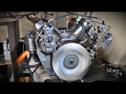

Hey BruceJ, my Harbor Freight engine lusting is for thier affordable, modifiable V-Twin engine. I love to woodgas aircooled V-Twins.
I’m pretty sure everybody here can search and find things on the site better than me. I’m as guilty as anyone of thread drift but I would have liked all nozzle posts in one place and all filter posts in one place, ect. Anyway this is somewhat back to the point here. New Road Kill Garage. Just seeing how well a 4x4 chevy 350 carbed work truck matched up with a 4x4 V-10 work truck. No advantage to either and the Chevy had a Turbo 350 while the Dodge had a 5 speed manual.
As he states there is now lots of performance parts modifications available.
Sigh. I winched when he did reassembly with power tools. He should be hands-feel-training himself.
And if you watch trough, I cringed him reaching across the open flywheel fan to start it up.
Then later Rev-testing this obviously is not mounted down engine. Watching tools and the table cover bouncing and bunching up close to being open fan wanting to eat.
So true . . . “Youth is wasted on the Young”.
I was once young and Dumb too.
Got the scars from it.

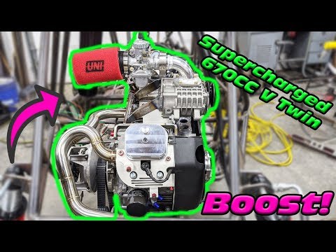

Here’s a Supercharged 670 V Twin as well. Single Mikuni carburetor.
You can buy these little Roots superchargers for cheap. They sell one big enough for my Mazda… Very tempting… I have an AC compressor location freed up just to fit one…
Cody,
Thanks this looks interesting for Experiments with gas, that shall not be named.
I would need to reconfigure the entire intake manifold. I don’t think the Weber 32/36 is blow through friendly. But if I went total woodgas then it could be blow through I think, with just a simple butterfly throttle body.

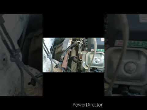

Another rabbit hole of mine Steve, small engine swapped mud trucks…https://youtube.com/playlist?list=PLPxeX_PfK7n3Mu2lNl7Et1H8vfVV-2EMQ full playlist of single cylinder predator swapped trucks
I have not played with the v motors yet. Been following vasily builds for years, yes many young man mistakes. But, even still can learn from him. He played that motor into turbo charging as Bruce and Cody talked about, I don’t recall the arrangement being fantastic. But if one was so Inclined, simplicity of these predator motors I think would be ideal for bolt on and check power/torque on wood/char gas. Easy to work on, easy to get parts for, reasonably priced. This then maybe morphed into forced induction woodgas performance testing. All done at the bench, or maybe a small go cart like vasily used. Noticable gains and losses can be felt easily with something as simple as a timed drag race, a weighted towing test, or taken to a Dyno small engine shop as here with the grind hard boys
https://youtu.be/SmsQZlBiH38
This is mine…
