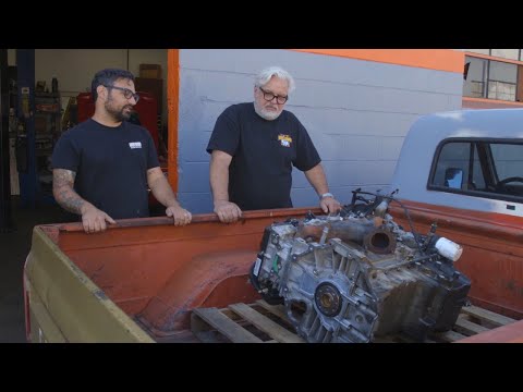

This is just a preview of a Hot Rod Garage show where they build a GM Vortec 4200 to compete with the boosted Barra. HRG is the best build show on TV. In the end they dyno their GM to match the Barra numbers.
Those 4.2 can be a ROWDY motor, guy up in Tacoma has one in a all wheel drive Chevy trailblazer twin turbo don’t recall exact numbers but he broke out at the drags sub 8 seconds and got kicked off the track. 900+ horsepower. I have watched those motors be extremely reliable, for Chevy standards several over 400,000 miles and still ticking. My only gripe is the front differential, bolted to the oil pan with pass through axle shaft. Just can’t like that design, but they made it fit in a midsize suv and that’s what they had to do. Decent mpg, stupid easy water pump! Remove serp belt 2 bolts and it’s off. When I was paid flat rate I really liked that!! Minor issue with cam sensors, easy fix. I seem to recall an egr/ vvti sensor issue, but it has been to many years to call my memory solid on it? Might have been the inline five, I don’t remember now
