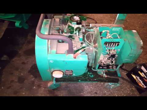

This will work. I even know good documentation of two of these Onan opposed and one Briggs and Stratton opposed being wood gassed successfully too.
On the south of me town road I have been watching for years and old set-aside motorhome with a missing generator compartment cover. One of these is factory stuffed in there. For sure buyable cheap. Ha! Ha! They’d want me to remove the whole motorhome, likely. Wife would kill me dragging that home.
Great gerator units alright.

Yup, Wallace you and I could with just a VOM and time sort out the Onan system. Only some have this capability.
