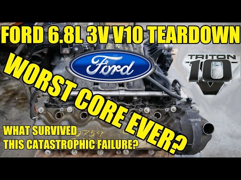

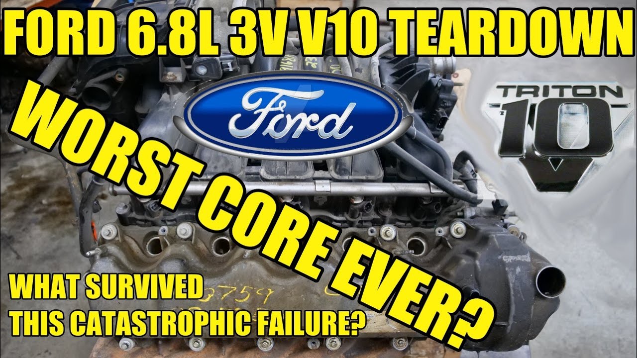

Well fellows, here’s Steve Unruh posting up corrections about being 80% wrong.
Previosly I posted up the far too many internal monkey motion design flaws in the Ford V-10 truck engines.
I was correct about the 30 cam follower fingers. Everything else was tweeky memory listing off the DOHC V-8’s Triton problems.
Here’s the real deal V-10:
Looks to be a lot related to the previous widely used 4.6L single overhead cam V-8’s.
Considered by many to be a very reliable long lived engine. The cop and taxi car engines.
Ha! Given a choice to still be able to get a short chain driven, cam-in-block, push rod actuated, 2-valve large displacement engine that’s where my money went. What I’d recommend Any to woodgas instead.
Wow. I’ve seen engines with the whole bottom of the block detonated and they were in better shape than that. Freeze plugs looked good though. Low oil doesn’t explain all that damage to me. Makes a good case for forged rods though.

Hehehe … Very entertaining video. As the past of several shops exhaust guy and much playtime with the triton line I was immediately drawn eyeballs to all the broken exhaust studs he never mentioned. Painfully hours. Triton sparkplugs. More painfully hours. I like how even knowing full well the motor was not savable he still tore down in reverse of torque sequence, shows he knows what he is doing.
This is how I imagine the conversation went
Phone call 1
Worker: Hey boss, I’m halfway to the job sight and the oil pressure light just came on, do you still want me to drop off the excavator?
Boss: ya it’s been doing that lately, it will be fine
Phone call 2
Hey boss man, this thing is making some terrible noises
Don’t worry, it’s a Ford
Phone call 3
Hey boss it’s knocking and low on power
Just get the machine to the job and stop calling me
Text message
Hey boss, machine is at the sight, had to track it three miles down the interstate to get it there. Truck and trailer are on the side of the road, I quit.
That is a product of shear abuse, there are thousands of Fords around here from gas drilling companies with hundreds of thousands miles on them. I am not a fan of any of these modular engines, but they work well if properly maintained.
I actually agree with you Al F.
On that guys, I Do Cars, channel he has now hundreds of videos of every kind of modern larger output power IC engines died from lack of oil changed. Or using crap-cheap oil, or oil filters.
Then also very oils done well, internally clean engines with that designs bad-luck pattern failures. Dodge Hemi’s with dropped valve seats. Dodges, GM and Fords with too many commanded cylinder deactivation systems that past 80K-120K have killed engines. On all of the light duty pickup’s. NOT installed on the HD working trucks.
Still . . . Marcus and I are speaking from the stand point of the working mechanics had to in-vehicle replace the heats cycled broken off exhausts stud and bolts so’s the truck would quit coding out for “I think I have a Cat performance problem”. And the far to many deep down long narrow hole stripped spark plug having to repair in place attempts. After the first guy, 2nd guy, was just trying to do normal spark plug services. NO CHOICE. You have to apply the force needed to 70K-120K get them out. Now do that being the 2nd guy After someone eles’s thread repair JOB! Sorry. Sorry. Mr Truck owner. New cylinder head time now. And oh by the way, goona’ need the third generation upgraded parts in the cam phasers, oil control valves, and 8x3=24 in cam follower’s fingers too. Hmmm. New cams too to go with those new fingers you know.
The previous generations Fords V-8 engines had none of these.
View; Ford Miklado Tech: The Car Wizard (bad name hung by his wife); Main Street Repair and see all of this.
Wanna Ford HD pick up? Go old. Pre-Trident gas rigs.
Go with the diesel. Invest the time and $'s to learn that.
Little Sister knows I’ll give her no time on her Ford F150 dual turbo Eco-Boosts. (except install one of the three ways found to all-the-time, deactivate her annoying Stop-Start system.)
