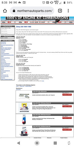

What is the easiest engine to modify? Which engine is cheapest to get parts for nowadays?
Non-LS or LT Small block chevy, by far. Especially for cheapest parts. Easiest to modify only because of the incredible number of aftermarket parts manufactured.
I always ordered from these guys in the nineties
