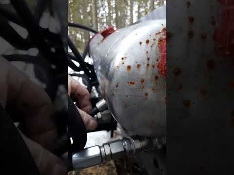

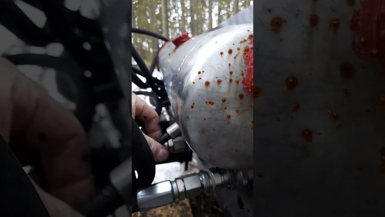

I got an urge to do some with the gasifier this evening, and away it went, started cutting the gasifier between hopper and hearth. (Felt a little ashamed to cut into this artifact)
Ofcourse, when half-way, my angle grinder got a leak, and all the magic smoke escaped, just when it started feel warm and cosy to hold…
I had no electric-smoke refill at home, so i had to fetch grandpa-angle grinder, this old beast has no soft-start mumbo-jumbo, i can see the neighbours lights flicker when i pull the trigger.
So… cut it open, good it’s payday tomorrow, going to buy an extra angle-grinder, i use to have three, but have been a little penny-wise lately, or just to lazy to go buy one.

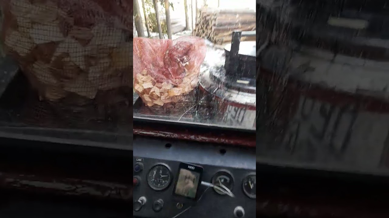

About 8-9 hours of driving with the Illerm, the gas enters on the underside of the foam rubber and out on the upper side, and into the carburettor.
A total of about 50 hours of driving in the forrest.
