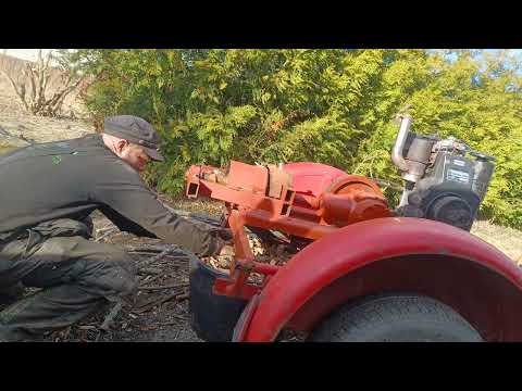

Ran some pallet wood through the chunker.
It really squeeks when chunking dry wood.
Greetings Goran , uff, dry wood causes problems, and not only for screw chippers, but also knife chippers have problems with dry wood, especially if the wood is oak, cherry, chestnut,
 The Remet R120 knife chipper (which is supposed to cut up to 120 mm thick) can cut (with difficulty) hard dry wood up to 30 mm, anything more is impossible to cut, with the R80 screw chipper it is similar. (I mean the thickness of the wooden pieces that are created when trimming boards). With a knife chipper, the problem arises with the cutting angle, when the knives start to cut into the hard surface of the wood, which is too large for thicker wood, so the knives literally only squeeze the wood sideways and the chipper stops instantly. With a screw chipper, there is a lot of friction when the blade cuts into hard wood, but this can be reduced somewhat by “lubricating” it with water.

Another video of the chunker, sorry, only in Swedish, but i don’t say anything interesting.
