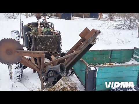

Thank you Rindert, nice video, a scary contraption with the circular saw blade though.

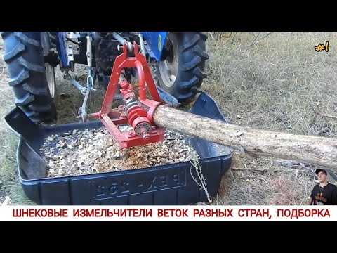

This just popped up in recommend to view after watching Rindert’s
find:
A collection of systems.
View on YouTube and his Ukrainian translates well into English.
May be finishing ideas for you GoranK.
