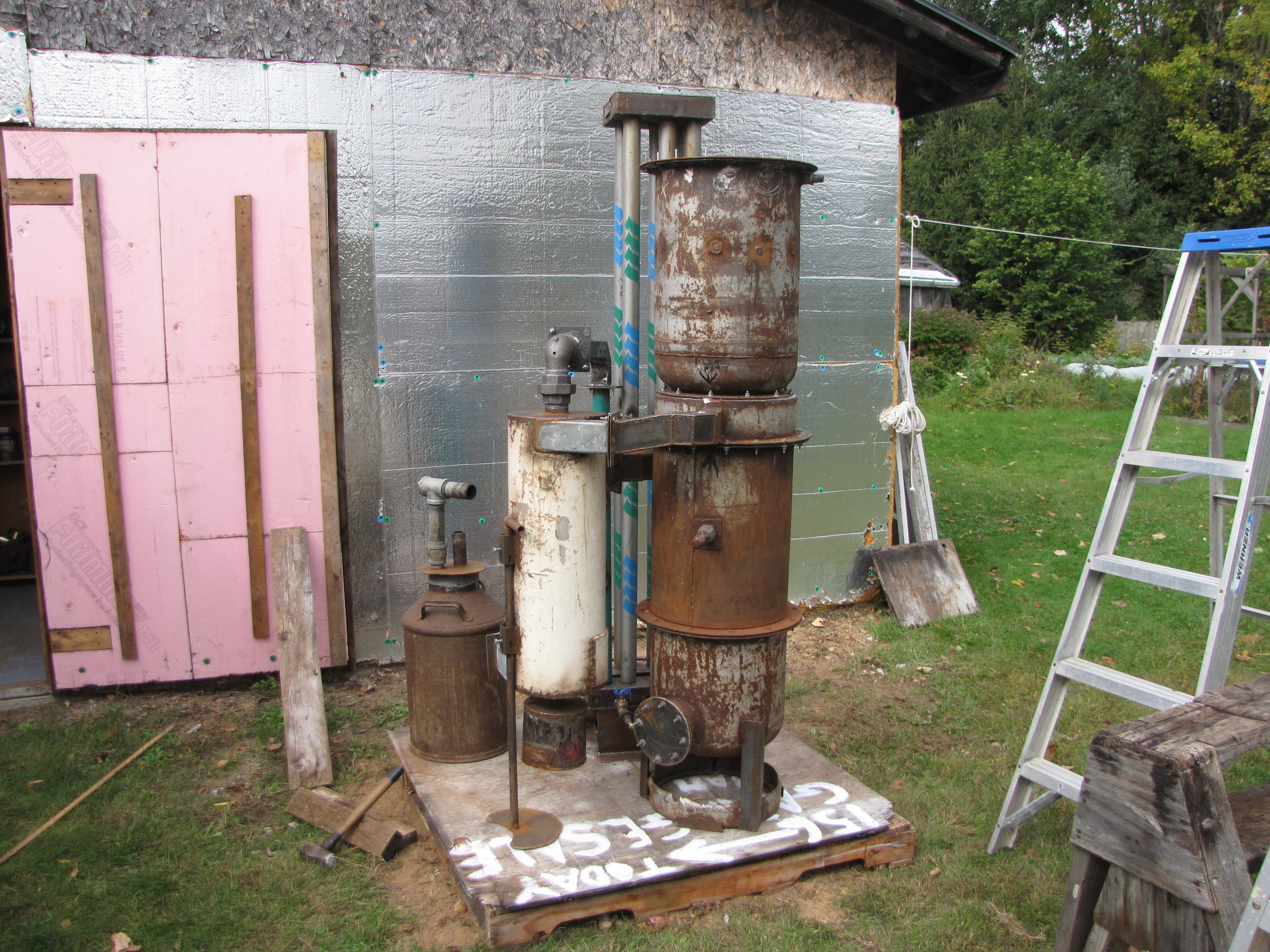

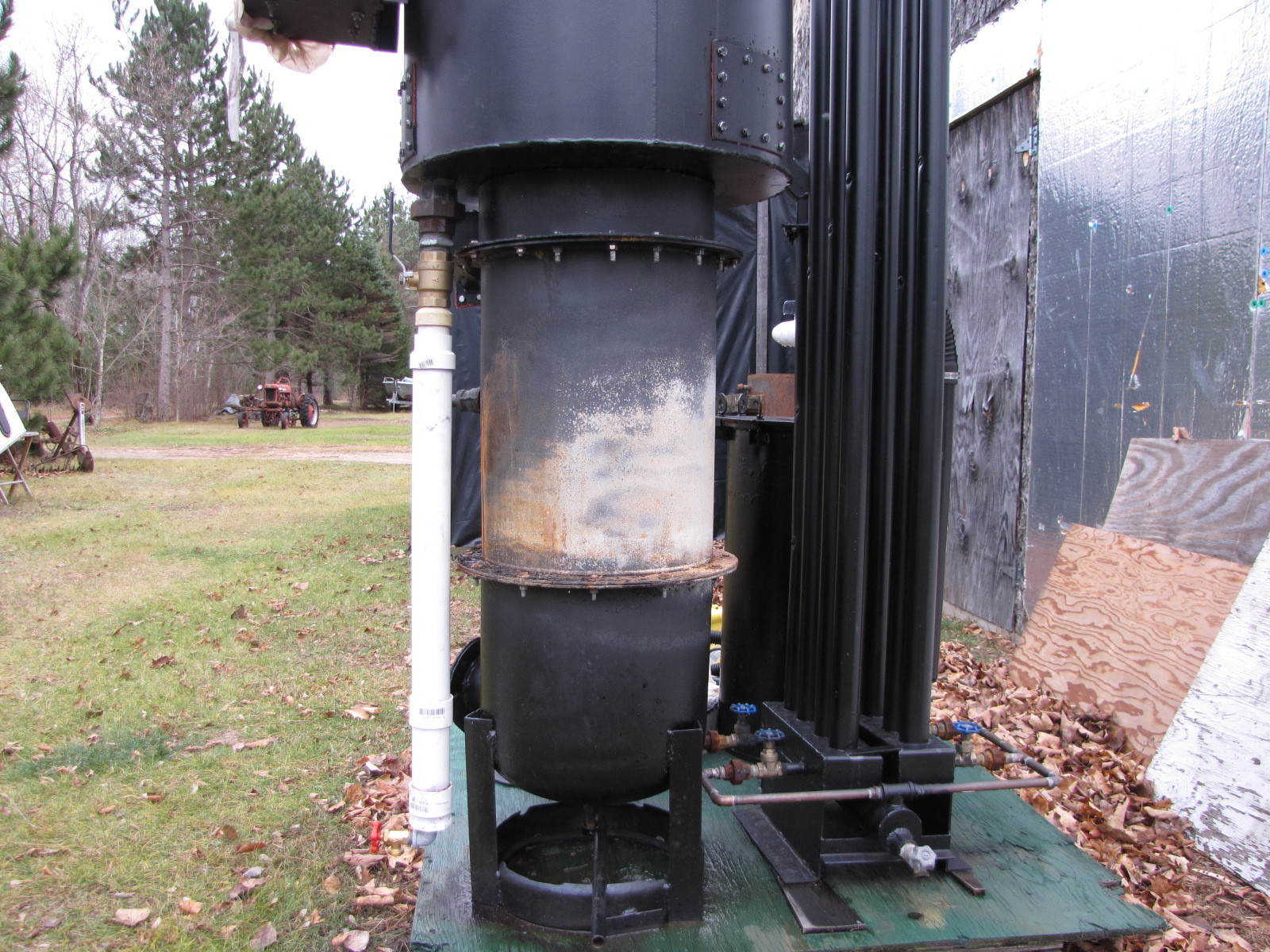

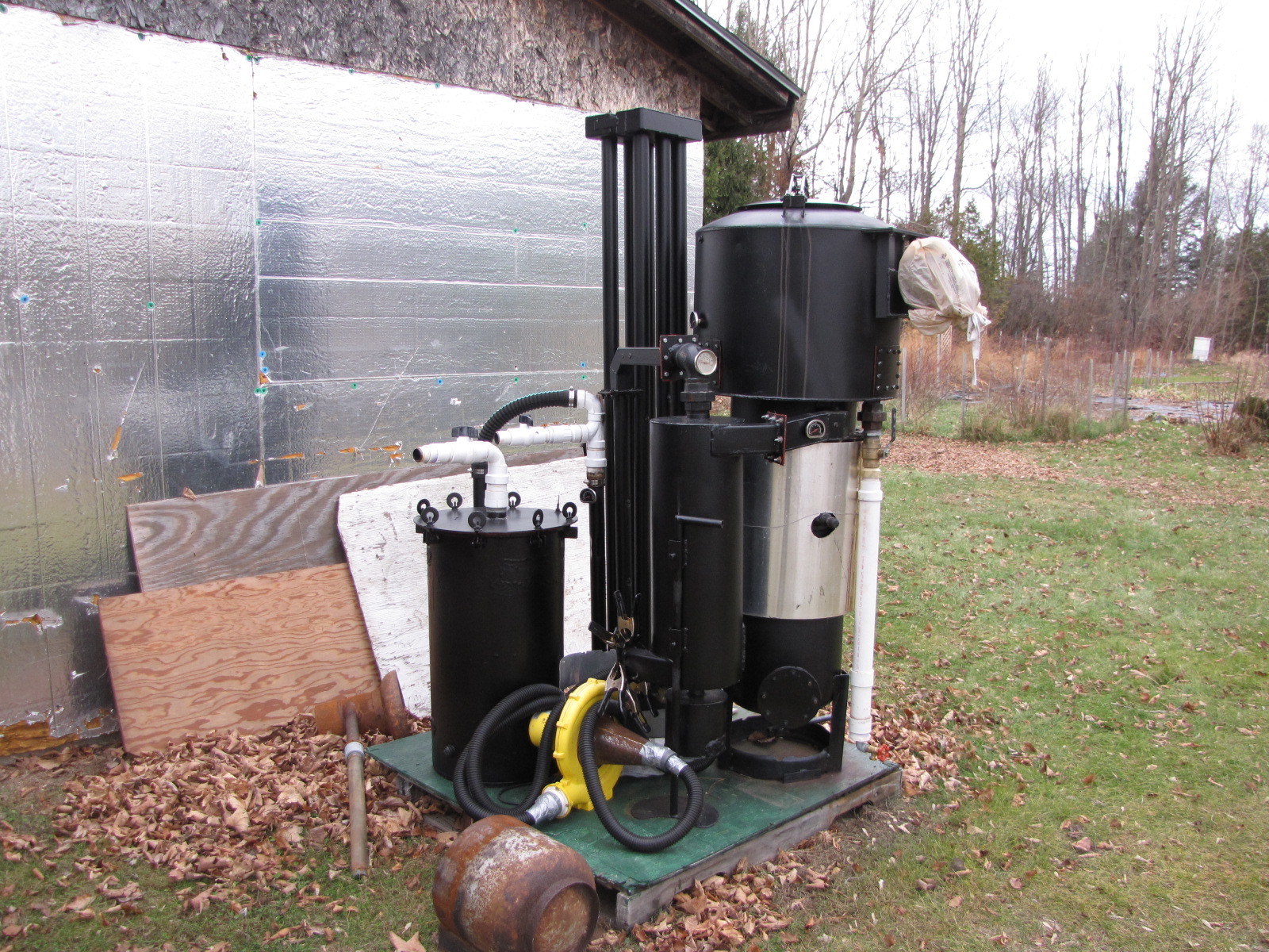

Here’s my unit in the spring of 2014. I sanded everything I could reach and sprayed on 2 coats of Rustoleum Low sheen. The middle pic is current condition and the last pic shows the hearth area under the aluminum heat retaining shroud. I couldn’t ask for better performance. No primer was used! It wasn’t that expensive, but we’re not talking price are we.
