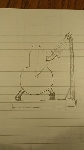

Does anyone have a tip wich kind of flex exhaust to buy? This piece is airtight but not to flex, everything started dancing again.
If you are trying to figure out in which direction the vibrations are being transmitted and change the installation location as close to the engine as possible, you are now far away. Attach the outlet to the base.
https://www.walmart.com/ip/Walker-Exhaust-51110-Exhaust-Flex-Connector/109100408
The second one is the same bellows formed solid pipe section. The added outer woven SS layer is for under vehicle safety.
European these are automotive used too. Use what is most common available cheapest. Favor one with flanges for easy replacements. Vibrations and time; and these will eventually crack and leak.
The spiral wound formed exhaust flex-piping joints wears quickly in vibrations applications and leaks throughout.
Thanks Mr Steve, I tought I heard that before from you, now I am sure. The easiest is not always the best.
Just bought some exhaust seal in plate form. Didnt know that exists. Flanges are no problem. It takes longer to sketch them then plasma cut.
I think that would be best …
:thinking::roll_eyes:
Wow, good idea. It has to go up anyway.
