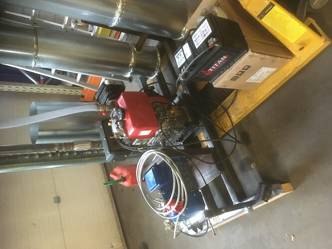

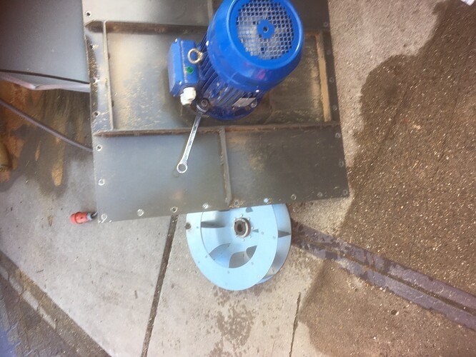

Everything is new for me. From woodgas to generators to batteries etc. The wheel is tacked, maybe weld it. Concrete is quite heavy, lead is expensive, any advise?
Last time I saw 10 A on amp meter and 3 kW on power meter. Amp should be 6 A, the flywheel should correct this. Wheel is scrap from an installation update. Waste to throw way and fits nicely.
Tone triggered me to play with the dieselpump and governor. Good enough to try and see what the compr ratio does to woodgas.
Hi Joep, what if you use a flywheel from a waste engine from a car, it is nicely balanced and there are unlimited quantities of them …

Ok, maybe skip the flywheel. It doesnt bother me. The fan just fits nice, thats all. Balancing is no problem, I do that all the time. Filling the wheel and let it spin 3000 rpm without breaking is.

Joep, Could you make a flywheel out of laminated plates, cut with CNC plasma machine? Steel would hold together at 1500 / 3000 RPM, plates would not have to be matching thickness, not too hard to balance? Add bolted together plates until it works as you wish. :thinking: not the worst idea ever!!

And another one for the srapyard. Not the wheel but the motor is coming home this time. 5,5 kW 50 Hz.

Thanks, Tone. I had a not satisfying weekend, nothing to show. Found a little leak in the exhaust, smelly mess. Really rethinking about putting this thing inside a building. Tried the gasifier but clogged, then to satisfy my feeling started the TLUD and that one also gave a bad start. Did some weighting. 35 kg wood in. 4 kg charcoal out. I think it burned to long, that can do much better. I calculated to kWh, simply because that is the electricity counted for. And it is an easy calculation. Wood is around 4 kWh/kg and charcoal around 8 kWh/kg. Check, double check to btu, joules etc , thanks Matt. That means I put in 140 kWh and get 40 kWh out in charcoal. I little disappointing, but I see thos numbers on other places also, around 30%. Important to use that energy or convert wood to shaftpower direct.
But anyway, you mentioned pump and governor. Played with the governor, adjusted it to run 3050 rpm under load (3100 no load) and screwed the pump to just hit the plate. Next step is woodgas and srew down the pump. Thanks, good tips. It ran a steady 3.5 kW. I think it took that half kW because of the direct drive, no pulleys any more. So it is a stock asyn motor, 5,5 kW, grid tied. No problems, never, with the grid here. So very easy and simple connection. I love it! No capacitors needed, really KISS.

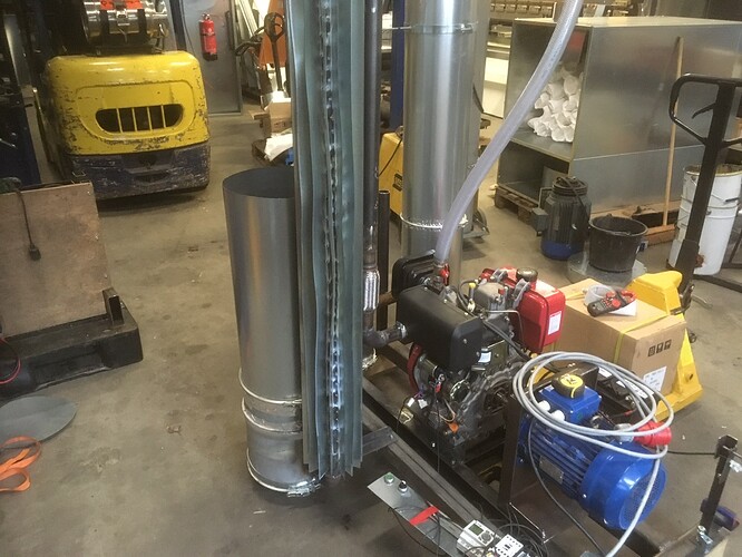

Fixed a exhaust cooling tube with fins but still to hot into the exhaust filter and trying to ignite the charcoal granulate there.
Even I cant find the exhaust cooler on my own picture. The one that finds it, wins a bucket with wallnuts.

Your exhaust cooler? I cannot decide. The black painted muffler box with three across the top; and two side shown shiny bolts/screws? Close coupled. Good.
Or the tall vertical column behind your flex jointed vertical exiting exhaust pipe? Would seem too far distanced.
Or the open topped stainless steel cylinder? It; like the green nozzle fuel can, seems not on the engine/gen-head base.

Joep, because I know that you are a good master, I am sure that you have replaced the existing muffler with a heat exchanger, so you also partially cool the engine itself, …
Here is a better picture. Started from stock muffler
From there up and down to the exhaust filter. Later added fins, helped a little.
Because the muffler is removed and less restriction?

The device will be outside in a closed isolated room, and the exhaust gases will be routed through a large car muffler
