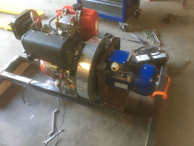

Joep, today I looked at a similar engine to the one you have on the generator.
The speed regulator is made outside with springs and levers, and below is the M 10 screw, which limits the movement of the lever for the amount of fuel injection, it is very easy and convenient to do this.

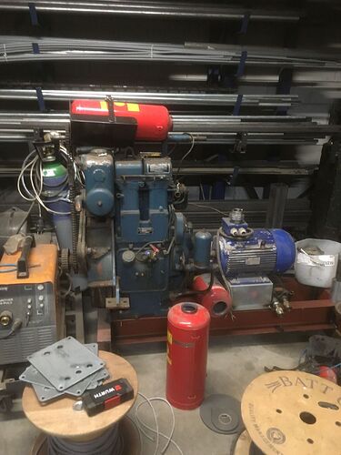

Yes, compression ratio drives me to diesel. Only driving is electric at the moment, to complex to build a gasifier in my Vito. Already to little space. So driving characteritics you wont receive from me. The little woodgas I fed the clone made me happy, it sounded a lot less metalic. I have to go out for the dog and finish my work for tonight. I wil make a quick pic of the Lister. A beauty and screaming to wake up.
Simple engine build to last. Electric motor is direct coupled. Lister is rated 30 hp-1800rpm. KISS.
Watercooled. No idea if the engine is ok or not, didn’t try yet. Started collecting fire extinguishers.

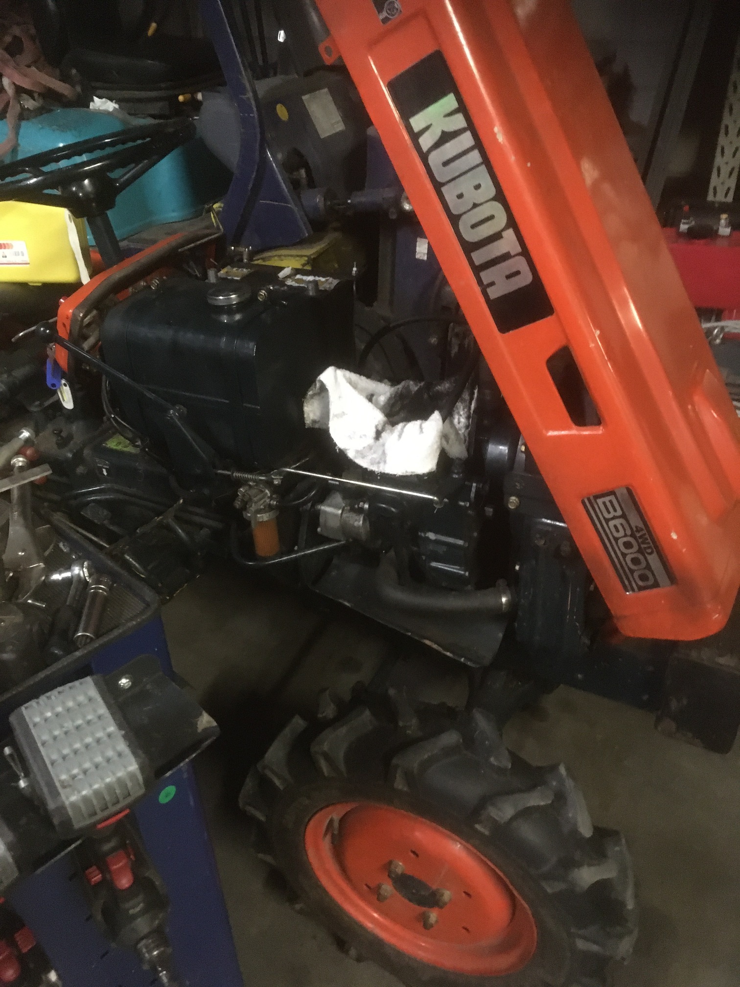

Ha! Maybe there is a chance to show some . Gasket got blown of the Kubota. This one might be converted. The flail mower is a little to big for this little devil. On top of that a bearing god bad, this was to much. He needs more weight on the nose anyway. He can’t loose any power with the big mower behind it. Ha, now the big thing is to find some time. Three installations in the shop waiting to be delivered , when ? Last week please. Hmm, no plc’s, no steel… Next month…hmm money money, hobby hobby
Ok. Kubota is fixed again, but it is indirect injected. Useless to try to woodgas it?

Joep, just to mention, the limiting screw has a spring dowel in the middle, which is not the best, you can easily replace it with a regular screw.
Fuel injection into the vortex chamber has many advantages over direct injection, the nozzle has only one jet, the large opening allows the use of a variety of fuels such as frying oil, waste engine oil, … but we must admit that such engines are due to larger combustion chamber areas a little less efficient, but on wood gas they would definitely work well.
I don’t see how IDI would hurt it running on woodgas. The diesel would be mixed well with the woodgas.
My only question would be do you leave the air intake wide open as a typical diesel works and instead have a throttle for the woodgas line? Or throttle the fresh air with woodgas wide open?
I know in the old diesel trucks the emergency shutoff covers the air intake to suffocate the engine.
I read it somewhere, I dont know why. Yanmar ran fine. Air was a little restricted first time. Now all open and a little woodgas. All new to me and trying to get the feeling. Looks good so far. Main problem was no shaking of the gasifier and ran empty in the middle. Extra reason to try the next one on the Kubota. If there is any decrease in power, I cant cut the grass. So good test for powerloss on woodgas

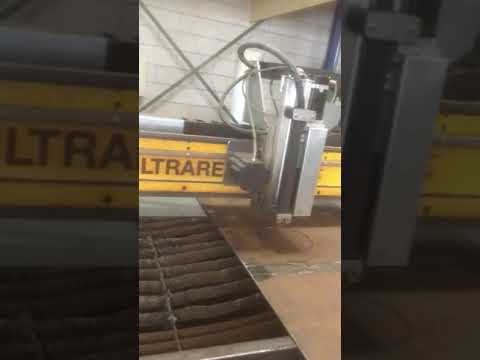

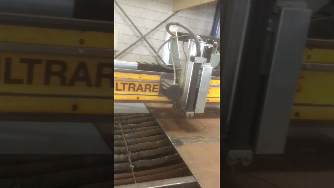

Everyday I am surprised that this all works. 3d drawing, unfold, postprocess and cut. Childsplay. Only the child cannot design. Bold pattern for motor wrong and forgot to offset the axis. Time for some playing outside now.
Scrap plate and a 3 kW motor that came from an installation. Just wait and material is coming to you, only patience.

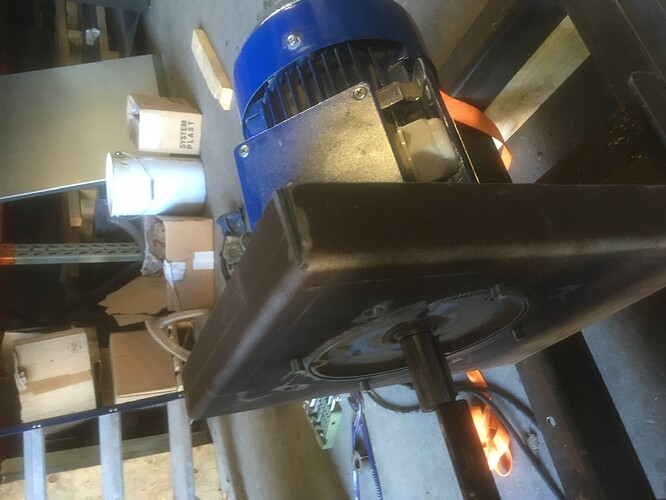

Couldnt leave it like this. Bad feeling to start the weekend. As a gift I took an old ventilator. Put some pipes around and pour concrete in it, so it can act as a flywheel. How long should that dry? I dont like it to explode.
I wonder how well a calcium filled flywheel would work!
