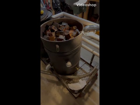

Another video from Todd Reuschel was just posted.
I wish he would turn the camera sideways but he shared a little more information on his gasifier.
