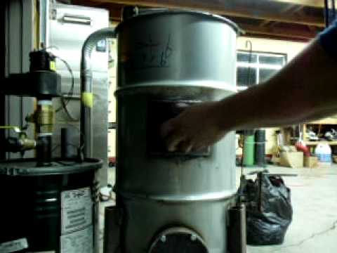

Here’s another only seen on youtube small engine woodgasfier system for Grid-out; no-Grid.
The Garringer Gasifier:
Then for the woodgased generator power proving here:
“Ideal”? “Perfect”? “Ultimate”? Nope. No. Doesn’t matter. It was effective to turn scrap and found woods into electrical power.
11 years ago.
You’ll see no comments from me on his videos. CC enable and listen/read his presentations.
11 years ago, I had nothing to contribute to him. He was teaching me.
Use a powerful variable speed purpose built true vacuum blower.
Use a command activated grate.
On other videos now down he has I reacll three diffnet capacity systems. Showed that his system cores were actually round. The square outer housing were? for? Never asked. Very impolite to ask a commercial selling guy his design features. I never bought one. I should have.
Lawrence Garringer got short shrift on the Forums because he never joined.
So was overlooked. His narrow focus on Grid-Down and Off-Grid folks is explained in his presentations. Good enough back then. Good enough today.

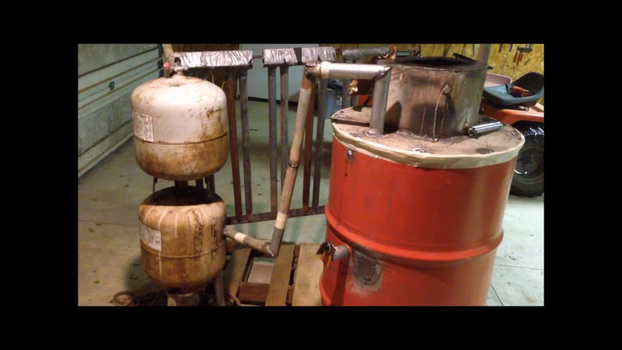

Here’s one youtuber from 9-10 years ago who did self-learn operating. And obviously can weld well. Joshua Burks. Running his highly modified small FEMA on Douglas Fir wood chips:
And earlier video of him electrical generator running (fuel is wood pellets):
And then him showing a from stone cold gasifier starting up. Note is blackened hands. Note he had developed a whole pre-starting sequence of rodding down in two places, grate shaking, etc.:
He had 9-11 other videos step by step developing and building his gasifer and trialing it.
Why has he done nothing more since?
He had achieved what he wanted. A workable system for him and his family as a powering back up.
Everything, woodgas-for-power; does not have to be a never ending, year after year, big-damn-deal.

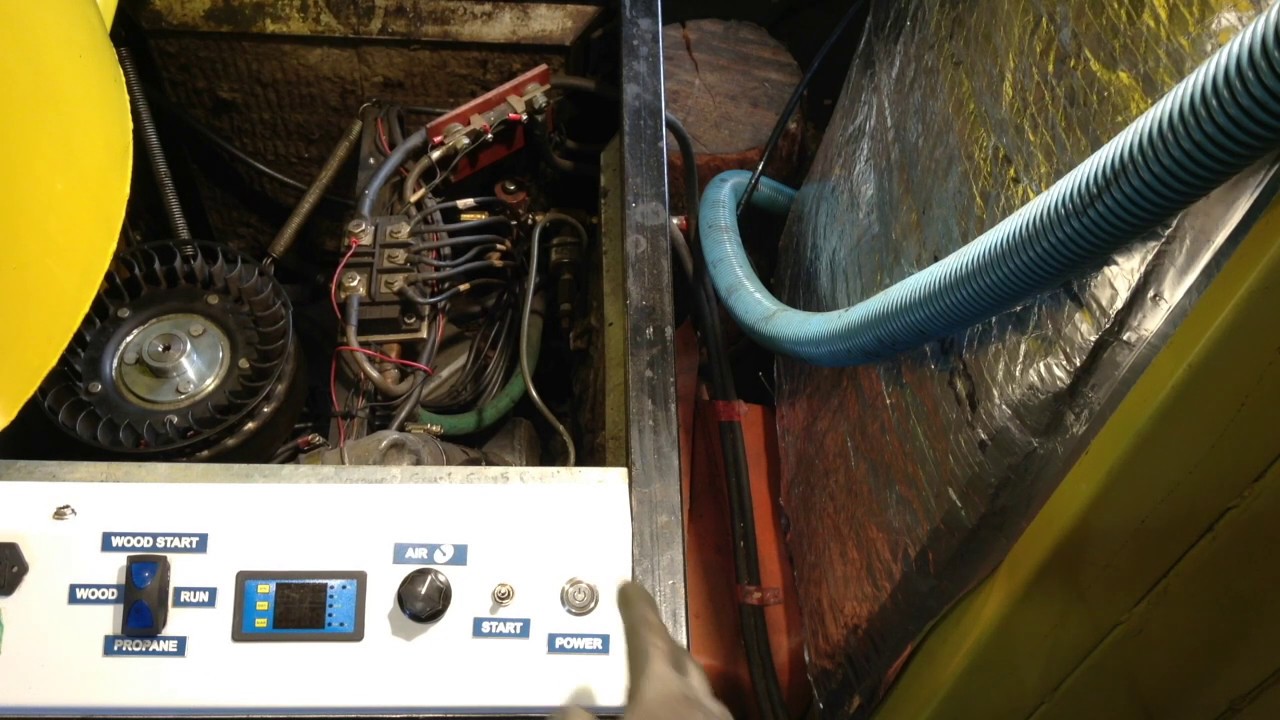

I was watching Marcus Norman YouTube serial episodes build videos he is posting up on V-10 WK Build-up on the Premium side . . . then this video popped up as y.t. recommended:
So is his system claims possibly True? Or Not Possible? (Not true)
Read the commentors below carefully and expand out for his reply’s.
Three of the commentors I recognize as experienced woodgasfier guys.
I know what has them and me skeptical is his no-tars too clean hopper cover. Not quite enought heat rainbowing on his thick SS hearth core.
But . . . his claimed produced number mostly hold up IMHO.
His ME-1016 mounted above his Kohler V-Twin is searchable as a 1000-3000 watt 12-36VAC PM magnet three phase Hydro generator,
So his CHP is high on made farmed out heat for waters,domestic and space. And with electrical as a secondary.
I want to say True. But maybe I am allured by the thick stainless and the Kohler V-Twin. Him answering using that V-twin directed force flow for heating recovery too. Great. Smart.
He answers that from the usage of commercial wood pellets he did switch to chipped wood fuels. Too much shut down hopper steam turning the wood pellets to wood mush. Thats true.
Anyhow enjoy and wonder 7 years later where is this system now.
Ha! Three years later he speaks.
And this one Is, CC enabled, for translations.
Engine system starting and running on propane until woodgas system pulled up to good hot clean producing. Yes, yes. Many details steps still in there. Details. And Details.
But hearing that engine loading, producing, power on woodgas; I’d say TRUE.

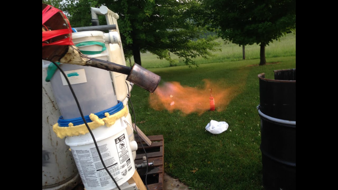

And then there are some small engine youtube gasifier systems where the to-be-learned is not the actual system build; but the Operator use-accumulating experiencing knowledge.
Here is TontoBob’s Part 6 developmental video titled “How Not to Build a Wood Gasifier - Part 6 (Problems)”
Ignore his FEMA beginning and his too much hodge-podge-ing. Listen to his self-analysis correctly about his problems at that stage. Look inside and see the tar goos. He seriously did run this trying many times, in many ways.
Save your time/attention for the next video of his I’ll post up, Episode 11
Hey! Finally, a decent power flare and a clip showing unloaded engine running.
The gold in this one is his ending 11 points of self-analysis failures causes. What he’d do better “next” time. Then says he will be moving on to other things. Or maybe not.
These are all correct, hard learned steps too. Steps, most all of us have had to overcome.
He misses in my opinion two of his struggling faults:
  1. This is just an interesting project to him. One of many in his interests range. Not actual NEEDS driven then that is where too many good enough for the cameras takes place.
  2. He severely limits himself to experiences to just the youtube stunt men woodgasing. And he Only document refers to the “free” FEMA Gov’Mint publication.
Shows the real value of the DOW in live Operators recorded experiences; and the accumulated DOW publications Library.
Shame to see a fellow insisting on not just building with one hand behind his back. But with both hands stuffed into his rear pants pockets.
