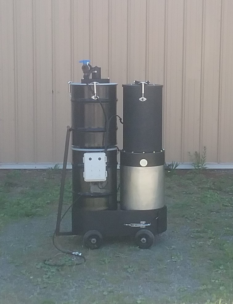

So got up today well rested, got to the shop and off loaded. Once I had the gasser and gen back online right back to work. I put together the Evolution Mini SS I had at the show and am now test running.
Your wood pellots must have been wet or you could use more mini cyclone tube too have dryer fuel, have you tryed useing ceramic in the burn tube as insulater.? Good luck with the new unit, looks Good and rolls around nice.
What I did today was backed the grate agitator down and it ran back to normal. I ended up needing to revert back later. I have a feeling on this machine I may need to use a temp probe to drive the grate actuator.
I think either a hopper heater or hopper cooler would help with the excess moister per pound of wood.all i have at this time is hopper heater/ceramic blanket, hay filter,and seems too maintain a fairly consistant low idle though at times i need a hopper gas cooler too reduce the excess moisture. As you know the wood moisture is hard too keep at low enough percentage, for easy idle type clean running fuel.and should be easy too incorperate at your expert level of fab work once the jigs fixtures are made.BBB.HWWT. FUN BUILDING best you can.
