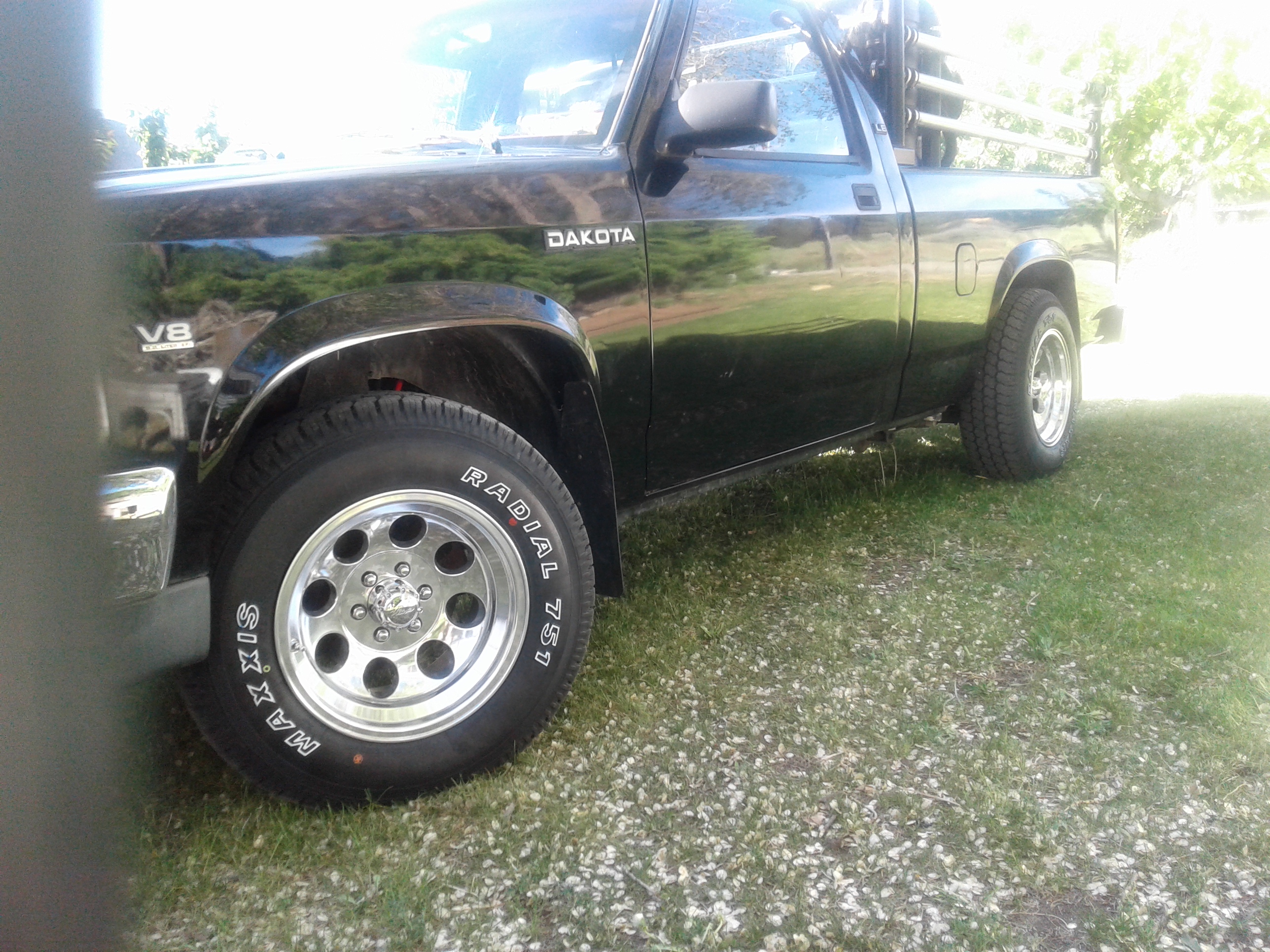

I put some new tires on day. @Wayne, your old land speed record tires will go on the Danaâs Subaru Outback.
I wasnât planning on it but I got new wheels too. I was having problems with tires going low on pressure and I wasnât happy with the mushy ride the tires were giving me.
When they went to put new valve stems in they found the problem , lots of corrosion around the valve stems of two of the wheels and where it seals on the rim. I Might be able to clean the wheels up and use them for winter studded tires.
The truck rides a lot better now with the heavier belted side walls.
Changed the oil and checked all the fluids, servicing is done ready to roll down the road.

At the tire store they said it is a common thing they see with valve stems. Two different type of metals. Around the rims it could have been the salt flats sand though. No worries, I now have a extra set of wheels for winter. The deicer they use around here in the winter is hard on aluminum and alloy wheels. At least it not salt.

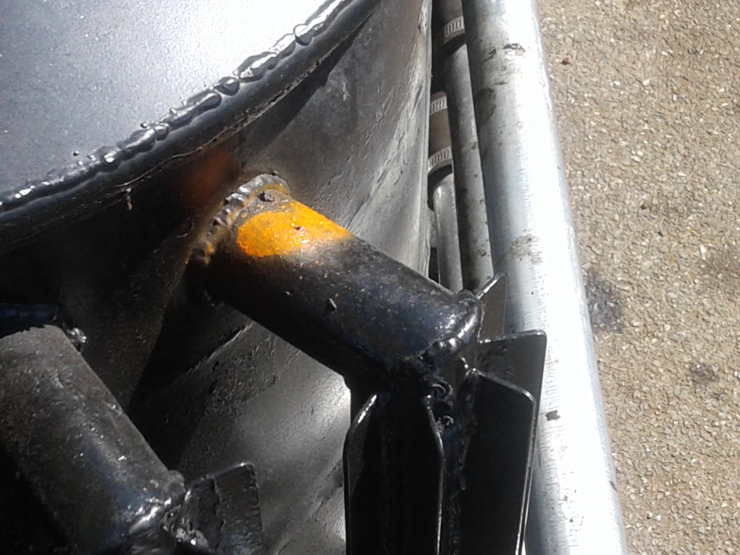

Another pin hole leak in my tubing on the hopper cooling tubes. (Orange dot )
These are the original tubes that @Wayne cut and welded on, good job Wayne. I put the fins on so they would have more cooling surface. They are starting to get pretty thin on the upper part of the tubes. A little black silicone rubber on it and it will be ready for Argos 2018.

It seems the upper portion of the hopper and tubes is the first thing to deteriorate from the acid.
The last couple of hopper I built I made them in two pieces so the top could be changed out with out having to replace the bottom part .
I have heard others having the same problem, so far the upper part of the hopper barrow has enough tar coating I think it is being protected from the acid. I have been leaving it that way. You built the right slope on the gutter and with the heat that is being generated it seems to never clog up just keeps flowing to the condensation/tar tank.
Planning on the next rebuild to have the tube removable and use heavier duty pipe, might just weld new pipe over the old tubing for the connections to the new cooler pipes with fins.
There is no sense replacing things that are not worn out.
Up date I am letting the silicone rubber dry will go for a drive tomorrow.
