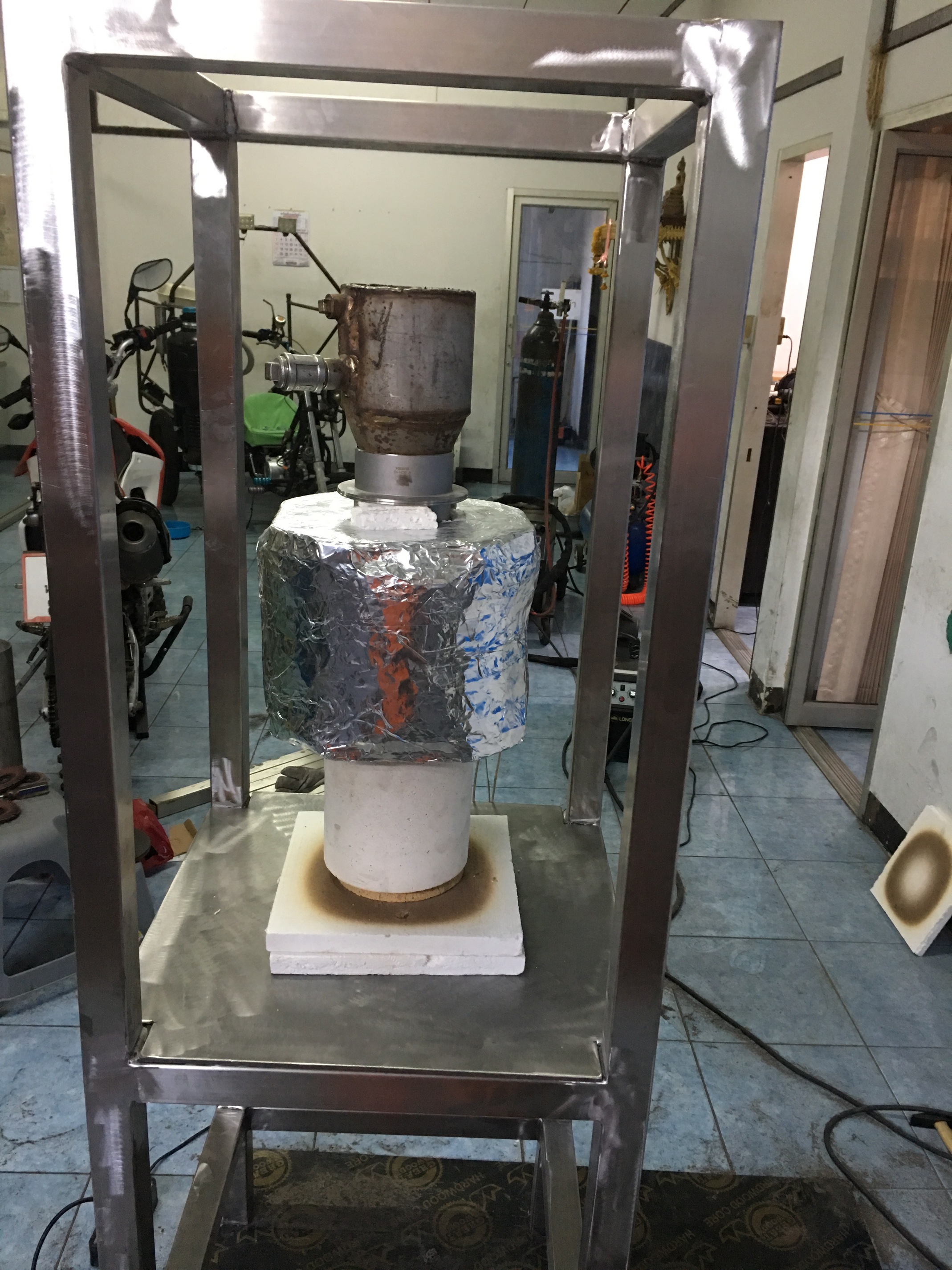

For the purpose as depicted above, i use a 4"by 6" ceramic sleeve, high alumina, loose inserted in the refractory cylinder with the heating coil surrounding the sleeve.
The set is then covered with 2" layers of ceramic blanket.
To make that 2" layer glow on the outside, imagine the temp inside…

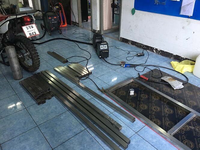

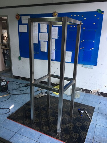

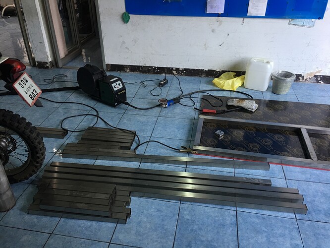

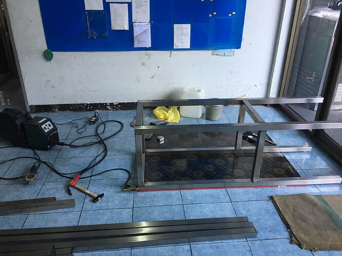

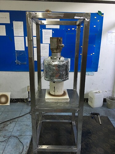

Now i made the test setup with extra layers and a new frame to support the whole set.
I try to study/design/analyze per component/function and then combine the required components/functions into a working set.
Not always succesful ( the pictures i don’t post ofcourse

The rig build is for prototyping gasifier components and yes, there are so many ways how things can be done inside gasifiers.
Each component build and tested always seems to lead me to finding other things to do, to explore other ways how things can be done…
