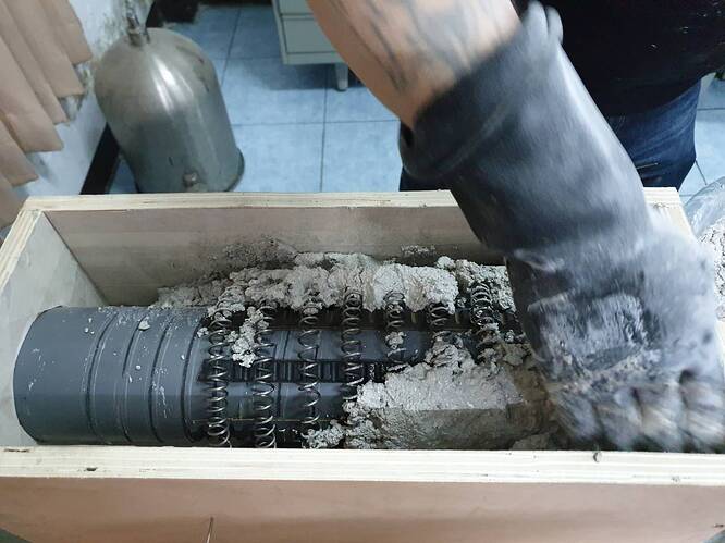

Koen,

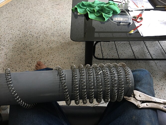

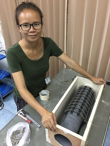

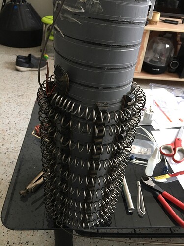

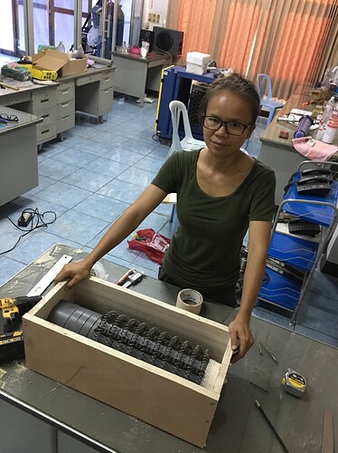

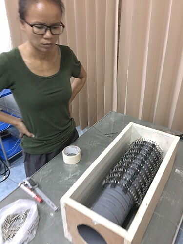

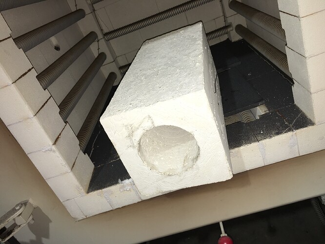

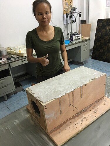

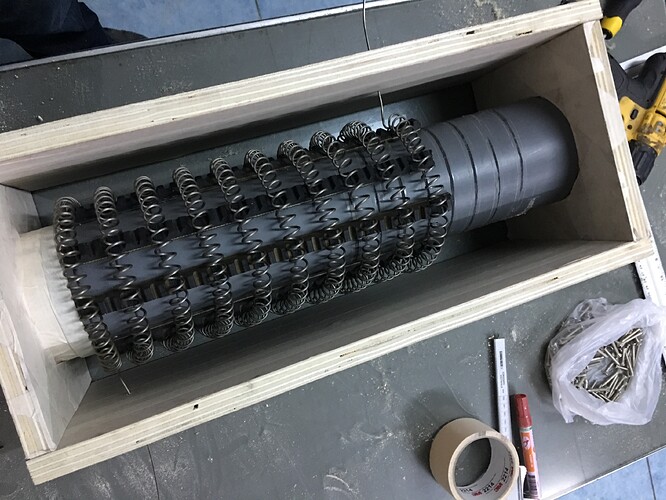

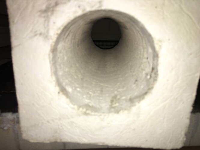

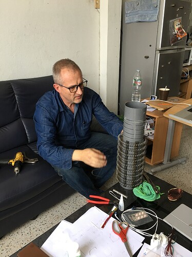

Thanks for posting these pictures. I have a couple questions. First, any idea why the first heating element failed?

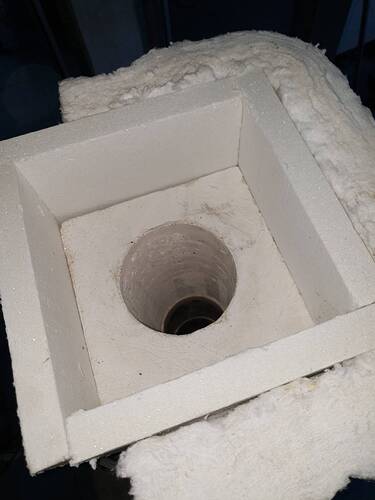

Second, what types of refractory did you use here, Are they insulated (lightweight), or hard? (heavy)? Nice work, by the way, and hope you are feeling better!
I know the ceramic kiln I once had used lightweight cut and shaped refractory bricks with grooves cut in them lengthwise for the bare heating elements.

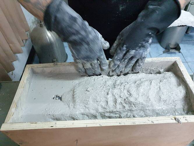

Do the drying stages at the temperature rise. at first, I destroyed all my ceramic pieces.
Hi Mike,
The coil failed because i overdosed the amps in to short time… eager to get results but lack of patience…

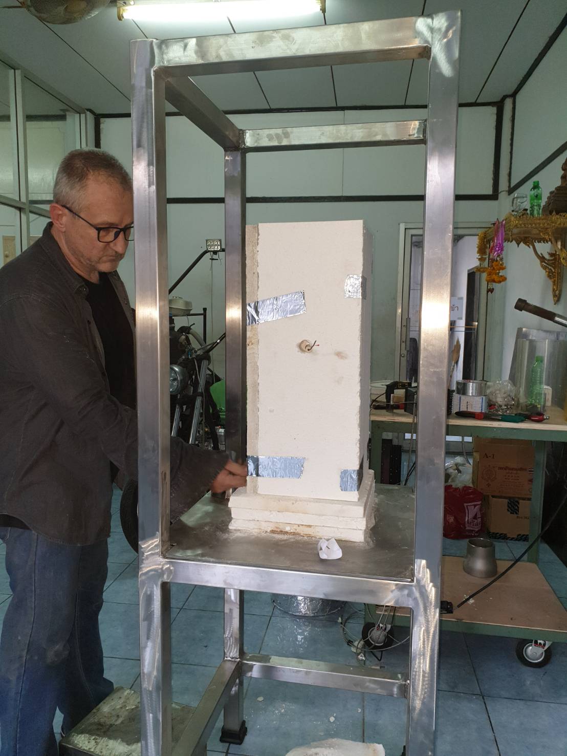

The refractory is Cast 16T, the hard and heavy type, rings as a bell when comes out of the oven when done with patience
This piece will require about 80 hours in the oven with slowly rising and long holding temperature times,

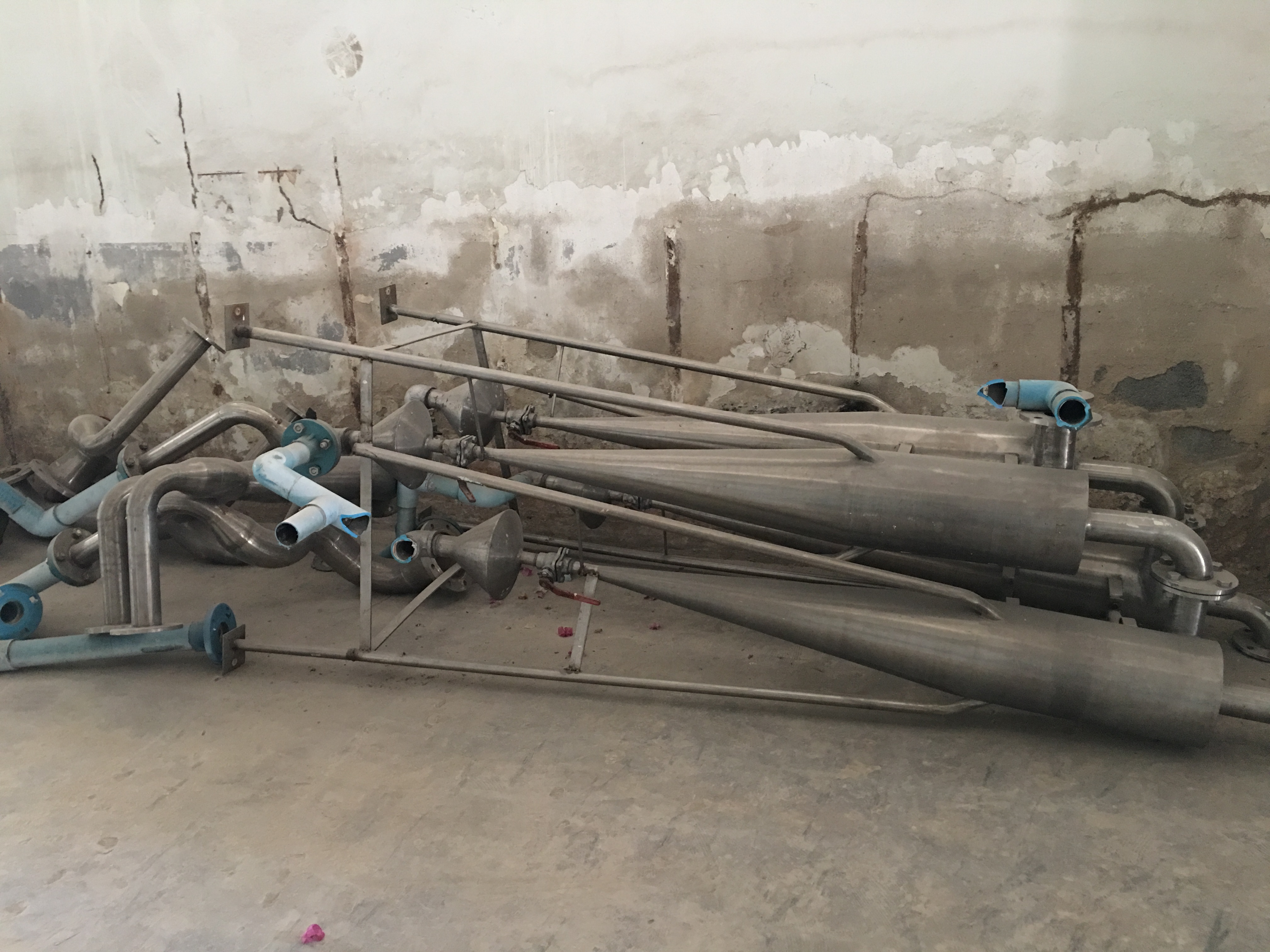

Found some stuff in the scrapyard… they might come in handy… 2,5" pipe and about 60" long and 8" diameter
STUFF? Heck, that’s TREASURE!
Pepe

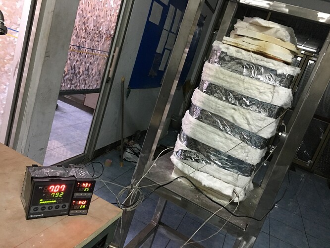

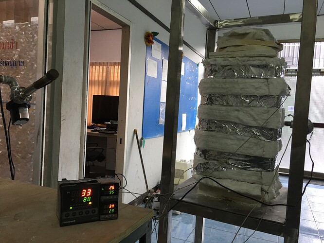

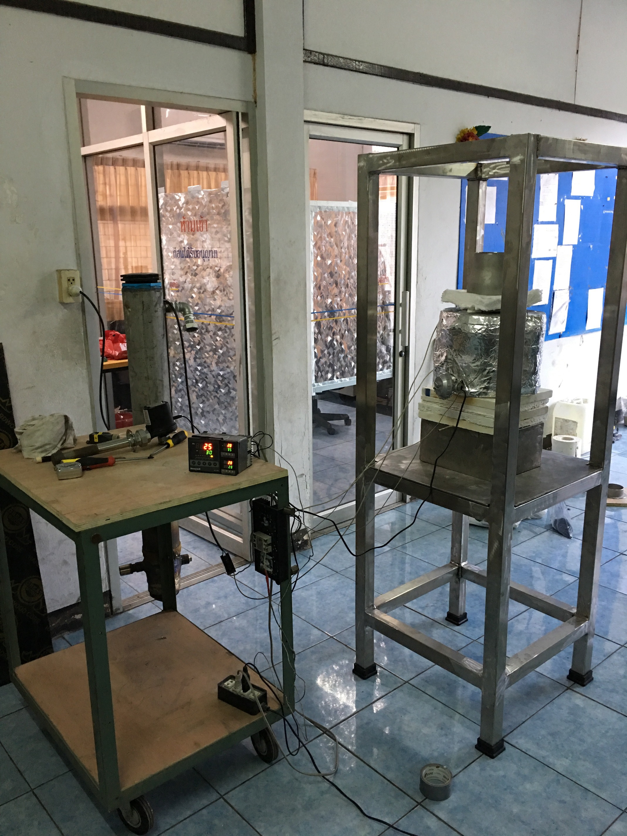

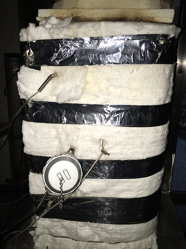

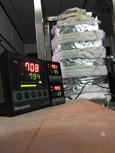

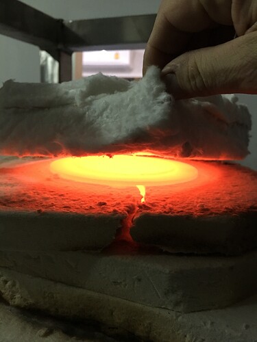

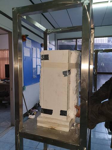

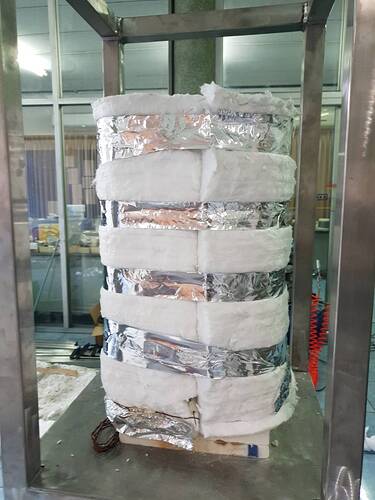

Good too see your still Geting around, how is your new insulated test unit, it looks hot enough too throw a percentage of bambo chunks in too cool flame temps. Or is it running much hotter with the ceramic blanket added and insulated outer, than your all metal units.

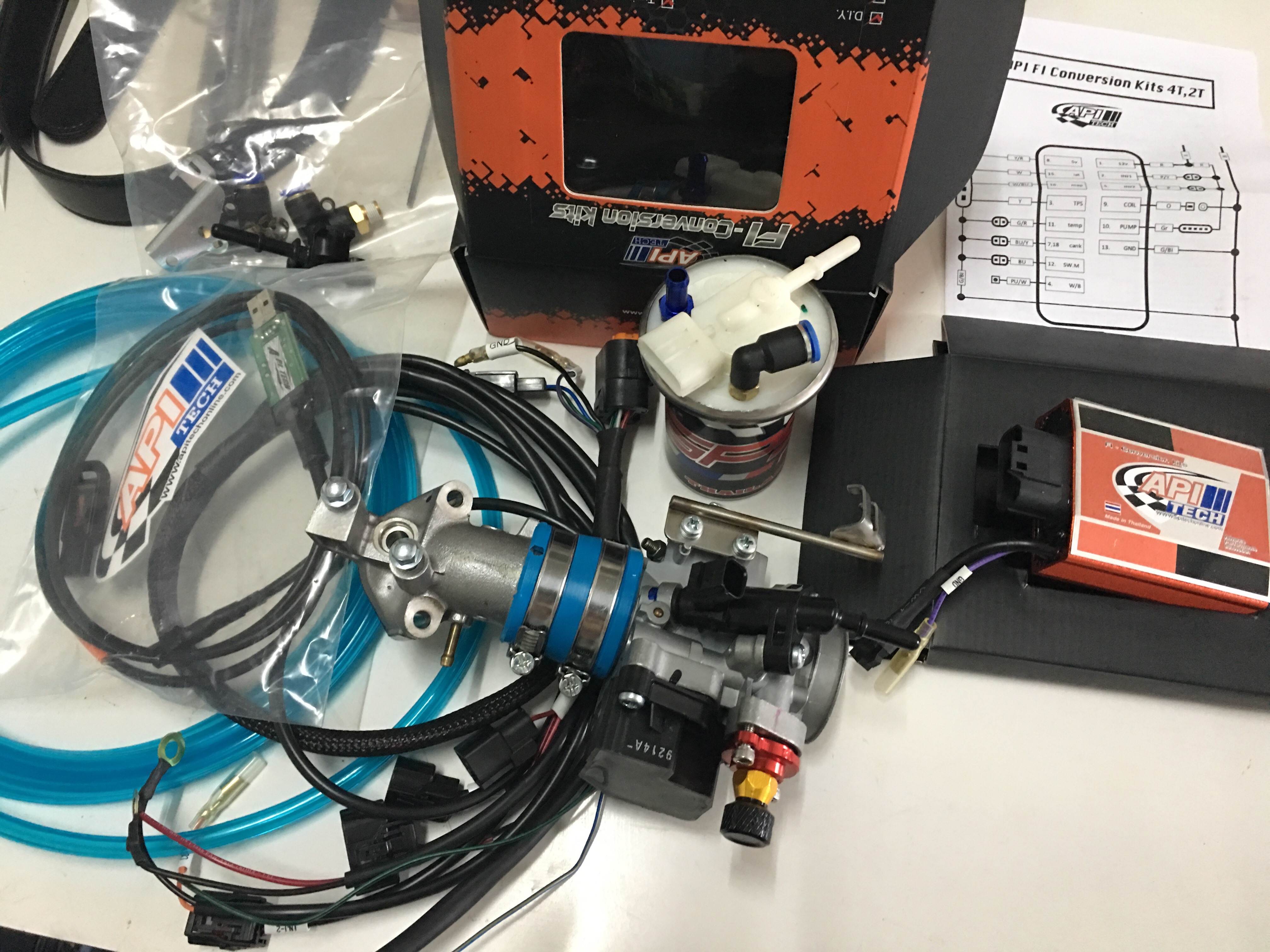

Now toy arrived…
Fuel Injection conversion kit with full programable ECU, dual fuel capable, auto switch over, wideband sensor capable… for 1 cylinder engines…
Injector timing from and quantity controllable from 0 to 100%,
Finally, they decided to listen to my inquiry… ![]()
Lemons please…
Engine size range usability, Please?
Hi Steve,
Full range 1 cylinder engines, i have seen throttlebody size 60 mm available.
ECU can handle 2 injectors
The body in the picture is for my trike, its a 30 mm, with map, IAT and TPS sensor
I will scan the documentation and post it.
This shop has a lot of parts available to modify bikes, as valves, cam, pressure regulators for gasoline etc…
This is great Koen, for the single and double piston engines that run on wood or charcoal gasifiers. Keep us posted on this application and findings on how you will use it. It sounds like the trike is going to be going down the road with better performance in the near future.

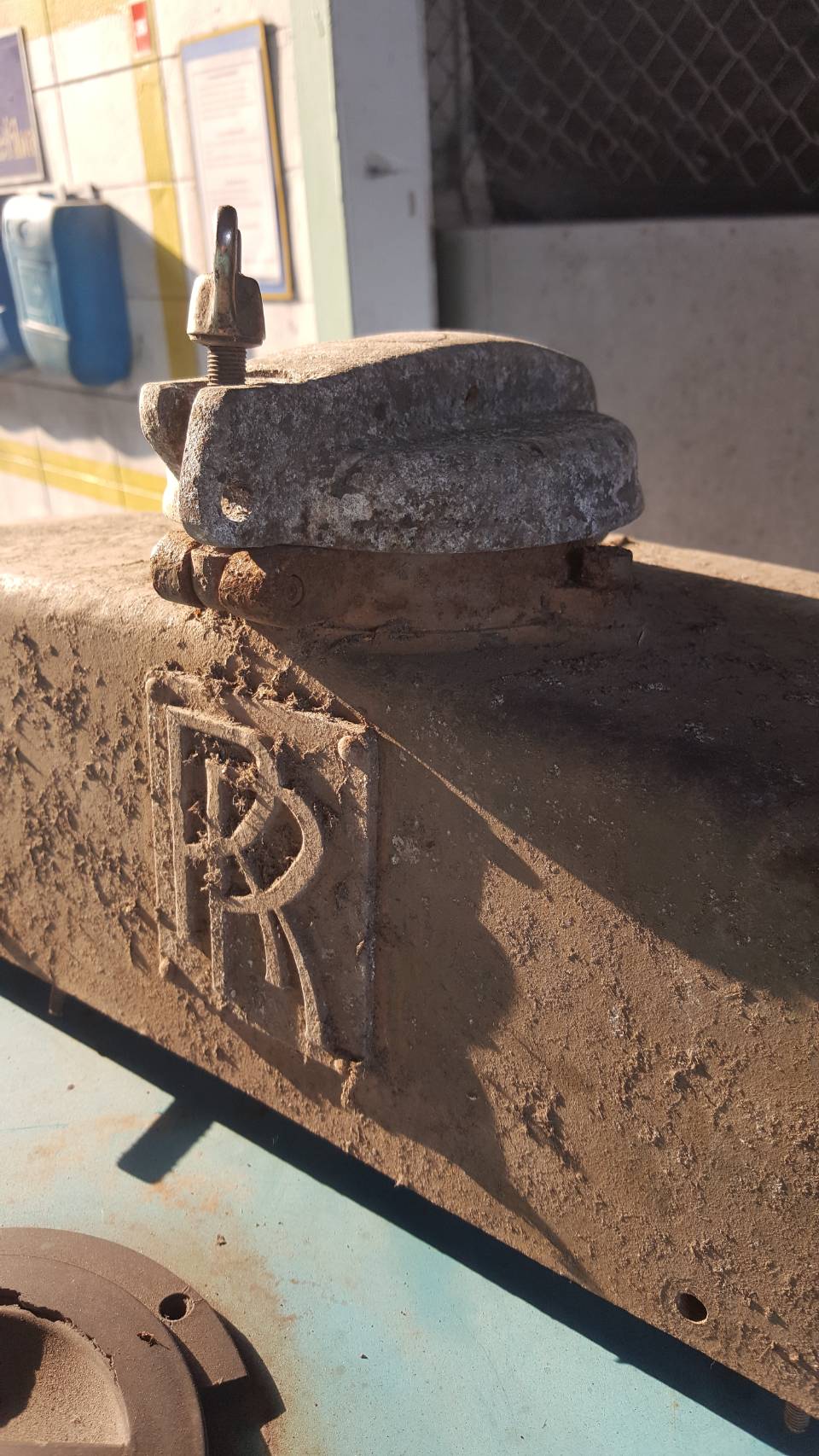

i have to find use for this beauty… This original cover ID is 4"
The set is the top of a generator / radiator… heavy aluminium…
