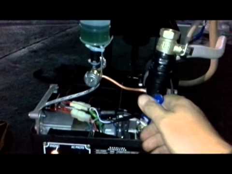

Koen Van Looken, in the video below:
about 35 seconds you are opening a gate valve to show the glowing char inside the reactor. Then you close the gate valve, and adjust the wood gas carb valve to be more open. Why don’t you leave the gate valve open while running the motor?
Also, did you say that you are getting the rated power on woodgas with burning plastic smoke + two stroke oil as the same generator gets on gasoline? (My latest test with a 4 stroke generator-inverter would only load to 50% of continuous rated power on gasoline.) Thanks for the videos. Ray
