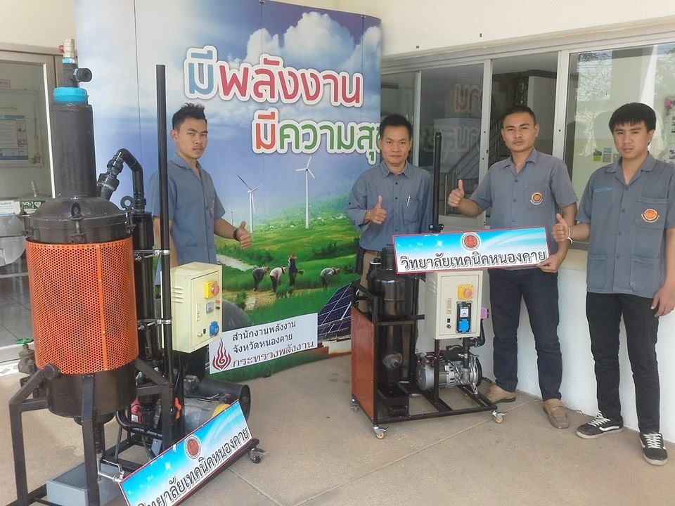

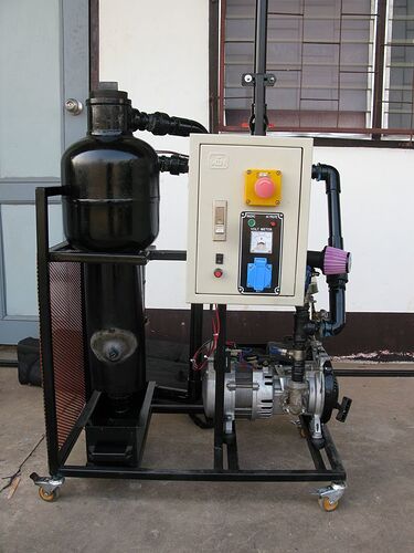

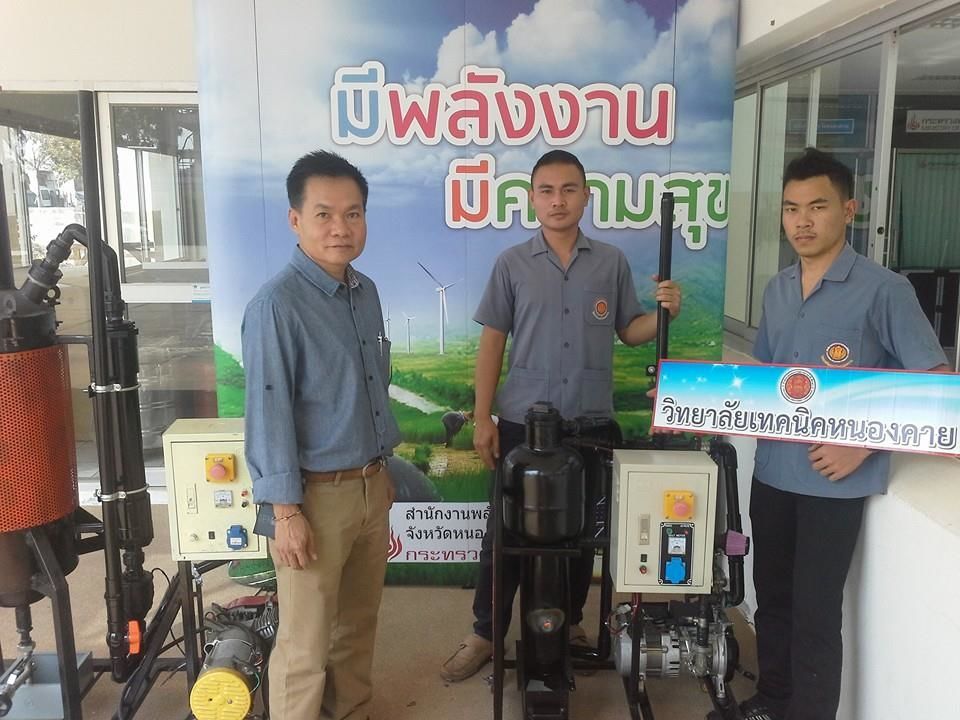

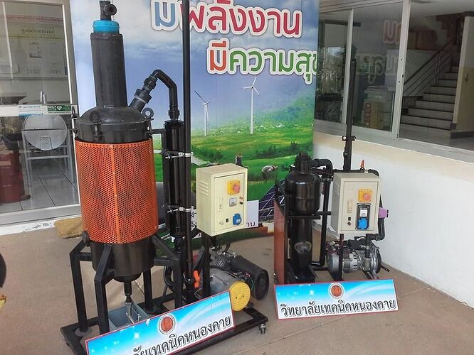

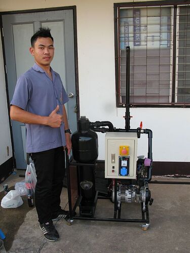

making ready for National Inventors Thailand 2015
@ministry of energy Nong Khai
Sweet 2 stroke
Nice professional looking builds Koen. You teach them good!
Trying to yes
Here the group on the previous awards
