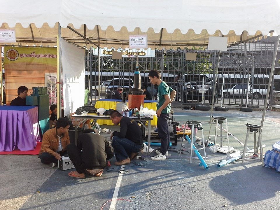

From the 8 projects from the school in the energy innovation contest, regional, 3 made it to the finals: national(Bangkok)
3 with the gasfier…
all live presentations, with working demonstrations
competing in 3 category’s we had 2th for generating energy(genset with gasifier)
second for recycling plastic into energy, (the dual set gasifier/pyrolise)
4th for the trike, presenting in english by the students.(i’ll have to work on his english skills…)

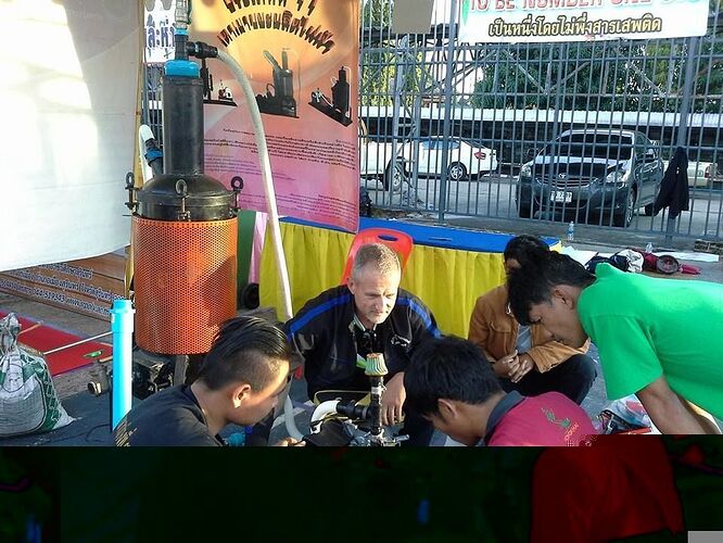

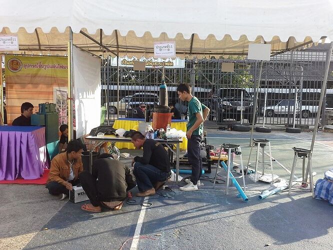

1 to 5 feb, presentation of the 3 projects (1:generating electric, 2:recycling plastic waste into energy with gasyfier/pyrolizing unit, 3:the trike)
in Bangkok energy awards, this by myself with the students
5 to 9 feb, presentation from the 3 projects by the students in the innovation awards. ( also Bangkok )
many things to prepare…

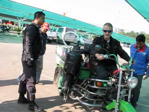

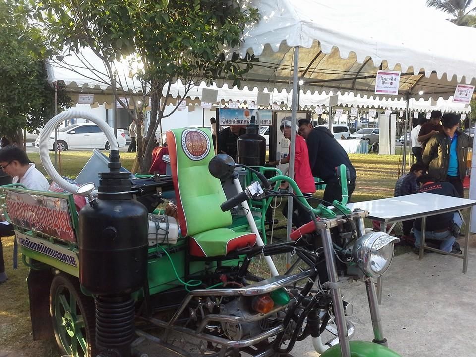

and a lot of fun driving around with the bike , making heads turn…

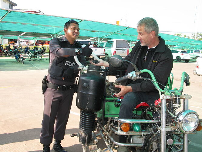

about 35 seconds you are opening a gate valve to show the glowing char inside the reactor. Then you close the gate valve, and adjust the wood gas carb valve to be more open. Why don’t you leave the gate valve open while running the motor?
Also, did you say that you are getting the rated power on woodgas with burning plastic smoke + two stroke oil as the same generator gets on gasoline? (My latest test with a 4 stroke generator-inverter would only load to 50% of continuous rated power on gasoline.) Thanks for the videos. Ray
The gate valve is only for lightning the reactor or playing around with temperature inside the reactor.
The actual intake nozzle is at the bottom from the reactor, where it also gets fed in the plastic fumes
( this is confusing for me, i can not recollect saying something like that)
The plastic fumes , from the pyrolizing unit where mixed with incoming air in the gasifier and subsequently converted into “i don’t know yet gas”
The two stroke oil is dripped in to the intake manifold from the 2 stroke engine (oil lube for the engine)
As i strip the carburators and work on the intake from the gas-mixture, i might obtain a better % then 50% of the rated power.
